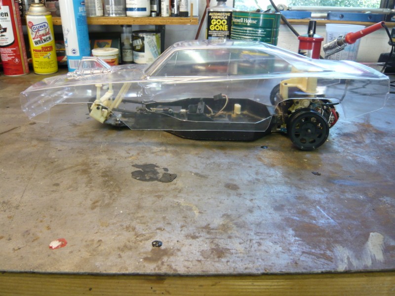

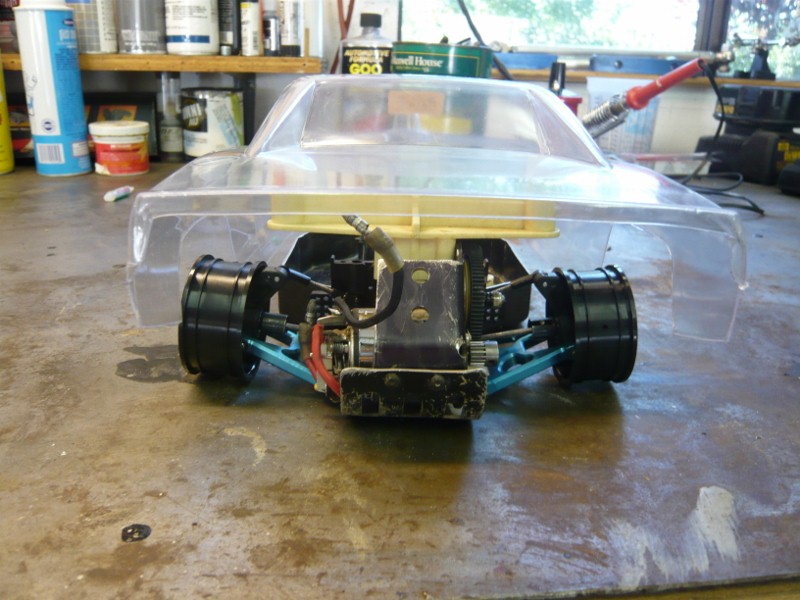

I finally got going on my General Lee build. The idea behind this build was to have a car that could be driven on the dirt.(Just like Bo and Luke). The only 1969 Charger Body that I could find was made by HPI. Its a little long and skinny for the RC10 chassis, so I had to get creative. I'm using an old 10T that I had lying around. The extra wheelbase length was needed to fit the HPI body. I'm using DS front and rear arms. I'm going to custom make some shock towers. So far, finding the right wheels was my biggest challenge. I ended up using some HPI stock car rims that I will eventually paint grey spokes on to replicate the old Vector wheels on the General.

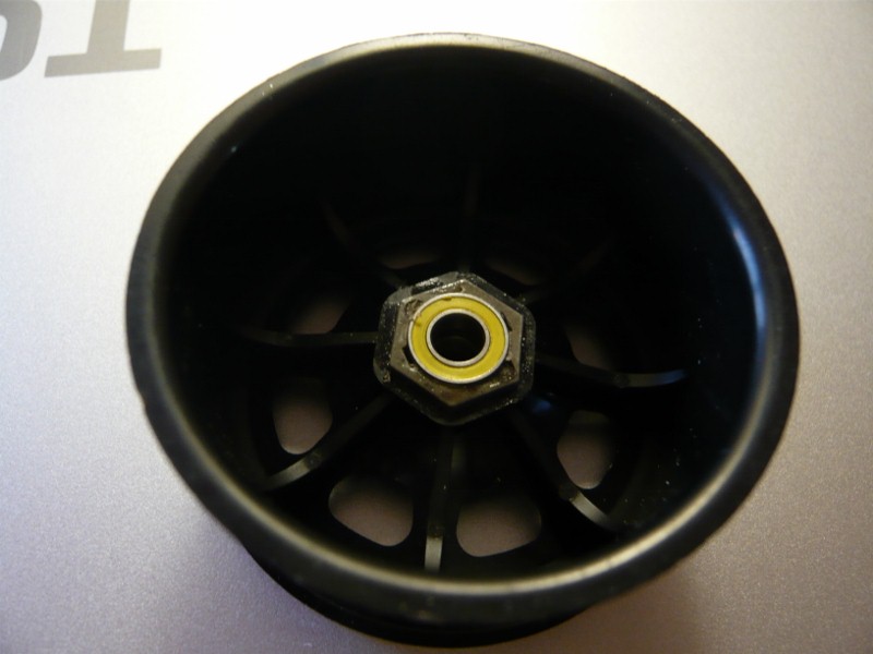

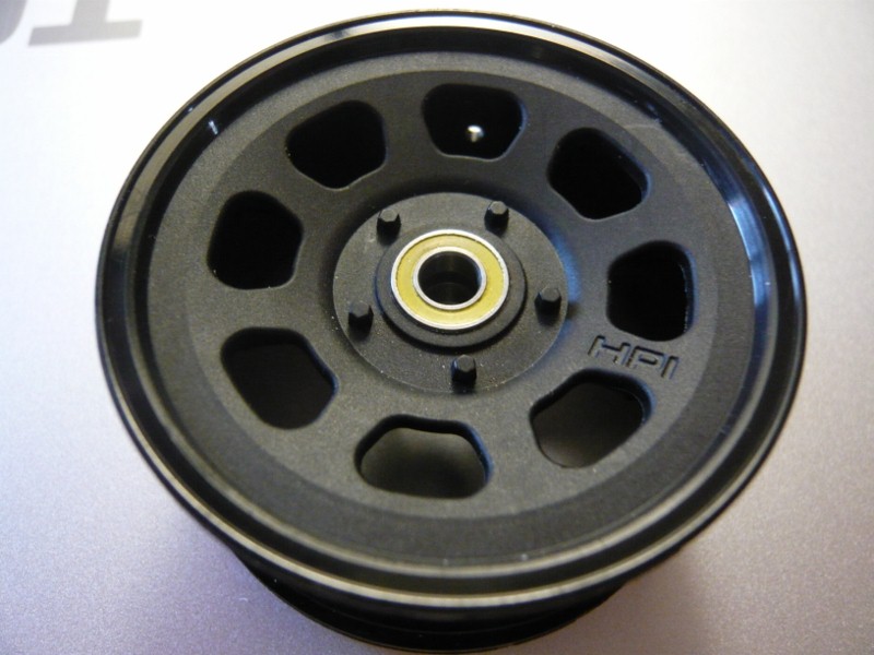

To get the HPI wheels to fit I used the rear hex adapters from my brothers old Traxxas Stampede. I had to ream them out a bit. The fronts were a little bit more involved. Basically I took the same hex adapters and shaved them down about a 1/16/ Then I used appoxy to set them into the wheels. Then I drilled out each side of the wheel so that it would accept a 3/16 x 3/8 bearing.

I've still got to get the front end mocked up and get the body mounted. I'll post more pics when I make more progress.

Mikey,did ya know the traxxas parts to run 12MM fronts. there's a list somewhere here or you can look on my DS builds. JohnnySr

I actually started out with this set up. I was using parts from the Stampede and I didn't like the fit. I'm not sure if I was using the right parts, but I had to do a lot of grinding to the front castor blocks to get them to fit the Associated arms.

I had the same idea for my ds that is laying around waiting for me to get to. I like the idea for the front wheels. I'm not a big fan of the traxxas thing. But you gotta do what you gotta do. Good luck with the build looks good so far.

the traxxas is the cheapest, but you could use a kyosho or losi variation as well. the later model 2wd buggies use a hex up front with a 'live' axle in the hub.

Well I got my front arms in the mail today and found out that they do not mount up to the 10T front bulkhead. I thought that the DS used the same one. Back to the drawing board. :(
