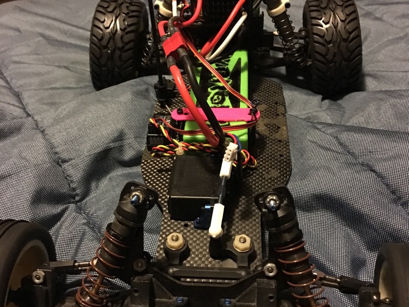

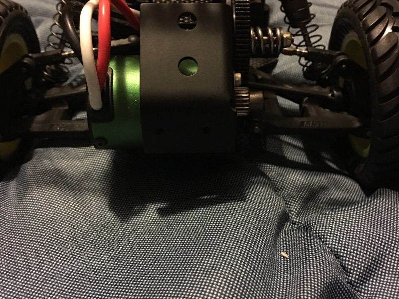

Pics of the car
B4 style slipper, with GT hubs.
Brushless castle 5700kv 4 pole motor
