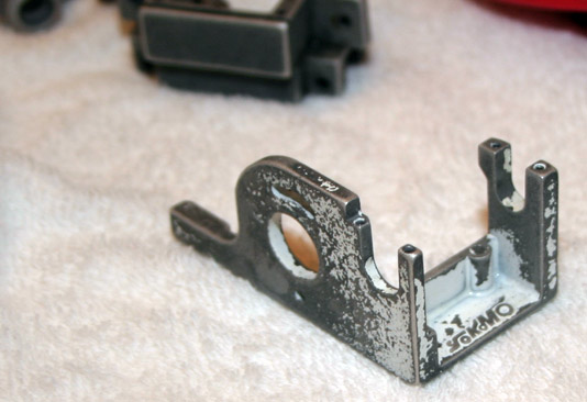

Hi everyone,
I'm new to the forum and have read many many posts. Very good stuff!! I just got a pair of YZ10's (the '88 - '89 ones) and have torn them apart and of course the bulkheads, hubs, and motormount are in pretty rough shape. I've read tons of posts and keep seeing that bead blasting is the way to go but what is the next best alternative? Bead blasting sounds awesome but I don't have a contact for that, couldn't find anything at first glance through google, and probably won't go on that path anyway. So, what is everyone's opinion on the next best option for cleaning up the metal bits on an old Yok? Dremel with wire wheel? soak in some chemical?
Also, I read that it is wise to clear coat the magnesium after whatever finishing technique is used. What paint should be used? Is there a specific brand or type?

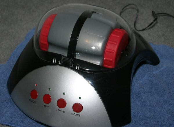

I just got back from the toy store where I bought a rock tumbler. I'm just doing some testing with that now so I'll have some results and pictures soon of the wire brush method and the rock tumbler method.

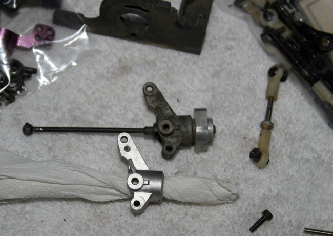

Ok, I just got finished my first test with the Dremel Copper wire wheels and the Testors Paint. I'm very impressed with the results. After the wire wheel the hubs were very polished which is fine but not very original looking. Once I hit some of the dullcoat clear paint they look amazing and they are protected from future corrosion. Here is the before and after pic. I actually painted the hub while holding it with the paper towel inside - this will also prevent clear-coat from building up inside and altering the bearing tolerances.
The actual paint I used was Testors Spray Enamel Dullcote Part # 1260. Still more testing to come with the rock tumbler.

Re: Magnesium Restore for dummies.....
I've got some early results on the rock tumbler. I threw in a knuckle, bulkhead, and motormount (the mount was completely painted white) into the rock tumbler 4 hours ago. In the pics you'll see how much of the paint has already come off. The knuckle comparison is pretty crazy too. I'm using the second most course sand (out of 4 choices). I'm going to leave it running over night and see what everything looks like in the morning. The instructions about polishing rocks talks about doing it for many days and even more than a week but I'm sure rocks are much harder than magnesium so less than 24 hours is looking like it will do the job. So far I'm pretty happy with this $25 tumbler. I have a feeling by morning this stuff will be looking pretty sweet.

I'd be very careful with that tumbler. the motor mount looks like the corners and edges are already polished down significantly. I would be concerned with how bearings and bulkhead caps fit after the treatment.
glass beading is still probably the best process, followed by the wire wheel treatment you have already tried and had success with.

Yes, I was going to point that out..... I'd be worried to go much on much further.jwscab wrote:I'd be very careful with that tumbler. the motor mount looks like the corners and edges are already polished down significantly. I would be concerned with how bearings and bulkhead caps fit after the treatment.
I've got some mag parts that I want cleaning up too - think i'm going to hunt down a local bead blasting company, although that mini blasting kit that you posted a link to, looks interesting

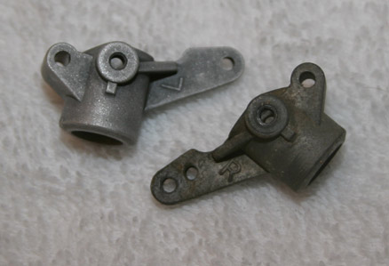

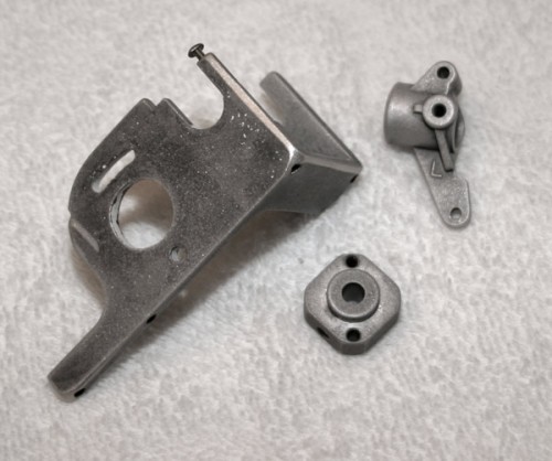

Yes, I totally agree. I just took the parts out from the tumbler after the overnight session and many of the edges are worn a lot. I saw that happening last night and put a screw in one of the holes to try to reduce the motormount's edge from rubbing in the unit but the screw didn't help too much. The tumbler seems decent for things like hubs but it wears away the square edges and also doesn't get into the little corners (which is the hard part and would have to be done by hand anyway). These parts were test parts and served their purpose but it looks like the rock tumbler isn't the way to go.jwscab wrote:I'd be very careful with that tumbler. the motor mount looks like the corners and edges are already polished down significantly. I would be concerned with how bearings and bulkhead caps fit after the treatment.
I'm going to do one full set of magnesium parts with the brass wire wheel and dullcoat method and once I get my cheap bead blaster I'll do more testing with that on another set of magnesium. Below are the pics from the rock tumbler after 13 hours with medium/course sand. They look much better than before but way too much wear so the Tumbler is getting the axe!
