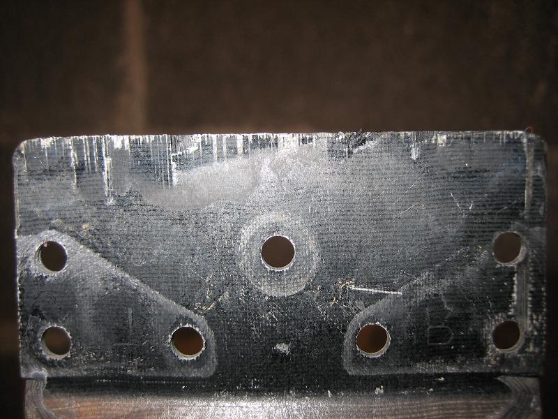

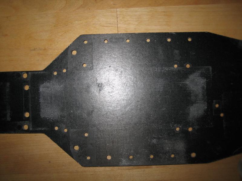

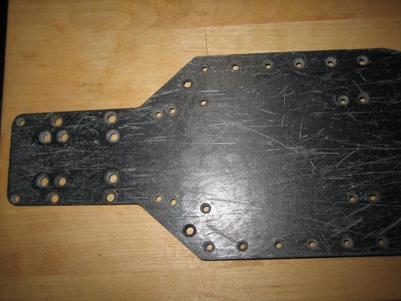

here are some pics of what I am working with. My game plan is to use a thin epoxy, lay down some polyethylene plastic on a mirror(flat piece of glass), coat the bottom(or top) of the chassis, and then apply some weight to press the chassis flat. a few minutes later I should be able to see if I have ALOT of sanding to do, or just a little bit of cleanup.
the nose will get a thin CA treatment as the layers are clamped tightly together with some bar stock and clamps.

Wow, look at that! The R & L are ground into that chassis from use
Perfect test bed for sure!!!

that has "worlds" front end written all over it......... if it were mine.

ya, this was my most used chassis for my RC10 (this is the incarnation I drove the most), and is a perfect example of the word 'fretting', hahhah.....
the nose was just reglued, I'll give it an hour or so and see what it looks like.
Scr8p....that is an interesting idea.....I may just trim the very edge off though....we shall see how it turns out.
