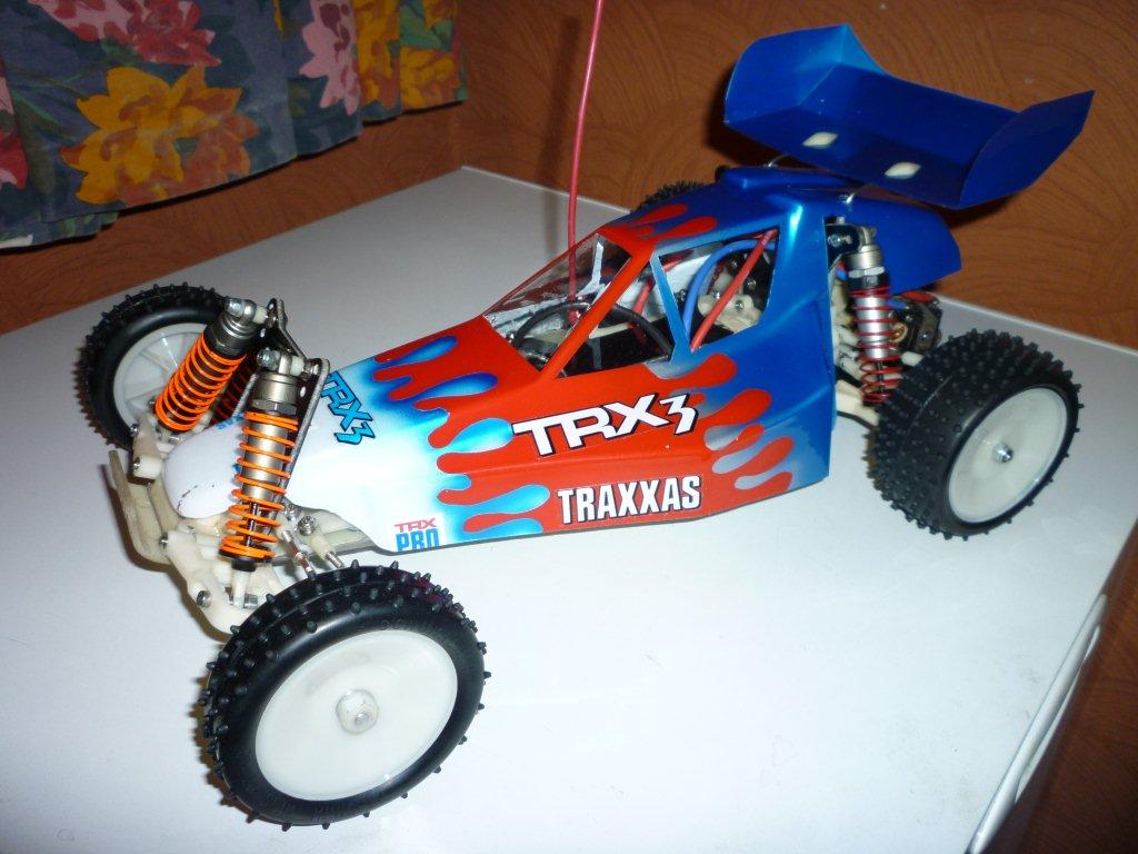

I just about finished mine. It has a couple personal touches you may like... I'lll try to post pics up tomorrow.

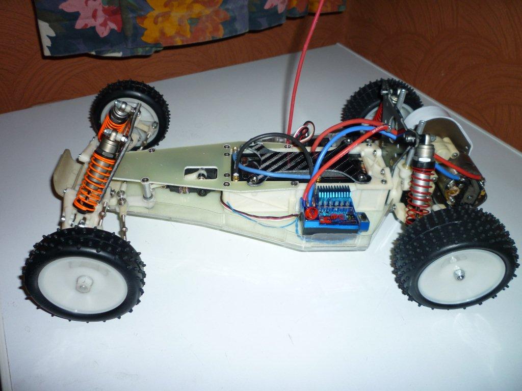

Why the large battery plate? Was it meant to put the esc on top?
I hope you can share set-up tricks to make it jump well: I 'm on the waitlist for a big event with lots of jumps. Those didn't pose a problem with the mid-motered YZ10 and midmotered 2WD I drove in the past 2 events, but the rearmotered tcp worries me. I was never able to get my ultimas to fly level

Re: TRX3 number two
Yes looking at the battery strap it is a bit on the large size,
its holding down a saddle pack Lipo, just didn,t want them
moving around.
There,s no large jumps on the tracks I run on, but as with
most rear motored cars it,s down to throttle control in the
air, which I,m not very good at
Totally agree with the YZ10.
I,ve fitted a hydradrive to the car, just interested to see how
it stacks up with the latest horsepower thats,s available

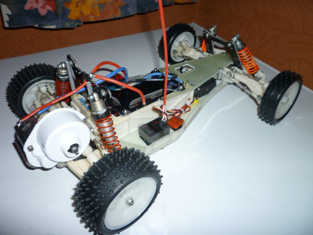

looks very nice, is that a ics 7.1/8.1? so its got hydra drive has it! what top shaft have you used?
- CobraKen
- Posts: 37
- Joined: Mon Jun 22, 2009 12:50 pm
- Location: Barwell England
Re: TRX3 number two
Well spotted,marui hunter 73 it,s a ics 7.1
When LRP built these they got them spot on, I just like the "feel" very progressive
I,ve got this type in all my cars
Home made topshaft and gearcover

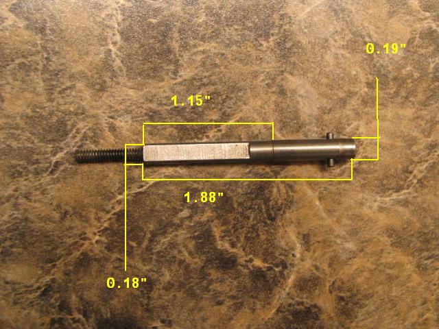

This is nice, I just had picked up a TRX-1 of the EB, and it too had a Hydra Drive installed - Marui I can send you some dimensions if you like.marui hunter 73 wrote:looks very nice, is that a ics 7.1/8.1? so its got hydra drive has it! what top shaft have you used?

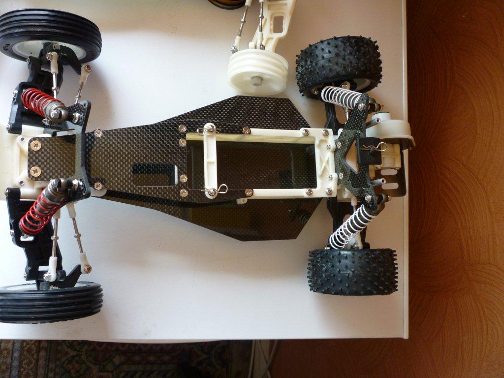

Great build, did you get any pieces from Fiberlyte?

I measured the shaft that came out of the tranny in my Traxxas Buggy (with Hydra drive.marui hunter 73 wrote:looks very nice, is that a ics 7.1/8.1? so its got hydra drive has it! what top shaft have you used?
I have no reference to what the Actual Losi provided ones are dimension wise.

My shelf car has all the Fibre-Lyte parts on it,
I did ask them not to cut the battery slots in the chassis
gives it a smooth/cleaner look

The Fiberlyte pieces do look great, I had ordered some in the Twill patern. Is that a stock gear cover you used with the Hydra drive?
