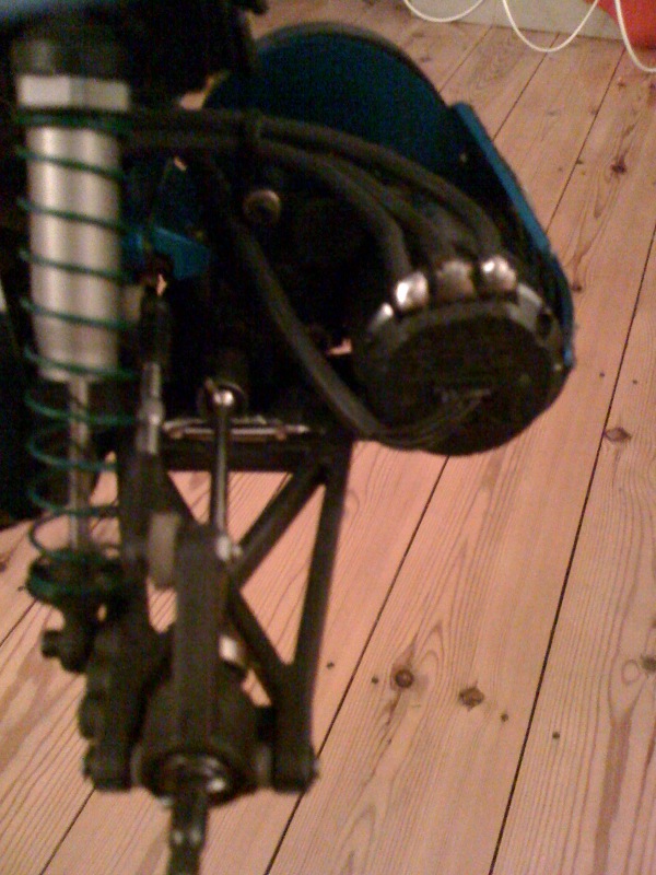

Im using b2 rear arms and hubs with mip ujs but they are just inside the edge of the outdrive, so my shocks have to be limited so the wishbones cant go any lower than level as if more and they pop out. The B3 rear wishbones and hubs are different and ive got a used set so know the difference. I will investigate the B44 ujs, as thats one issue sorted if the right length.

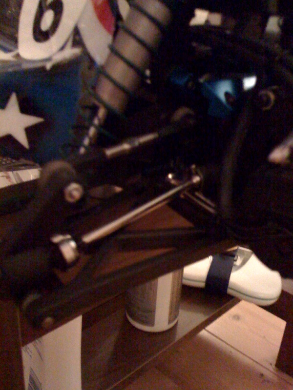

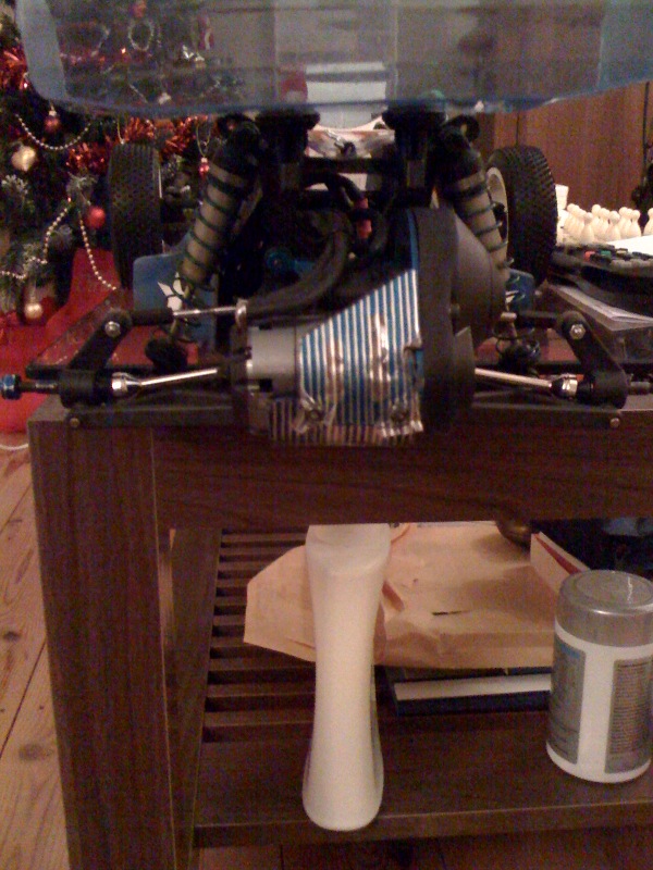

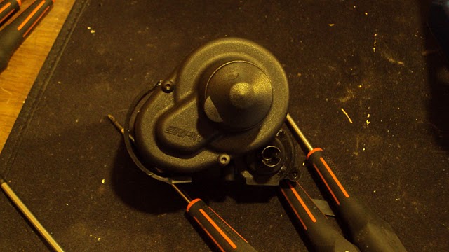

Cheers guys. The B4 slipper option is the way I will be going as the current B2 and B3 cant handle a 5.5 motor on carpet so to prevent burnout the B4 system will have to be installed. Also the B2 rear wishbones are shorter than the B3 so work better on this car. The front has the B3 wishbones and this makes the car wider at the front so you can better dial the car for corners as it keeps the front more stable and the rear just follows no matter what, plus you get more steering than you would ever need with the 25 degree blocks. The B3 blocks are not as good either and makes the car less aggressive so I have opted to stay with the B2 front and rear hubs and blocks.
Pics attached, sorry about the quality. The UJs are too short for this car even though they are from MIP for B2/B3. Shocks are spaced to prevent the UJ popping out, but it will with a crash. The inner hole is used and you can see hardly any droop on the rear wishbones, hence why I need more specifically for jumps. The car on flat carpet is dialed and can compete with the best of them, but the jumps cost me a shed load of time and thats what is costing me ten or so places. Ive added 200g brass plates under the cells and made a carbon fibre rear tower which is as thick as the standard one, I've fitted schumacher wing mounts to save the wing.

Does anyone know where the link is for updating the B2 / B3 gearbox with a B4 slipper clutch? Ive got the parts but am stuck so please show me the link so i csn fit it correctly. Thanks.
