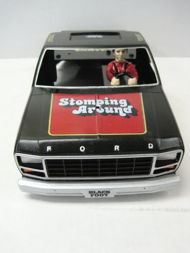

HI!... As lately I have accumulated a lot of Blackfoot parts. So I decided to start to built one the way it would of been back in 1986.
I just ordered a set of NIP roll bars and front windshield. I got the decals on tonight. I'll post some pics later. I still need the black plastic cover that goes over the servos and I need to find a set of original yellow wheels for it.

Great work ... but before you put on those new decals, why do you think that the black paint went on so powdery? I see that you sanded it down and prepped with primer, so I am wondering what happened with the last step.
Was it really cold when you were painting it, or maybe the can was too far from the body making it semi-dry by the time it hit the surface? I'm just worried that the decals are not going to lay smooth on the painted surface because of the irregularities, and after all the effort of bringing this thing back to life, it would be a shame to have air-bubbly decals...

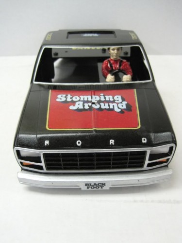

HI!... Well the previous owner of the body had like 5 layers of paint on it. The body was 100% mint so I didn't want to take the chance of wrecking it with any kind of paint stripper. They tend to eat plastic. So I put the body and it's parts in my fine glass bead cabinet. Did a great job of removing all the layers of paint but left the body slightly textured. I used TESTORS paint designed for that body. I'm no newb when it comes to using a spray can. It even has two coats of clear lacquer over all the paint. It's actually quite smooth. The camera is just making it look rough. The decals are sticking fine. No bubbles.

Oooh Aaahh... It looks great! That is one of my favorite trucks.
Are you going to run it, or is it a shelf queen?

HI!... Its going to be a shelf queen. I have 3 other I need to get more parts for and put together. I might turn one of the 3 into a Super Beetle. Then one of the other Blackfoots will be a runner. I have a NIP Thorp diff I need to put in something. lol!

I wouldn't bead/glass/sand blast any plastic body. Like you said, it left you with a texture. If you dip the body in brake fluid the paint will come right off and you'll have a perfectly smooth plastic surface to work with.

i kind of like the look that gave, adds a sort of 'scale-ism' to the truck, unique

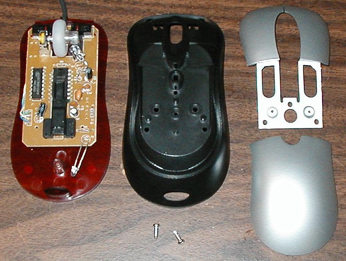

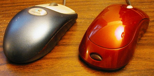

Sanding and primering isn't even half the battle if you're trying to go for a smooth, glossy finish. The reason why the paint job ended up with the orange-peel texture (which always happens unless you do the post-paint elbow grease) is because it wasn't wet-sanded and rubbed down with rubbing and polishing compound after the paint.shirochanwrx wrote:Great work ... but before you put on those new decals, why do you think that the black paint went on so powdery? I see that you sanded it down and prepped with primer, so I am wondering what happened with the last step.
A rattle-can paint-job, even with several coats of clear, will always appear like this unless you painstakingly wet-sand with progressively finer grit sandpaper, starting with 400, and then 600, 800, 1000 and 1500 grit, then follow that up with rubbing compound, and then lastly, a polishing compound. You could then apply a wax just for protection & shine after giving the paint a week to cure.
I attached a few pics of a mouse I modded 6 or 7 years ago. It started out with a fine-textured finish very similar to what you get after a rattle-can paint-job. After I wet-sanded and rubbed it down/polished it, you can see the difference--but it's several hours more work, for sure.
