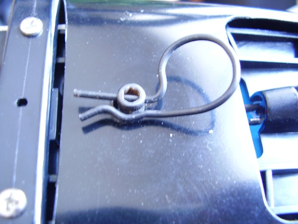

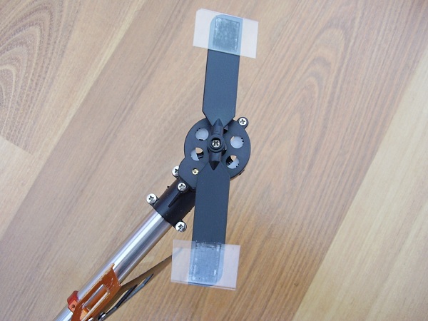

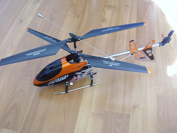

Friend of mine presented me with this chopper and I have been having a blast. it had issues out of the box but nothin a little mod wont cure. Seemed abit tail heavy out of the box so I shortened the tail boom by 1-1/4 inches.Over all length is now about 2 feet.It was slow to move foreward and backwards so Iadded a couple peices to the tail rotor to give more lift and it seems to have done the trick.This thing is alot of fun.Here are some pics and I hope to post a vid if I can figure out how.The body is mounted useing pressure fit just under the main rotor and a pain in the a$$ screw underneath that had to go so I drilled out the hole and used a screw out of my rc10 battery box.Much easier.

Its about 26 inches out of the box. The plant you see by the window looks a bit different now

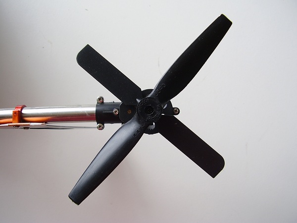

I am pretty happy with it. I took 1-1/4 inch of the tail boom. It seemed abit tail heavy out tof the box. I flipped the bottom blade assembly to help reduce blade strike and it worked well.Took 5 minutes. I am also waiting for a fly bar from a model 9077. It is shorter then the stock one and made of plastic.The biggest problem with these choppers were blade strike and blade/bar strike. I also added a prop to the rear rotor.

Added a prop.
