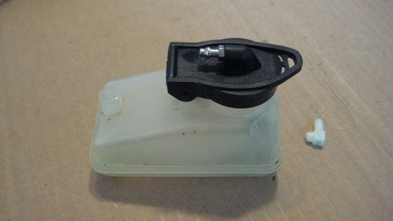

I immediately went back to the hobby shop and showed the fellas my tank, but alas they didn't stock any team associated rc10 series tanks. They took my info and said they'd give me a call (it was yesterday/Sunday). At home, irritated at being so close to seeing this thing run, and curious as to whether it came to me like this, or whether I inadvertently 'bumped' it while messing with the motor, I started looking online for tanks. That's when I made my discovery..
I don't know what tank this thing is, but it isn't the stock on 7719 I think it is, that is supposed to be with the car.
As you can see in the image below, it is not what 99% of the web images show. Most show a white lidded, non-internal fuel filtered unit. I did see one place selling a black lid with metal connector (the white ones are plastic, I realize this part doesn't necessary matter at all), but the other big difference is that the one's I see on the net don't have a fuel filter, whereas the one on my car DOES have a fuel filter inside. It also has the hookup to go from the tank to the engine in the back, and has a non-pierced place to connect something on the top/front part of the tank.
There are no identifying marks anywhere on it, that I have seen, making it a tough nut to crack. I spent several hours searching for rc10gt compatible tanks, and found hundreds of them, all looking like the 7719 just with different name.
Does anyone know tank this may be, or where to find other tanks that are NOT the 7719 that I could look into? I'm sure I could order the regular 7719, but I'm no dummy, I like the idea of having a fuel filter (and the car was set up for such).

Not sure what that tank is, but the 7719 does have a stone filter on the tank insert. I never had any issues with the stock tank. To be extra safe you can also install an in-line fuel filter like the one linked below. Good Luck

It's an OEM tank to it. They had black lids and white lids and same color as tank lids. The newer tanks will have the lid turned around opposite this one so you can fuel up thru the windshield airflow hole on the body. But then again I've gotten NOS old tanks when I've ordered them also but either way it'll work for you. And just like Thumber stated with the extra filter...these motors get expensive and the extra insurance of another filter is cheap.

So the 7719 does have the connector on the back like the one in my photo? I don't doubt ya'll, don't get me wrong, but it seems the photos on the online stores show no connector there at all, nor any mention of a filter inside. They look empty and have two connectors on the top only. Just want to verify, as the shops here don't have them, so I have to buy this online without being able to see/compare..

That is the RTR version of the tank, the 7719 tank is slightly different like Todd mentioned, but is still a direct replacement for that tank, you just need to route the fuel/pressure lines a little different. The difference will be obvious, and easy to work out, when you go to install the new tank. There have been many changes to the GT tank design over the years, but they have all been minor, and they are all compatible. That being said, the newest version is the best. Also, there were a run of bad tanks a few years ago, they are probably all gone by now, but when you get a new tank shake it to see if the stone filter rattles inside the tank, if it does you will have pickup problems when the fuel level gets near half full. Associated was sending out new tanks no questions asked back when this originally happened, not sure if they still would, but the bottom line is if it rattles you need a new one. This was also an issue with the GT2 when it first came out.
I disagree about adding a second fuel filter, the stone filter in the tank is excellent, adding an additional filter is only going to increase the chances of getting an air leak, and is just one more thing to worry about. I have been running GT's since 94', and originally did use a second filter, but after a couple years of never seeing a single spec of anything in the extra filter, I stopped using them, and have never had a single issue since then. :wink: :D

exitrooster wrote:So the 7719 does have the connector on the back like the one in my photo? I don't doubt ya'll, don't get me wrong, but it seems the photos on the online stores show no connector there at all, nor any mention of a filter inside. They look empty and have two connectors on the top only. Just want to verify, as the shops here don't have them, so I have to buy this online without being able to see/compare..
The fuel pickup is now on top of the tank, the fuel line simply goes into a recessed area in front of the lid, similar to where the pressure line used to go. The pressure line now goes on a fitting in the lid, just like the RTR tank you have. That recessed area on the RTR tank is where the pressure line used to go, and on the new tanks that is where the pickup line goes, but the fitting sits further back on the tank.

Good deal then.. Just ordered one, and picked up an air filter set as well.. Didn't seem to be any oval ones, figured since a tank would already be coming from them, might as well get the other thing I'll need anyway :) Can't wait for it to get here, lol. Would appreciate any tips/etc for a new rc guy :)
