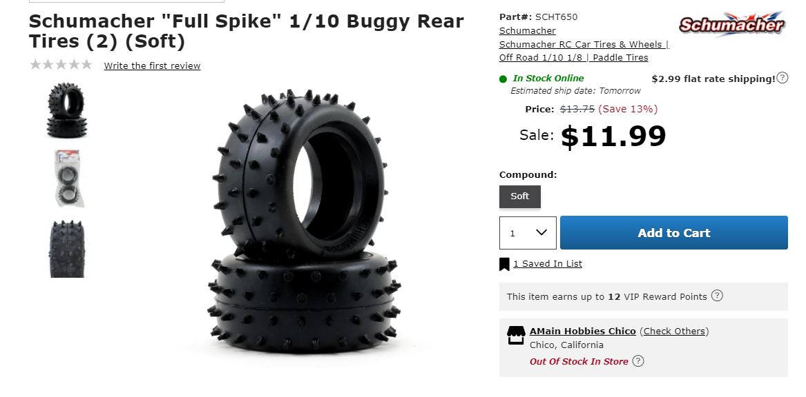

Anyone know what size wheel the Schumacher "Full Spike" 1/10 Buggy Rear Tires fit, part # SCHT650?? Are these 2.2", or something else? I ask because Schumacher also has the "Full Spike" 2.2" 1/10 Buggy Rear Tires, part # SCHU6596.

R6cowboy wrote: Tue Oct 15, 2024 8:14 pm Anyone know what size wheel the Schumacher "Full Spike" 1/10 Buggy Rear Tires fit, part # SCHT650?? Are these 2.2", or something else?
They are 2.0".
