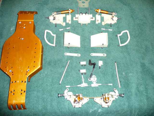

Re: If AE went back in time for a FACTORY TEAM 6-Gear RC10
First the white parts, in this shot already cleaned with kitchen detergent before the "whitening treatment" with Hydrogen Peroxide. Seen here, the original owner drilled the chassis for CRP nerf bars and to maintain the purpose of the holes and the cars legacy, I will be reusing them. The chassis holes drilled for larger servos by the original owner will be left in place, and used for the servo blocks.

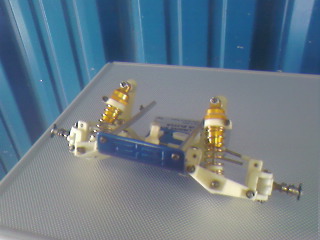

This is a pre-final build staging of the front suspension showing the contrast of the white parts and the gold shocks against the blue noseplate giving an example of the theme.
edit: I didnt like that the nosepiece was bent. I stripped it back down, and fixed it (see paint process photos later)
Nice build! You need to fit some blue Lohas rims (a la here: http://www.rc10talk.com/viewtopic.php?f=35&t=20207&start=120 ).
Btw, how are you peroxiding the white parts?
Those parts look great! I wanted my car to have more of a glossy, painted look without the thickness effect that comes with powdercoating. And because I used Easy-off to strip the anodizing, I couldnt reanodize my original parts anyhow. So the blue car motivation is heating up all over! Thats great, I dont feel so different now.

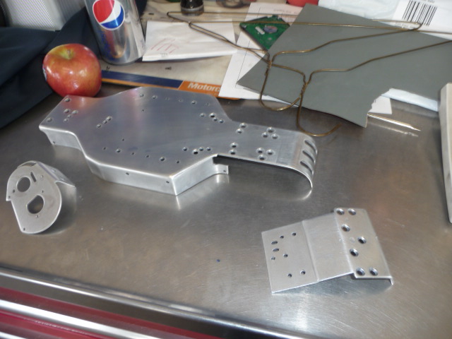

Never heard of that problem? What happened to your parts that you could not re-anno them???And because I used Easy-off to strip the anodizing, I couldnt reanodize my original parts anyhow
the chemical in easy-off is part of the cocktail they used commercially to strip any oils dirts and previous coatings on aluminum prior to anodizing, so that should not be a problem

The active ingredient in Easy Off is sodium hydroxide, I left it on too long.
- Posts: 431
- Joined: Thu Jul 31, 2008 5:26 pm
- Location: Southern California, USA
CNA75 wrote:Btw, how are you peroxiding the white parts?
4 bottles of 3% in a Target purchased shallow rectangle tub. The pieces were flat and not touching, all submerged in direct sunlight. Every 30 minutes I would flip them over, keeping them under. After about 6 hours I took out the servo savers and battery trays. A second full day was all it took. I was not going for colgate white, as thats not original anyhow.
RC10resto wrote:Never heard of that problem? What happened to your parts that you could not re-anno them???And because I used Easy-off to strip the anodizing, I couldnt reanodize my original parts anyhow
The etching was really deep. Too much elbow grease required (prep costs) So as I wanted to keep the original 3 pieces in my build, I am doing the elbow grease for no pay
- Posts: 431
Sand, sand, sand, sand.... polish....sand....sand sand.... polish polish....sand polish
If it wasnt an original early Cadillac A stamp, I would have tossed it. Looking forward to a future YOUTUBE video where I blast an "empty" can of Easy Off with my Dad's 12 Gauge using a bird barrel at close range.
