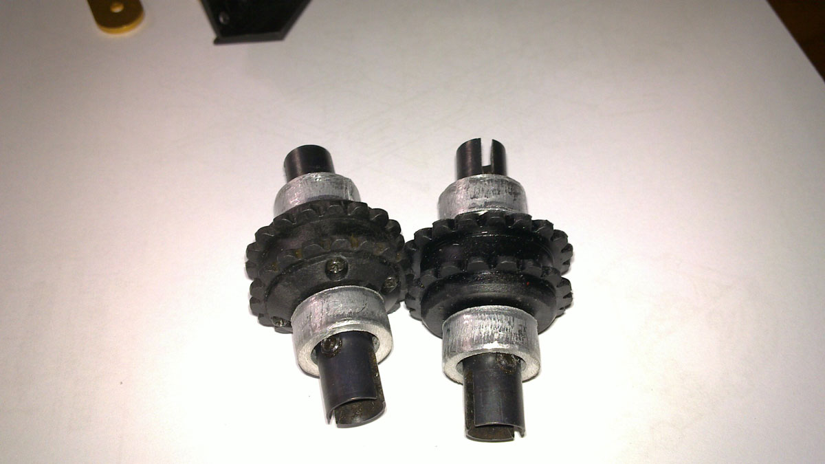

The original running gear parts are quite hard to come by so I have installed Kyosho Optima chain diffs using custom made adapters.
I had the adapters made up by a mate of mine but unfortunately he doesnt have a mill so he cut rings out of aluminium which I pressed together to make bearing spacers so that optima diffs would fit into the radiant housing.
I had to machine the front gearbox housing to fit the optima diffs also.

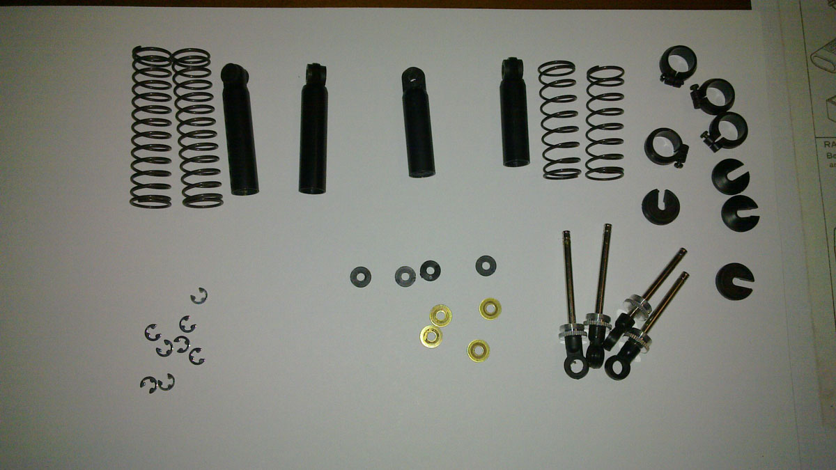

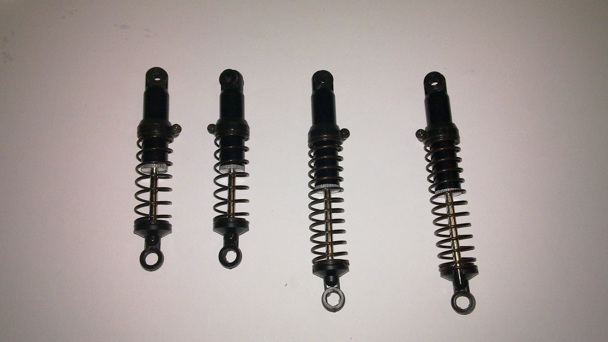

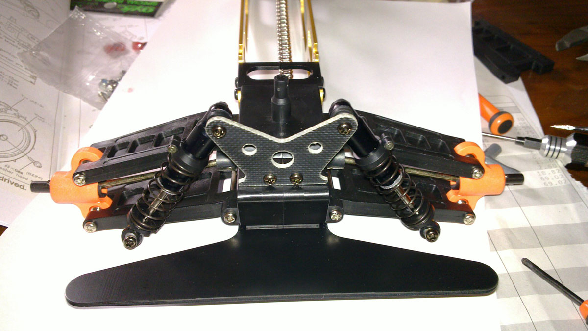

First step is to build the shocks. Not the best design IMHO but I got them to work ok

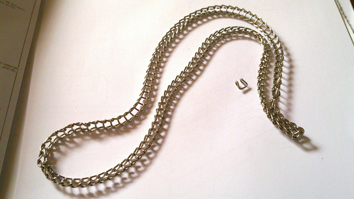

I used Hyosho chains. I had to remove one link for the front and lot more for the rear chain

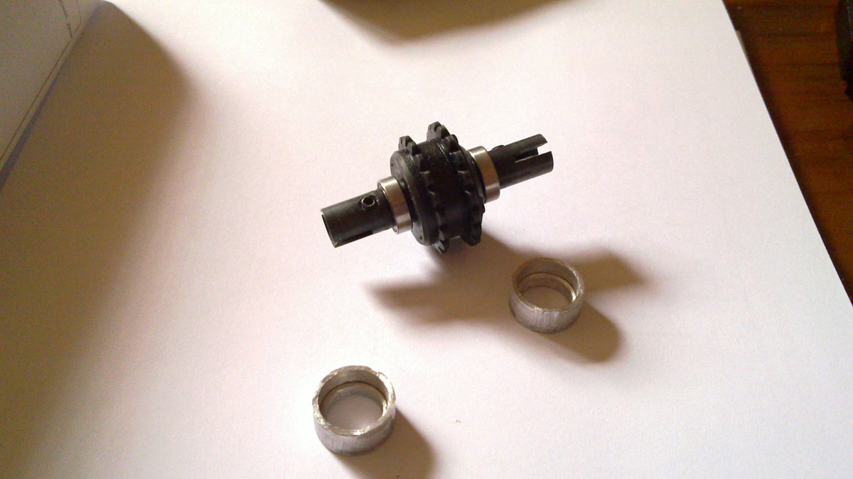

Here you can see the 2 rings I pressed together to make the diff spacers. The rough outer surface grips the inside of the diff housing well.
The assembled diff with spacers over the bearings

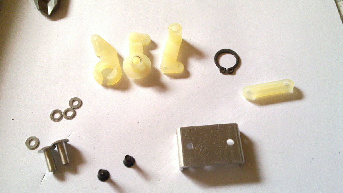

The Pro Radiant sterring components. I left off the spring clip as it was too small.

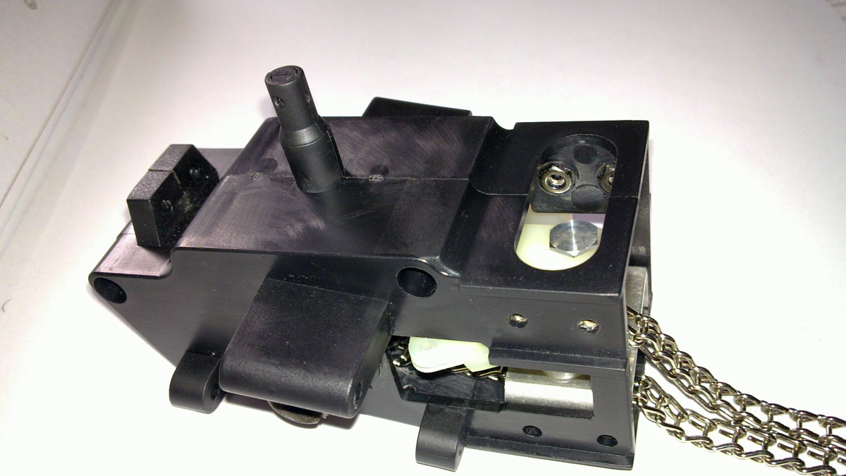

The assembled front gearbox housing.

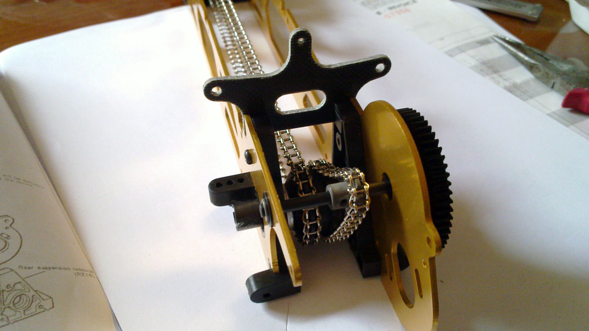

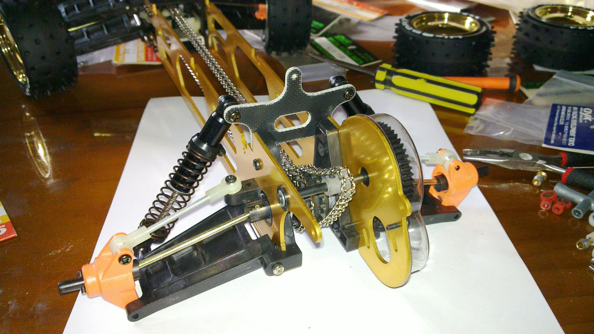

The rear diff assembly completed.<br />The small pinion for the chain needs to move to the left so I will need to machine the layshaft a little.

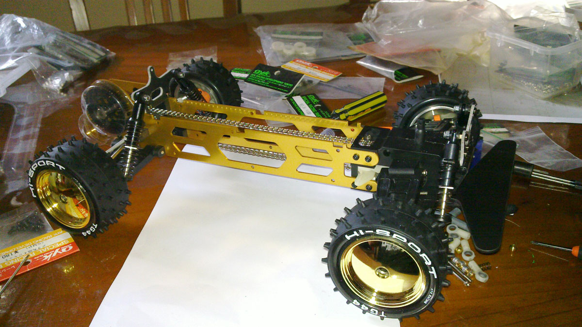

The front end assembled. I had to use non standard ball for the shock mount.
The rear end assembled. I found the standard rear linkages after I made the ones you see here. I will fit them later.

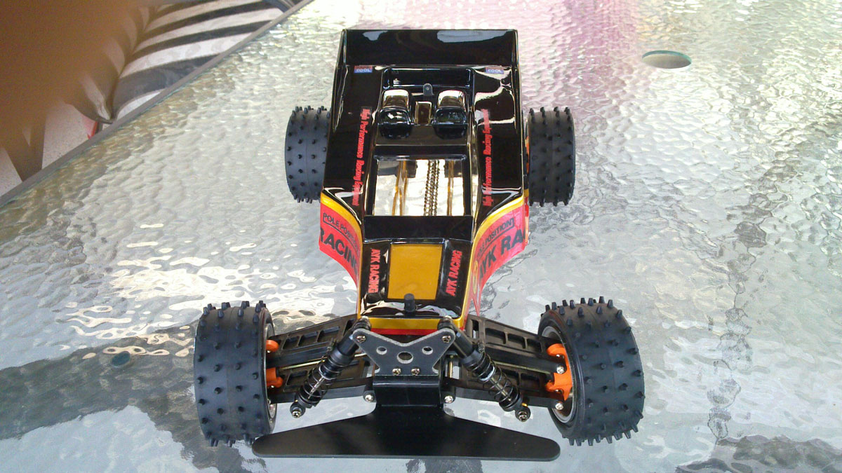

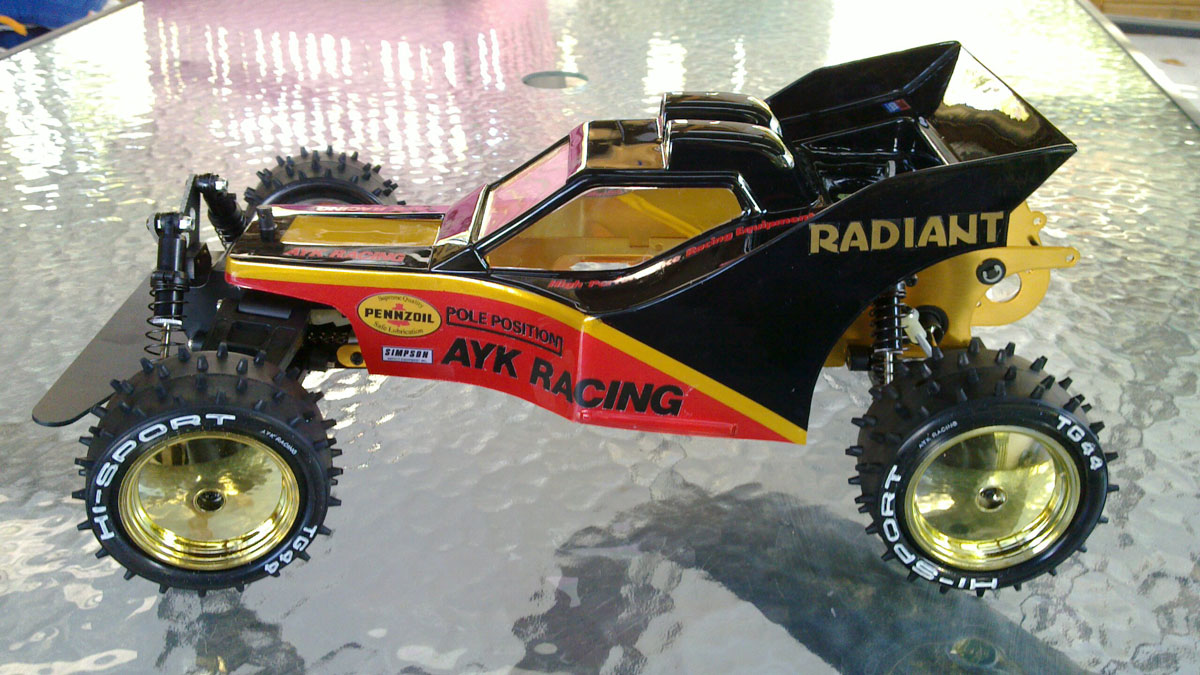

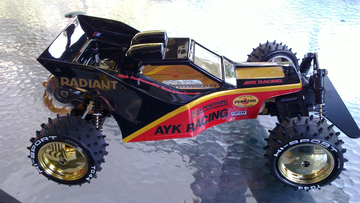

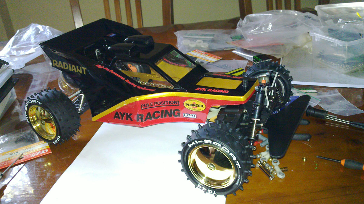

Here are the assembled pictures.
I used some repro decals for the AYK stickers and made up the Radiant stickers from letter set.

Thanks guys. The optima gear is smooth as. I had to open up the openings for the outdrives a touch for clearance also.
I am very happy with the way it turned out. Bling Bling Bling :lol: :lol: :D

Looks great ...... Any chance of the dimensions on the spacers and did you try a 0ptima belt drive unit?

Hi, No I didnt try the belt drive as I dont think a rear belt would be easy to find. I measured it all up with digital calipers but found that sizes were too tight. The measurements were modified to suit. When I pull the layshaft out I will measure the spacers up and post sizes.
The front gearbox halves just needed some extra material cut away from the bottom thickness to clear the chain.
So now the base thickness is approx 1mm in the thinnest part.
