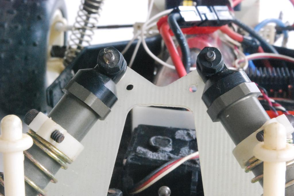

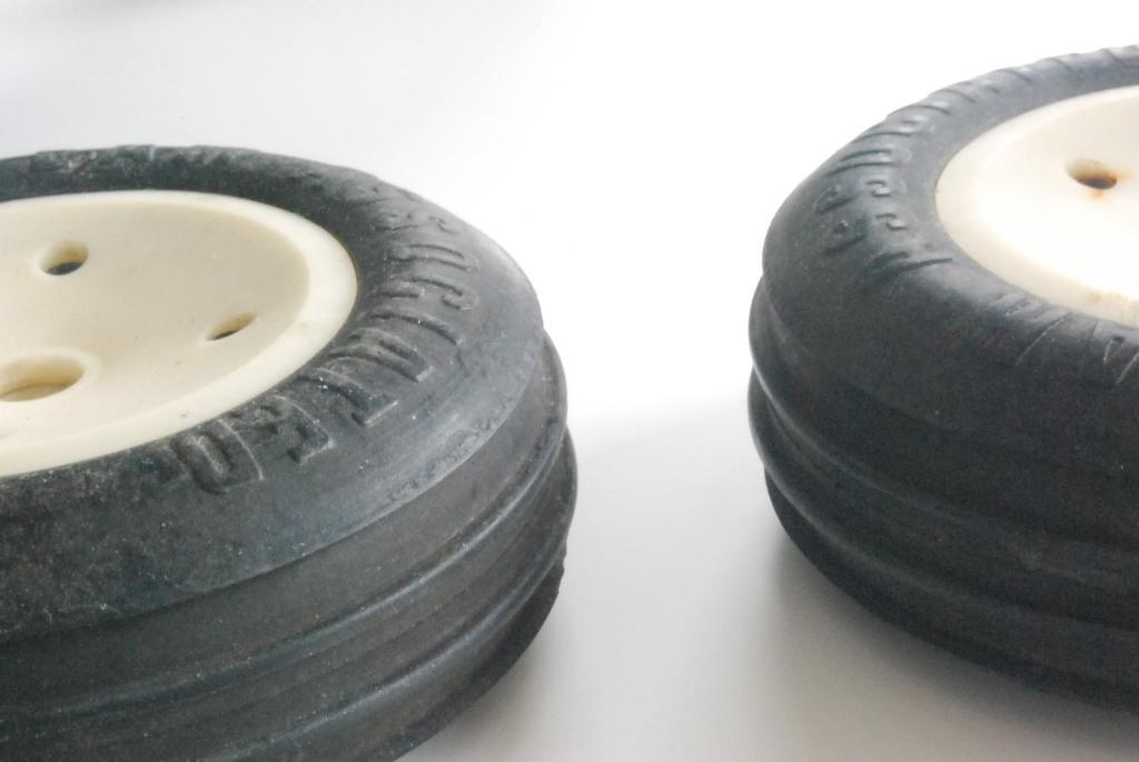

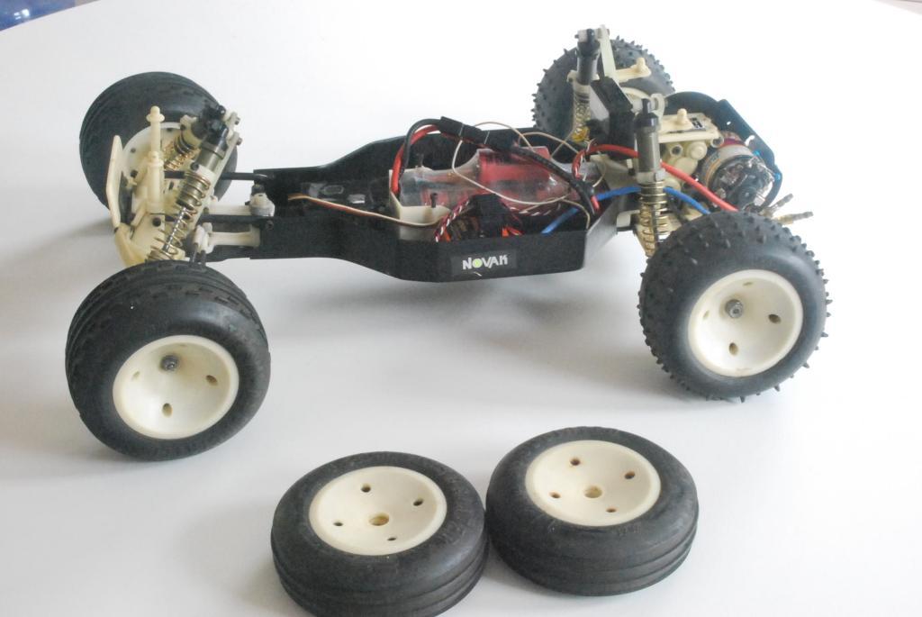

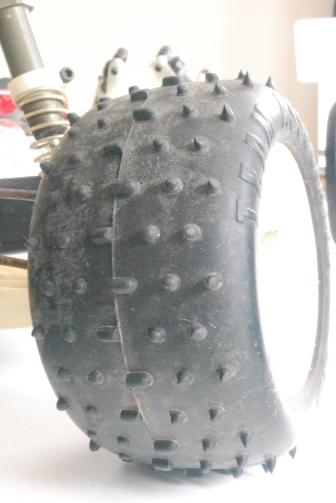

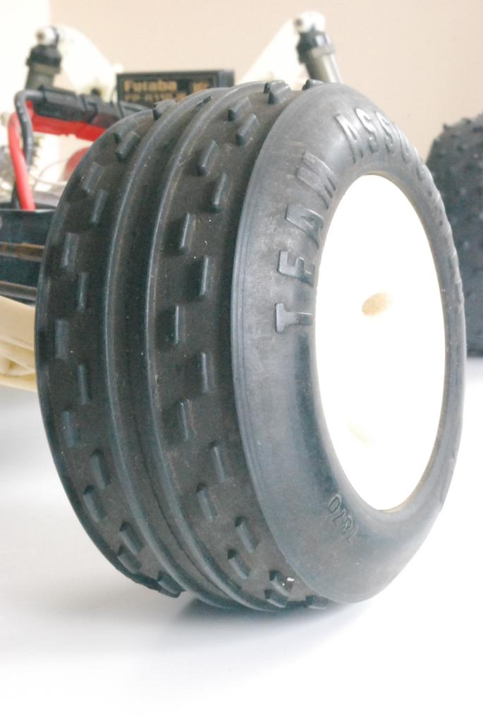

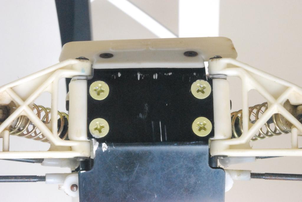

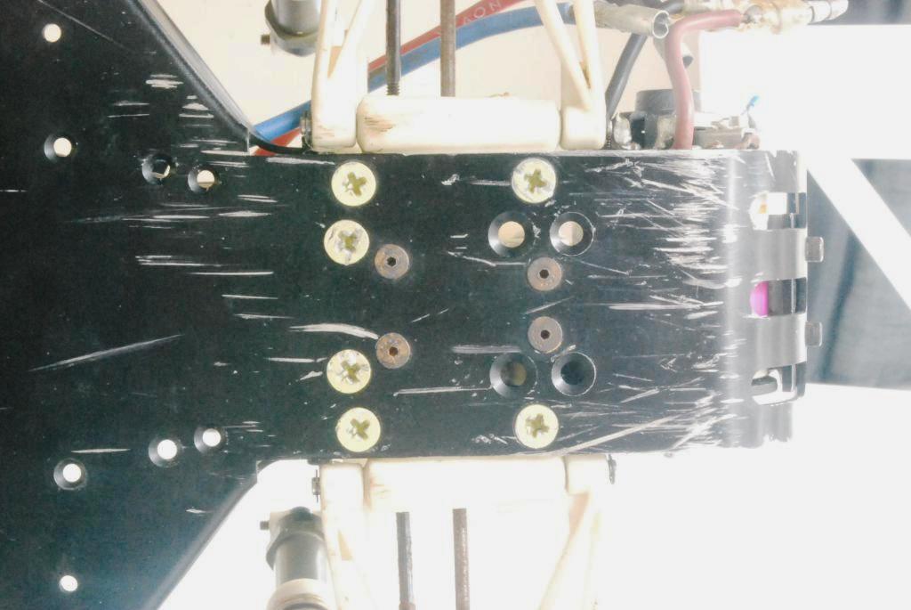

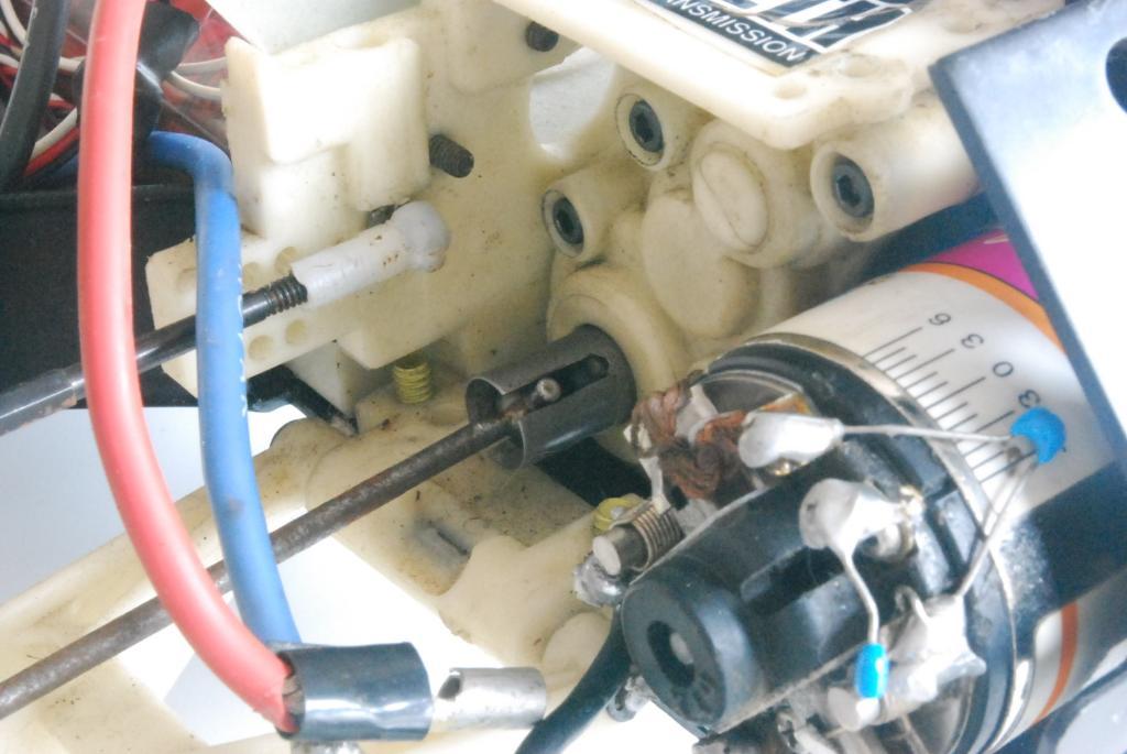

Some photos to show how good of condition it is in. I bit of ware on the ass, but I plan on power coating or re-anodizing it anyway. I'm leaning towards a light runner/shelfer, but not a box art shelf queen. Likely modern wheels and tires, modern electronics and a full resto. The wheels might go up for sale, but I'm debating on weather or not to keep'em for a shelf queen even though they are slightly worn.

Do not sell the wheels, you will regret it later! I purchased a set of narrow front wheels for near the same price you paid for the truck. Don't sell them Dude!

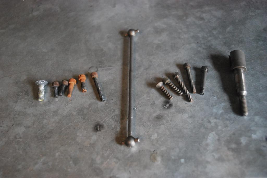

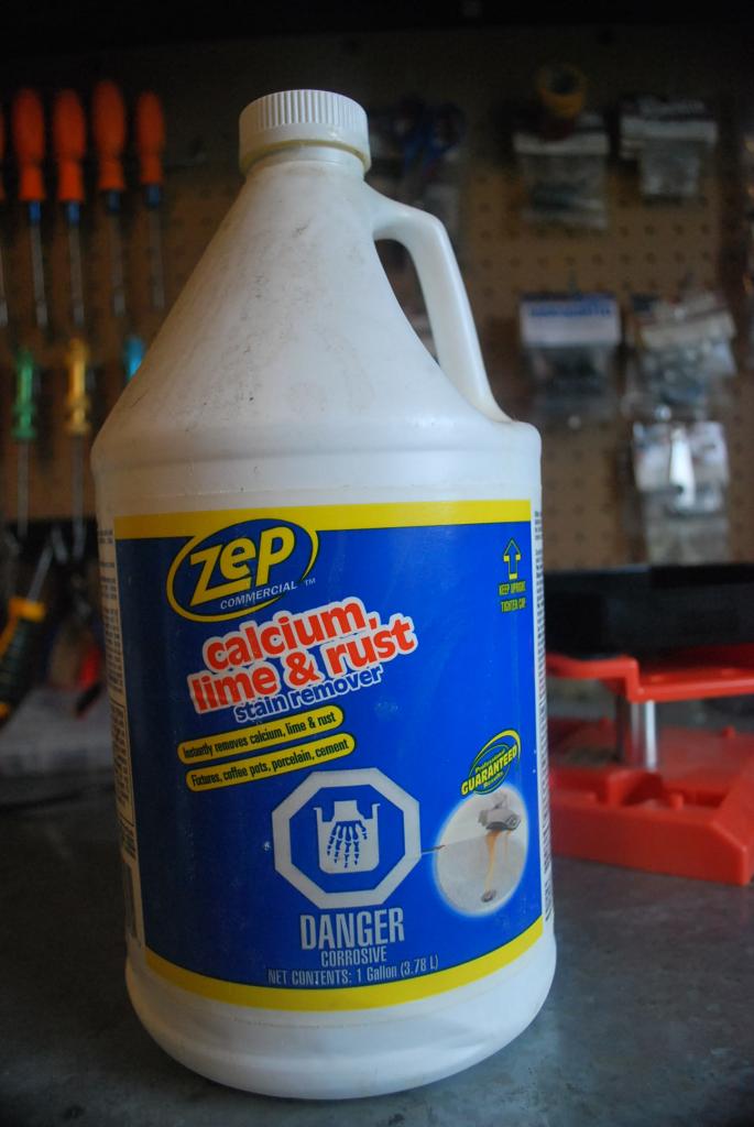

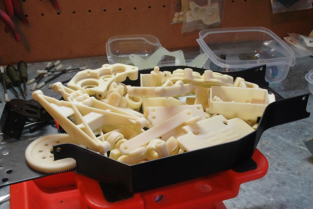

I'm going to begin with cleaning this one up like I am cleaning up the buggies from the 25 yrs of RC10 project that Rod's up to. I disassembled everything, washed all nylon parts in Simple Green, and then bleached them. I also used Zep to remove the rust from the hardware. I got to rebuild the shocks and tranny. I got to get some new hardware for this one to add a bit of flare and then powder coat the chassis parts.
I got to boil some parts, polish my shafts and pins too, I need to get a 10T body and decals...it will be a while before this one is outfitted with electronics :roll:
here is how she looks right now

The nylon parts look great, does the bleach work better or/and quicker than hydrogen peroxide? Also, the ZEP stuff, it chemically removes the rust (no scrubbing needed)? What does it do to black oxide, black phosphorus, or zinc chromate finishes?

Bleach does not do much as far as the whitening is concerned. I tried it before the peroxide trick surfaced. The rustoleum rust remover I used on my metal parts will attack anodizing. I am not sure on the zep stuff but I would use caution with anything that dissolves rust and grease.
