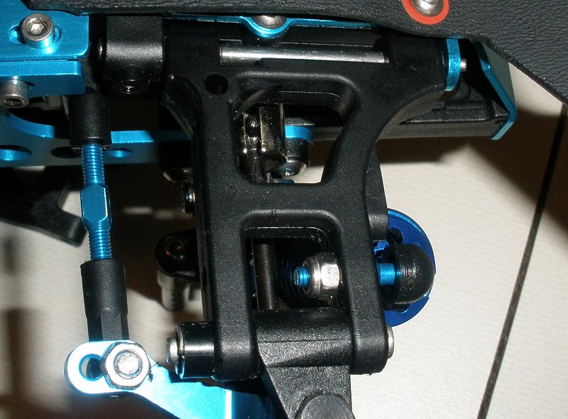

I believe it's possible to widen the Optima's rear stance with longer control arms, but does anybody know if shorter control arms exist, or tried something that worked? I'm thinking of something like the front arms I used from the Spider, which work with 43mm dog-bones (at least with my CYANide Optima). I could use the same-length dog-bones for the rear as with the front.
The control arms would need to have the same width on either end as the stock arms have, use the same suspension pins, rear hub carrier width, and keep the wheel in the same position (i.e. not alter the wheelbase). I wonder if the Spider rear arms would bolt onto the Optima?
Anybody have any ideas? It's times like this I wish I had boxes full of leftover parts... :?

The Spider rear arms should bolt right on to the Optima, since the first Spider was Optima-based! The original Spider used optima front and rear gearboxes with a different chassis (top deck is I think also the Optima MID SWB top deck), with the shorter Spider suspension to narrow the car to 200 mm.
Basicly the first EP Spider was an evolution of the Optima-based Scale Car/Oval cars (which were LWB Optima MIDs with a wide touring car body), from 235 mm wide to 200 mm wide.
Only from the Spider TF-2 onwards the chassis and gearboxes were different.

That's what I thought, thanks for the reply EvoRevo. If Spider rear arms will bolt right on without changing the wheelbase, I'm thinking about trying that out with my on-road project. It would look perfect with the rear wheel width the same as the fronts.

Yup, that will work. I converted my mid few years ago using those arms. You can still use the stock optima rear hubs...since those work nicely with your wheels.

Okay--at least for the CYANide Optima, I'm probably going to scrap the idea to install shorter rear control arms as nothing out there lends itself to an easy swap. The Spider rears are almost a centimeter less wide at the hinge-pin end as the Optima arms, and are quite a bit TOO short...about 18 or 19mm shorter, each, than the Optima arms. I'd still dig some alloy rear hub carriers, though.

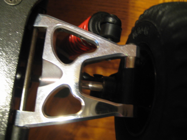

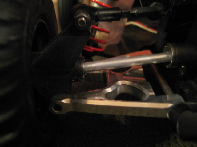

you mean something like this ?

Exactly! Nice goodies there, Paul. :)
One thing I've learned is that the Spider/TF2/TF3 rear arms won't work to replace the Optima rears, as they're much too short (about 19 mm shorter than the Optima arm) and too narrow at the frame-rail end. The Optima arms are almost 4mm wider.
The fronts would work great, however. :)
