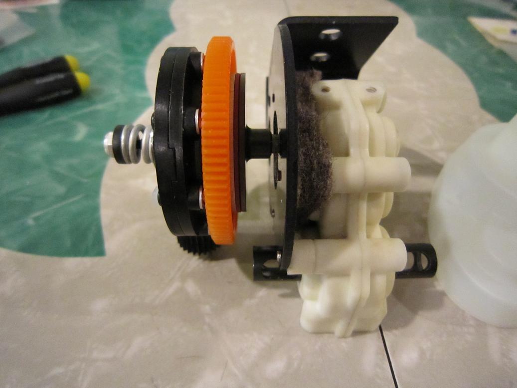

After locating a used upper shaft for mounting the hydra unit on a stealth trans, I'm having having a problem after the complete unit is installed and going to put the rpm gear cover on( cover hits the unit). I knew there was a problem as soon as I saw the spacing from the spur gear and motor plate. The whole unit is to far away from the motor plate. Was there different length top shafts or is the shafts that are made for a MIP gearbox longer?

first do you have a shot of the shaft? is it squared on one end like this?
take the hydra unit off the shaft. make sure that the inside of the inner housing is free and clear of any crap and line it up on the top shaft again. everytime i put a new unit on a shaft it's always a bitch. just slowly, with slight force, push it on. it'll go on slowly. don't expect it to be hard at first than finally go on easily. it'll go on the whole way hard. push it on with both your thumbs, while your fingers are grabbing the motor plate. it's best to do it with the tranny out of the buggy/truck. as soon as you feel it going on, turn the the hydra unit 90degrees and keep pushing it on with your thumbs. this way you get the unit on evenly and not damage anything. take your time putting it on. that's the only pain-in-the-ass thing about the hydra on the stealth.
here's a shot of what it should look like. the spur should be 5/32'' from the motor plate.
let me know if you need a copy of the losi instructions for the hydra on the stealth. i'll send it to you.

i just spotted the problem. you have to use your inner STEALH hub with the losi slipper pad. not the losi inner hub that you have on there.

Great! Thanks for the help. I will give the steath hub a go. The unit I have is for a Losi trans and it does not tell about the steath in the directions so this was a big help, thanks.littleVETTE wrote:i just spotted the problem. you have to use your inner STEALH hub with the losi slipper pad. not the losi inner hub that you have on there.
