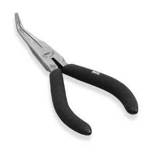

Paul, First I use a pair of medium sized channel lock type pliers to push the pin out as far as I can. The jaw of the pliers is slightly offset which allows me to rest the lower jaw against the pin while the top jaw pushes the top of the pin through. I then use a pair of needlenose pliers with a near 90 degree bend in them grasping the pin with the end and rocking the plier along the length of the axle for leverage. The pin usually will come out that way. It has been suggested on this forum that crimping the pin down a little before reinsertion will keep you from having to deal with this any more. Hope all that is clear, I don't have pics right now.

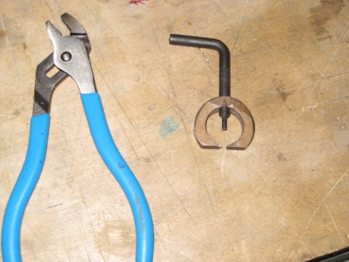

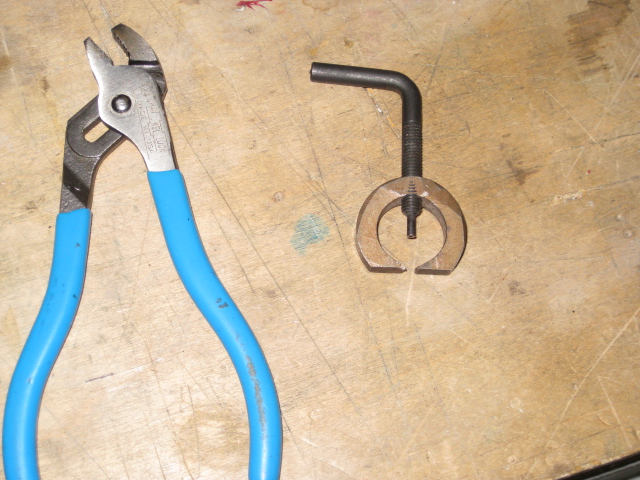

I hope this helps and you can find one. It is a pinon puller fo slot cars that I ground down one side of , it slips but I have had good luck with it

yes, getting one of the ends flush with the axis is the easy part (multigrip pliers do the trick) but it indeed becomes tougher after that. Pushing it with an external length of metal is what I did, but even then it's a challenge as it's hard to secure the axle in a vice without damaging it.
mmmh pinion puller, I should have thought about it myself!!!
