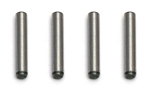

Re: Alternative to roll pins
The new ti roll pins for 3/16 axles are pretty nice, I haven't broken any yet. # is 1654
http://www.teamassociated.com/parts/details/1654/
