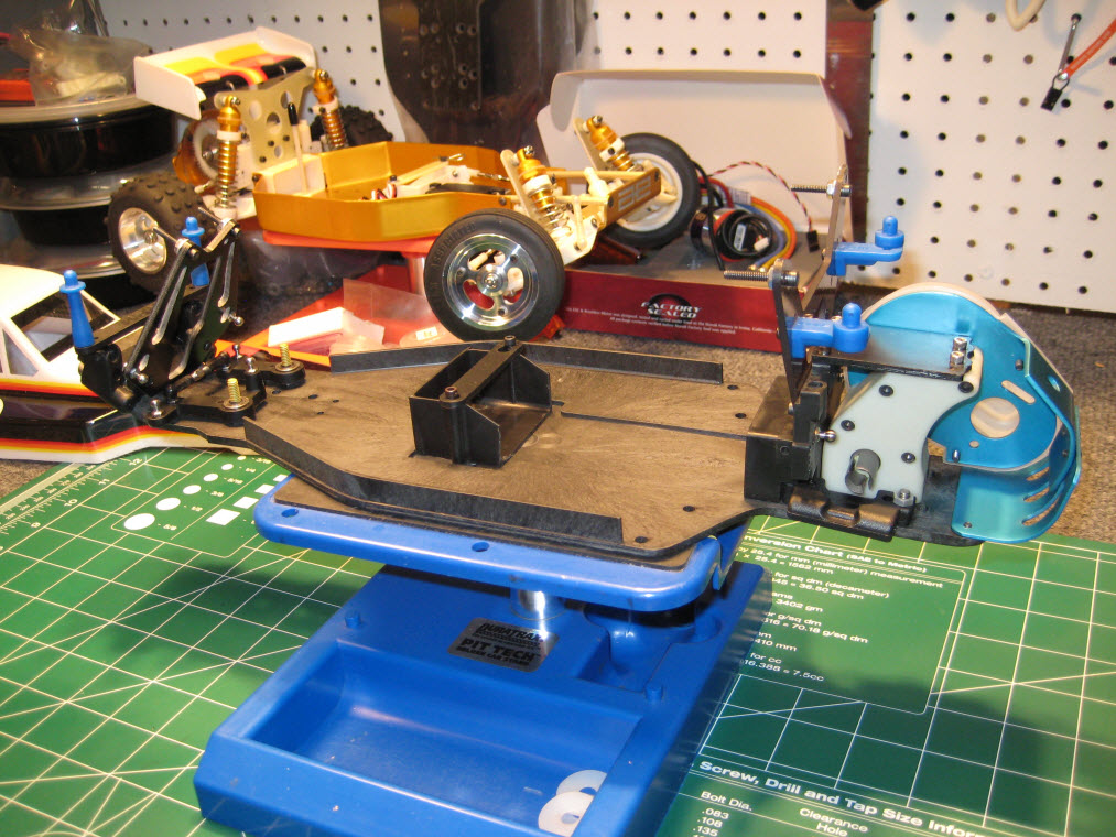

Just wanted to get some ideas on what to do with a CE I'm building, and how I can salvage making the mistake of buying the "truck" chassis, for a buggy build. Thought it would work, but thats what I get for swithcing sides from ye old Losi :)
http://www.ebay.com/itm/Vintage-New-Andy-s-RC10-Molded-Graphite-Truck-Chassis-/220841009142?pt=Radio_Control_Parts_Accessories&hash=item336b265ff6
After buying this and building it up, its looking too long for a stock Protech body. Has anyone built a buggy with this "truck" chassis? Also, theres alot of inner rub where the rear arm pivots are, against the chassis. I'm assuming thats because it was meant to have trailing arms.
I was thinking to go with 2.2 buggy wheels to bring it closer in perspective, but I kinda like the CE wheels, now that I dyed them fuschia :) I'd rather not drill out the chassis, but it seems I might have to to make this work right, or at least to get the arms free and clear. Any thoughts would help... Thanks.

The Andy's chassis were designed to take either the Andy's trailing arm setup or rear A-arms. I've build a couple of Andy's buggies and trucks, but I used Andy's or RPM A-arms. With the exception of the earlier RC10 buggy rear arms that use the longer inner hinge pins, it should work with pretty much any of the others.

i think those andy's chassis's came out before they released the RC10T, thats why the front bulkhead looks like a buggy noseplate, its meant for a "rc10 conversion" with truck tires... as far as fitment i dont know, maybe its longer?

It's about 3/4" longer than the buggy chassis. Essentially, it's about the same length as the RC10 tub chassis with the nose plate in the extended position.

thanks guys, i think im gonna leave it a buggy, and just modify the chassis. i dont wanna change any original parts (besides the chassis) or cut them either. i made a hole template, to move the trans and arms forward, but I need to know the stock wheelbase length from axle to axle before make any changes. i'll trim whatever else is rubbing back there too, once I know the exact length i need. i want to make sure a Protech or Viper body fits properly too. i'll shoot some pics once i get it going. thanks :D

I say leave it long wheel base. My 22 feels like a limo but handles great. That chassis should put you right there for length. JConcepts has a lwb body out for the B4.1 that may cover the chassis well enough too.
