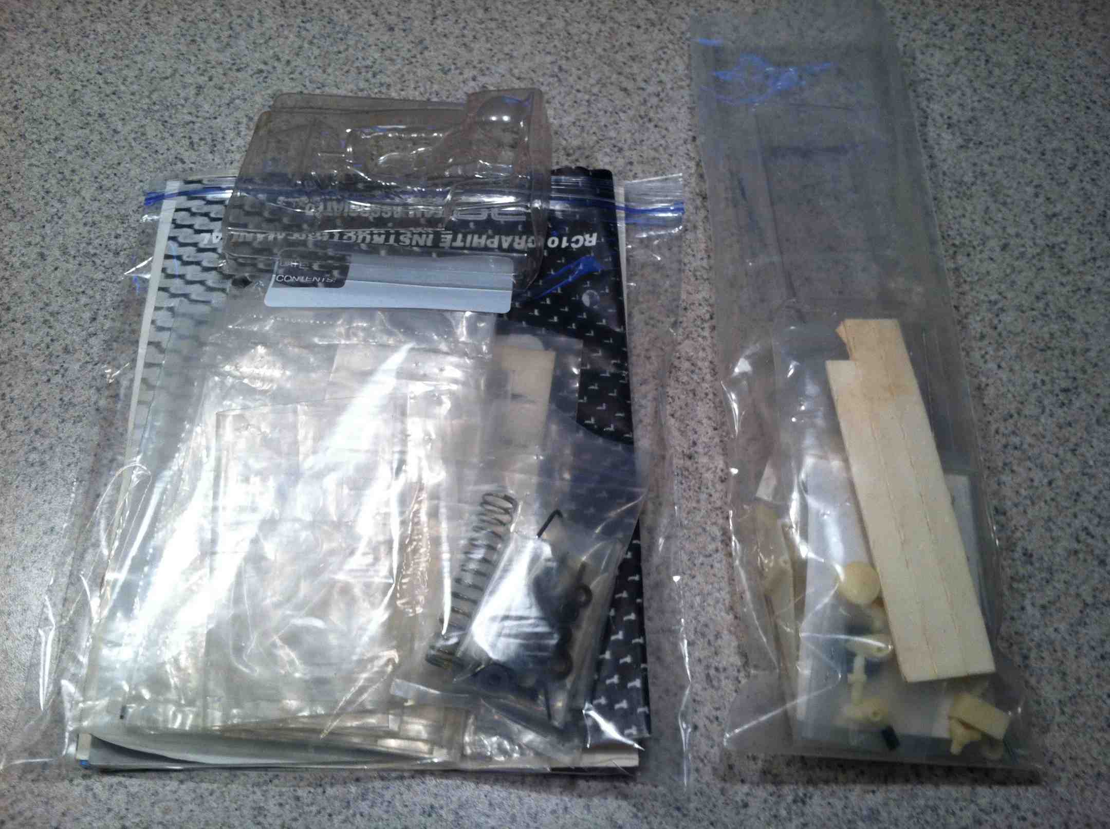

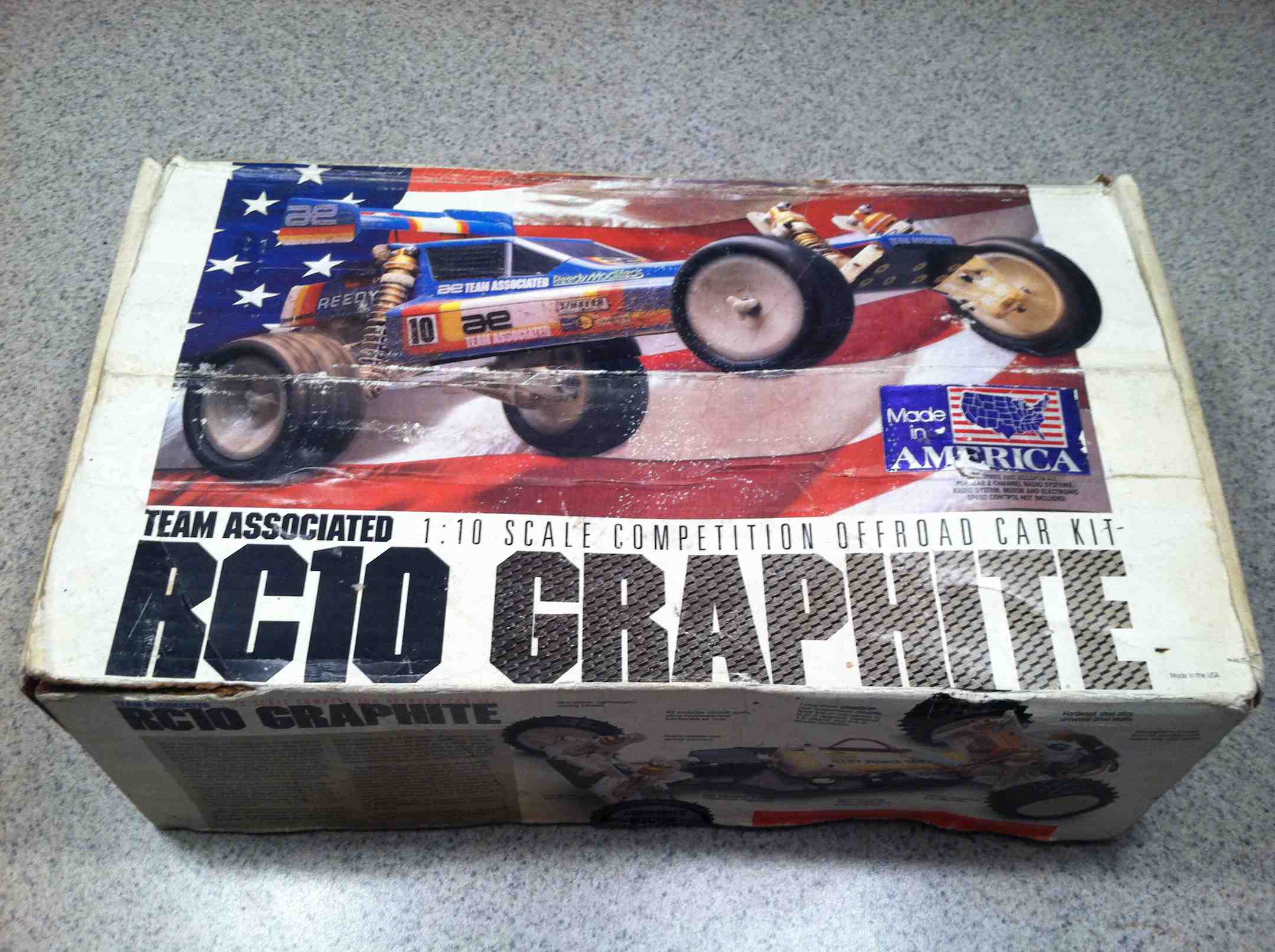

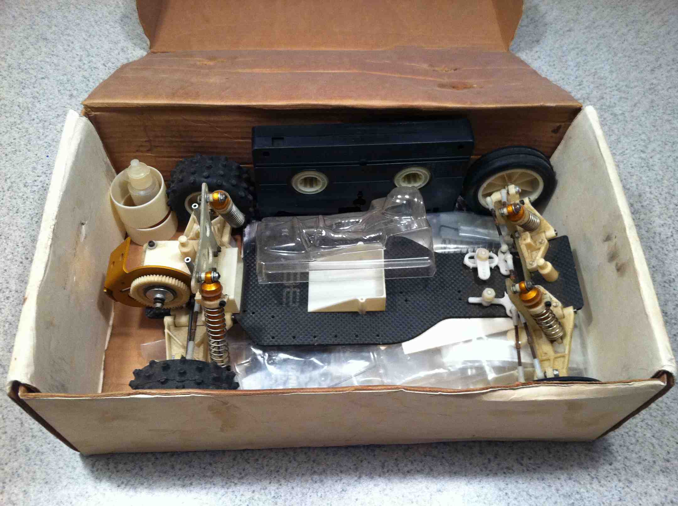

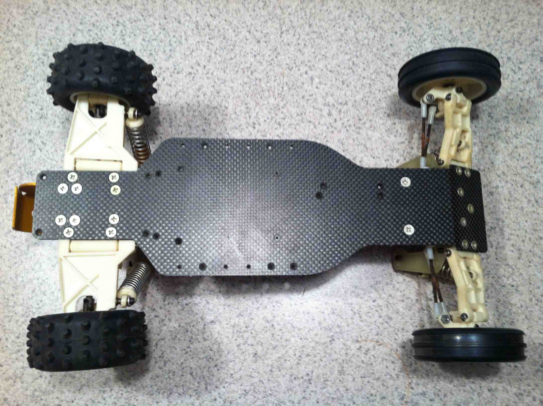

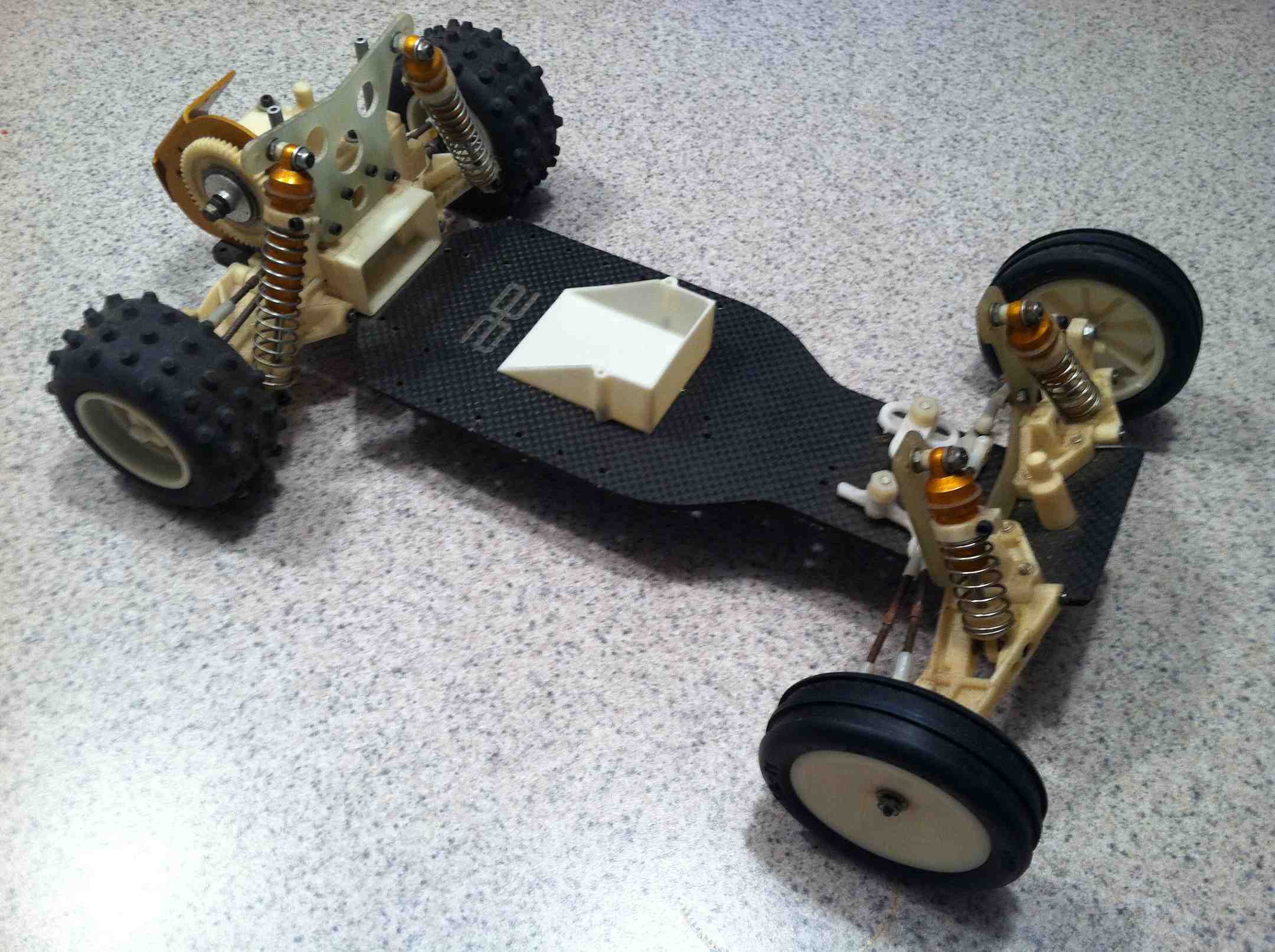

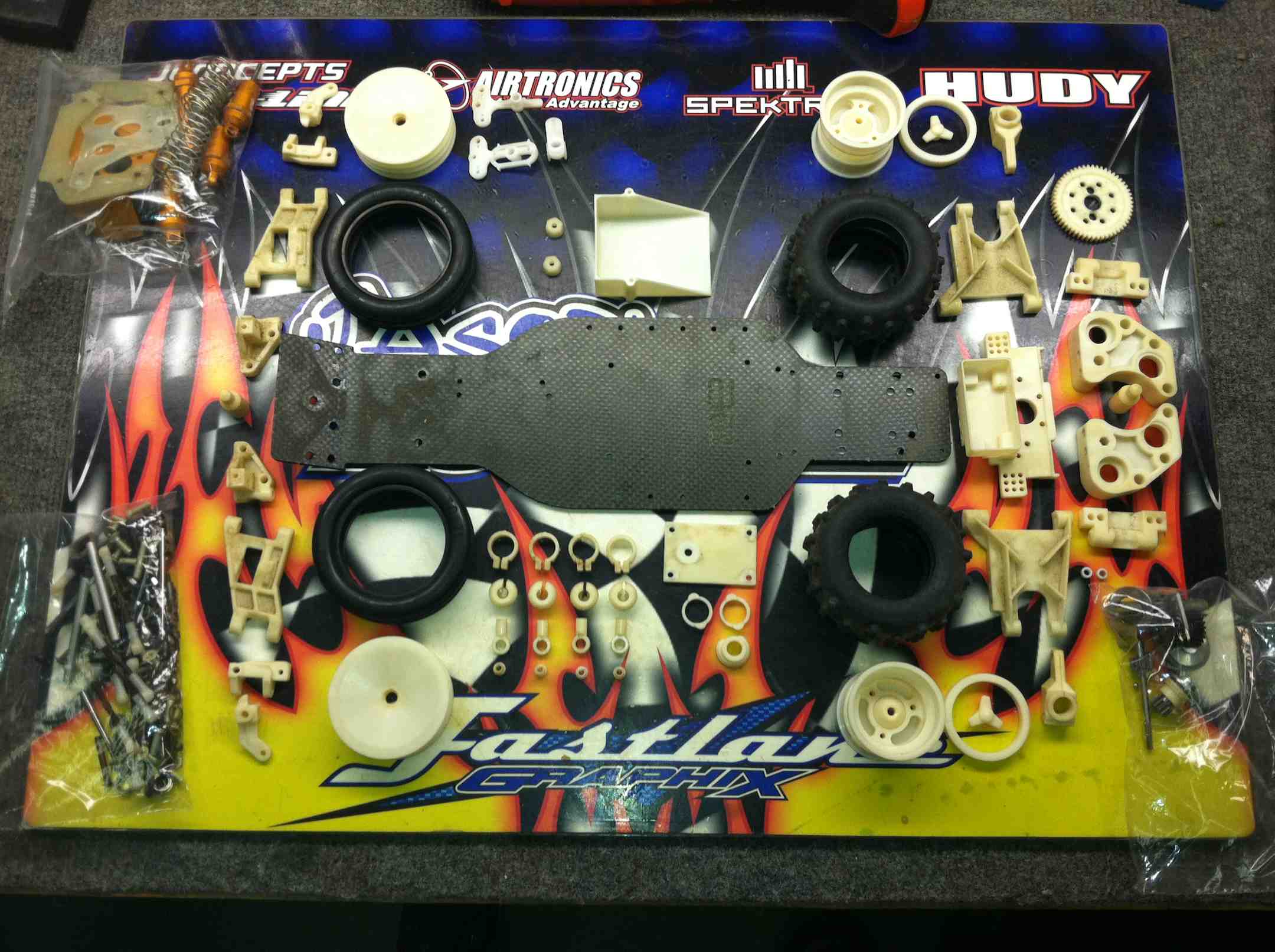

Well, pretty much finished my Halsey build and decided it was time to try it again. Found this baby on Craigslist. Pretty much stole it! $60 plus $10 shipping!
Looks like it was put together but never run, just sitting in the old owners closet collecting dust. :shock:
I think I can provide her with a good new home! :wink:
Don't think I'll be needing this! LOL

Chassis looks great, that's the hard part to that car- nice find.

I had to make my own graphite car a part at the time lol . SWEET DEAL there!!! DON

Thanks for the compliments! I feel like I just won the lottery! I took it apart tonight and the thing has never had a motor mounted in it! I split the gear case apart and the gears look like the day they were made! Woohoo! JACKPOT BABY! :lol:

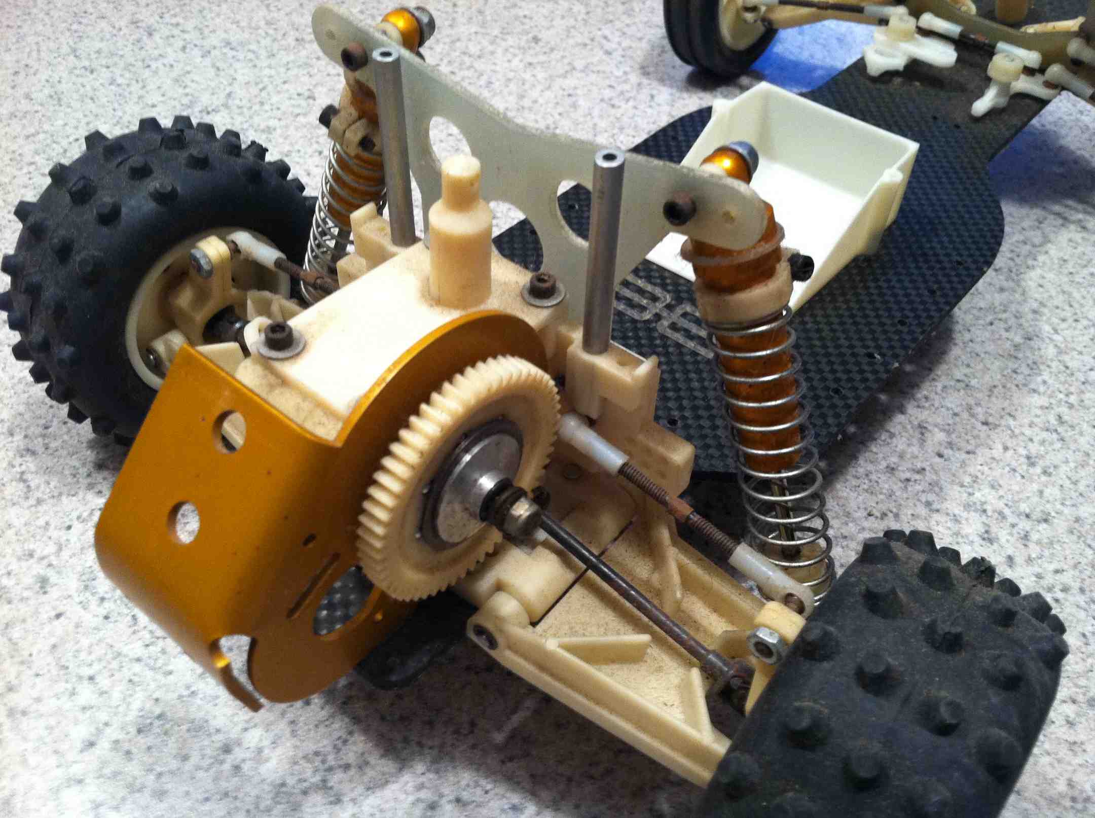

Is the rear end motor guard (connects chassis to motor plate) in one of those bags?
Posts: 16816
Re: Kooz's Graphite Project...
JPAE07 wrote:Is the rear end motor guard (connects chassis to motor plate) in one of those bags?
6 gear graphite cars didn't come with them. only the team car.

My RC10 Graphite came out of the box with TQ21 rear tires, though. Yours look like original gold pan rears. Did they also ship with those rears?

trkneller wrote:Very nice score.
Nope
As scr8p said.... Nope no rear motor guard with car. :roll:
trkneller wrote:My RC10 Graphite came out of the box with TQ21 rear tires, though. Yours look like original gold pan rears. Did they also ship with those rears?
The only tires I got with the car were the ones shown. Thankfully, the fronts weren't glued! 8)

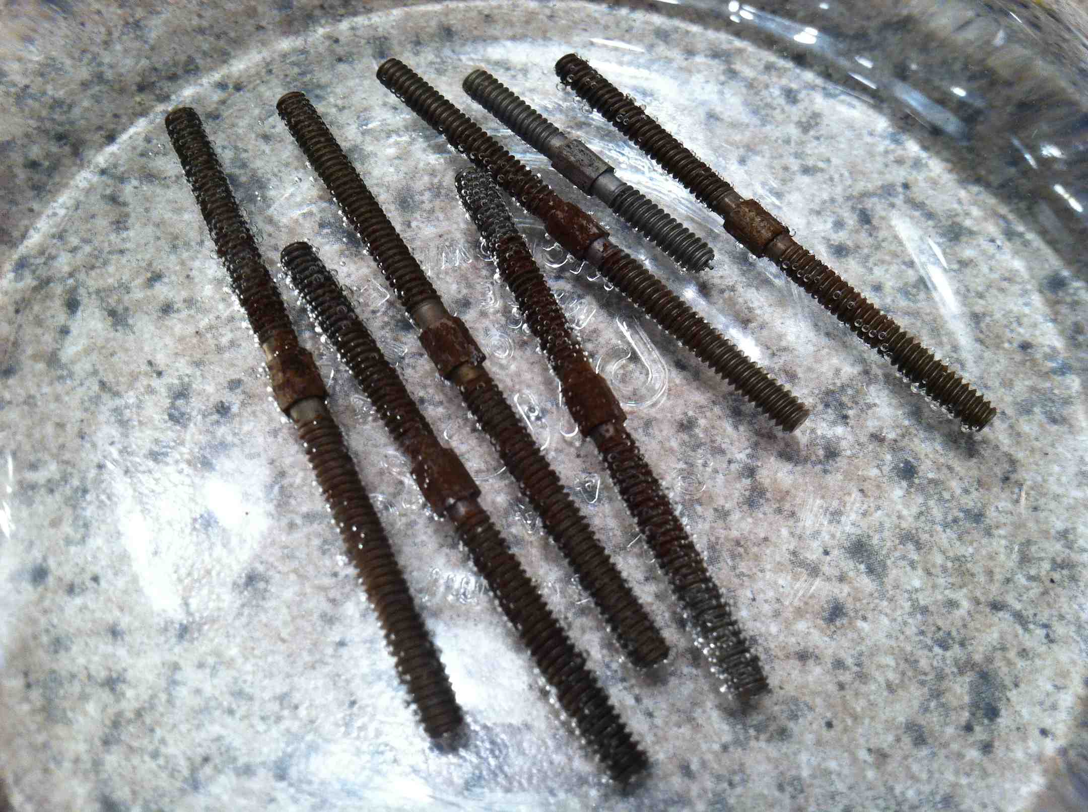

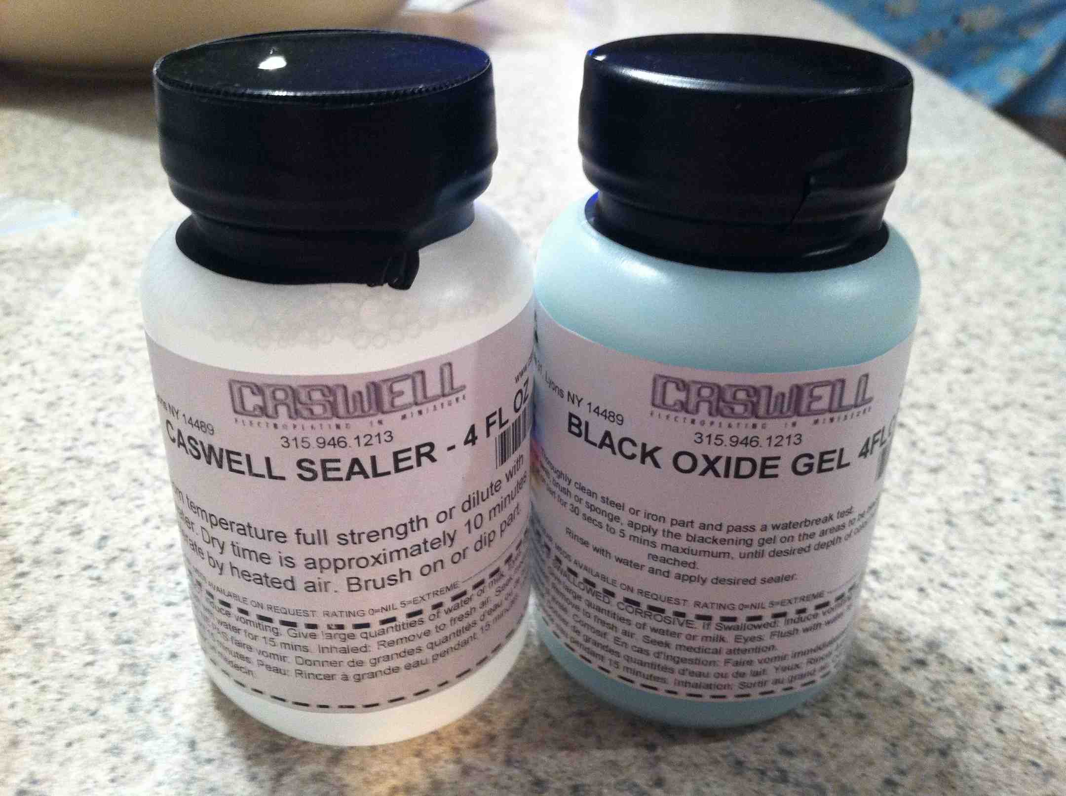

Has anyone boughten one of those do-it-yourself Black Oxide kits? I tested the vinegar rust removal trick with one of the tie rods and it works GREAT! Only it strips the Black Oxide off as well as the rust. :evil:

Well, I'm going to try some of this :
http://www.caswellplating.com/kits/black.htm#stainless
The non-stainless gel kit. I will post some results soon. :roll:

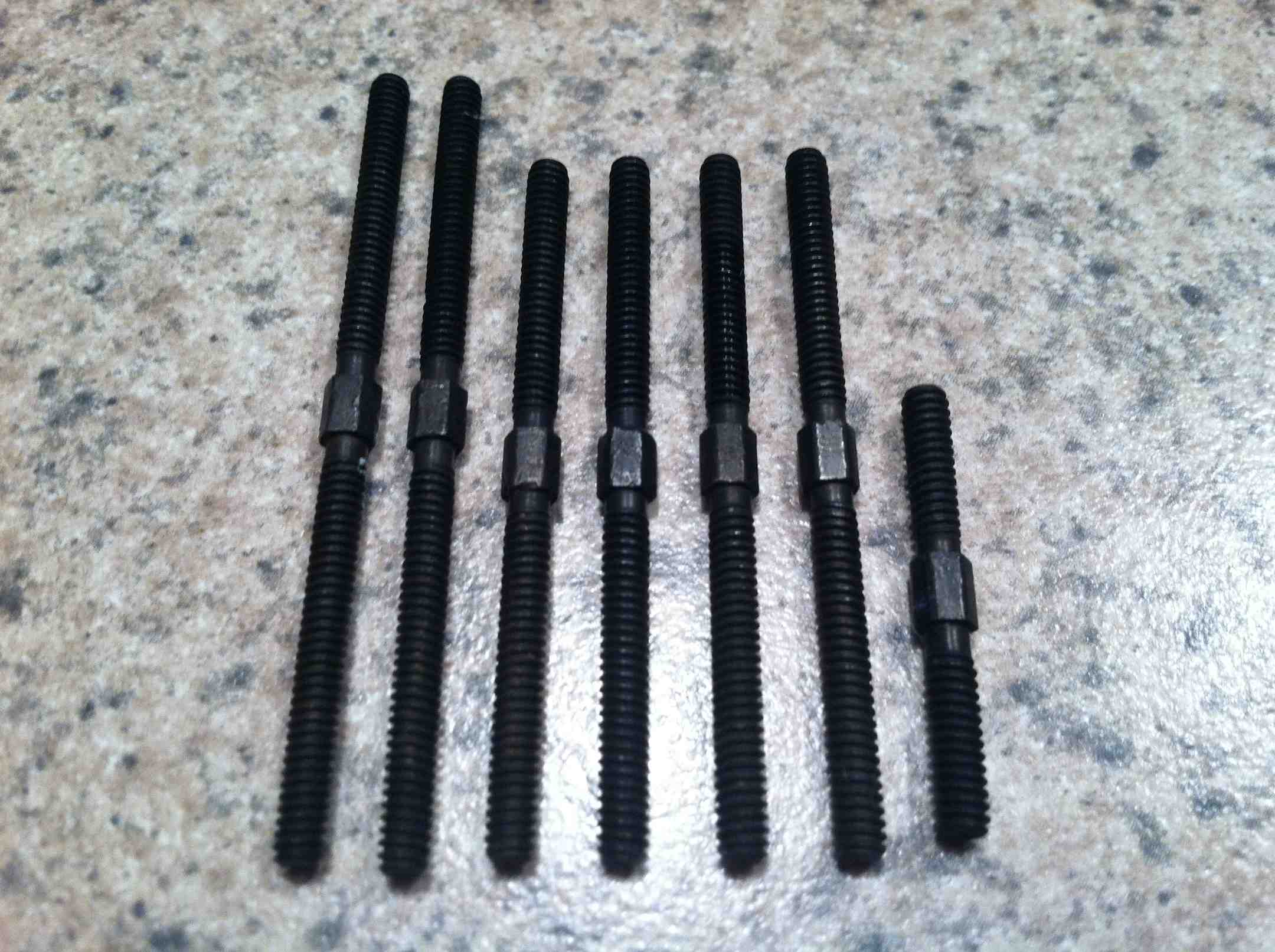

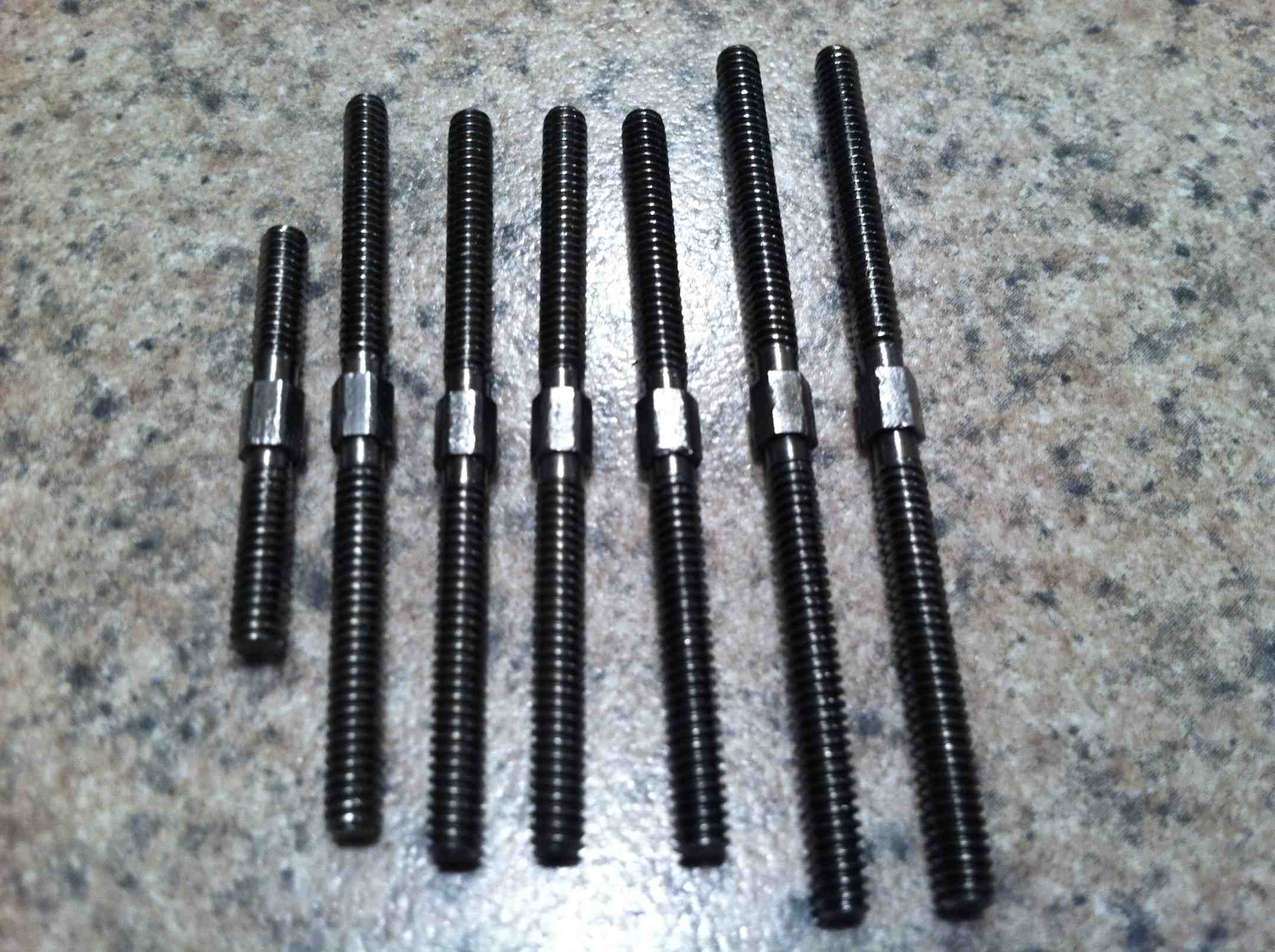

Here are my Do-it-yourself Black Oxide results.... Not bad! :)
What comes with the kit.
My vinegar bath over night to remove the old Black Oxide & Rust.
Polish & Prepped ready for the test.
Final Product.
