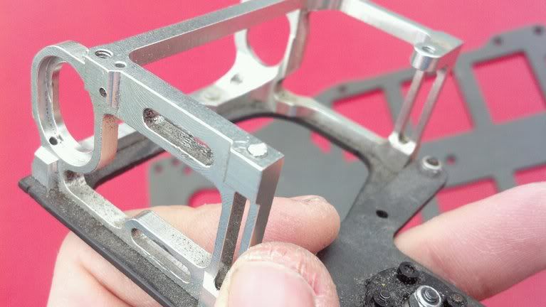

i have one of these i might put on it at some point. It is on an on road project i built right now though. I also have a nice set of black locking hubs for it and the telesis front end to install as well. I have cleaned up this rear pod and removed the broke off screw. its as good as new now.
