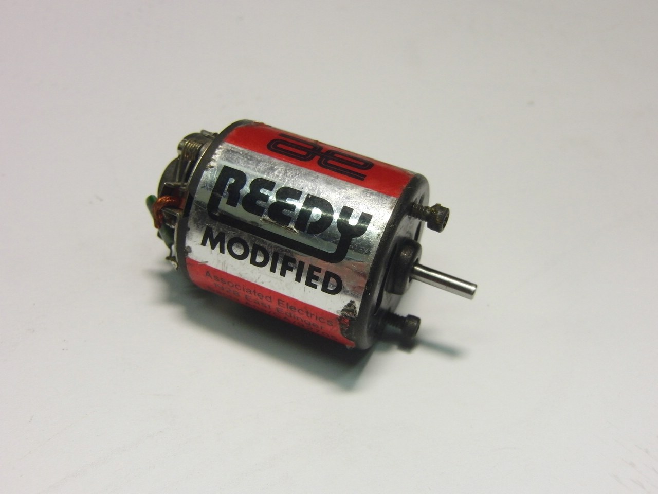

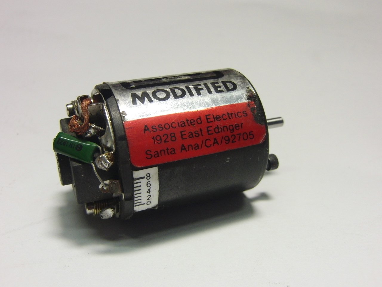

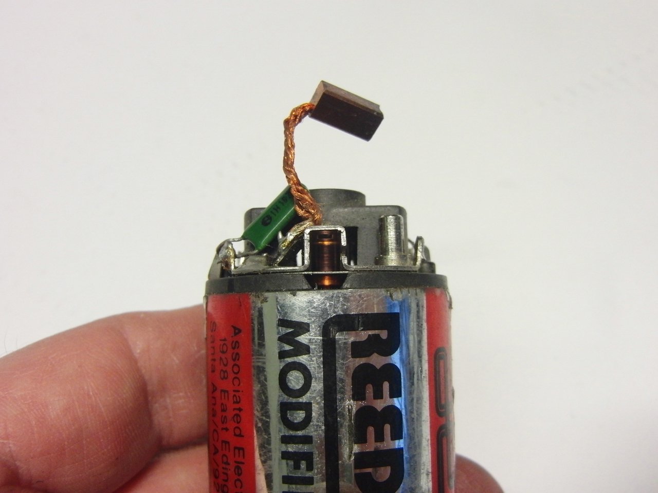

Hy to all.
I´ve got an old Reedy Modified motor, but dont know what turn and mfd.
Maybe you guys can help me out!?

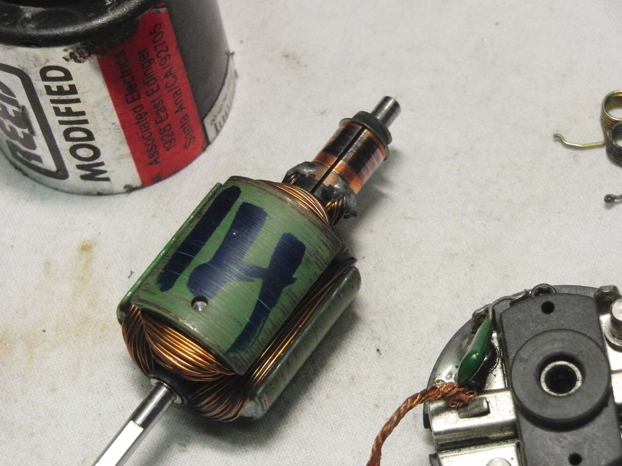

Someone said that the red lable edinger (non heatsink endbell) motor was a 13x4 and it is the boxart motor for the early 12l- take the endbell off and we can tell with a shot of the armature. Brused motors are relatively easy to identify as they often have the windings written on the armature stack, or you can tell from the approximate gauge of the wire (looks pretty thin in that shaft shot) can be telltale signs of winding type. An 10x1 and a 10X5 have the same amount of wire wrapped around the armature, the difference is that the 5 has 5 thin wires (for increased resistance and a lower "punch" on the bottom) the single has one larger wire for lower resistance and more punch on the bottom. Take her apart 8)

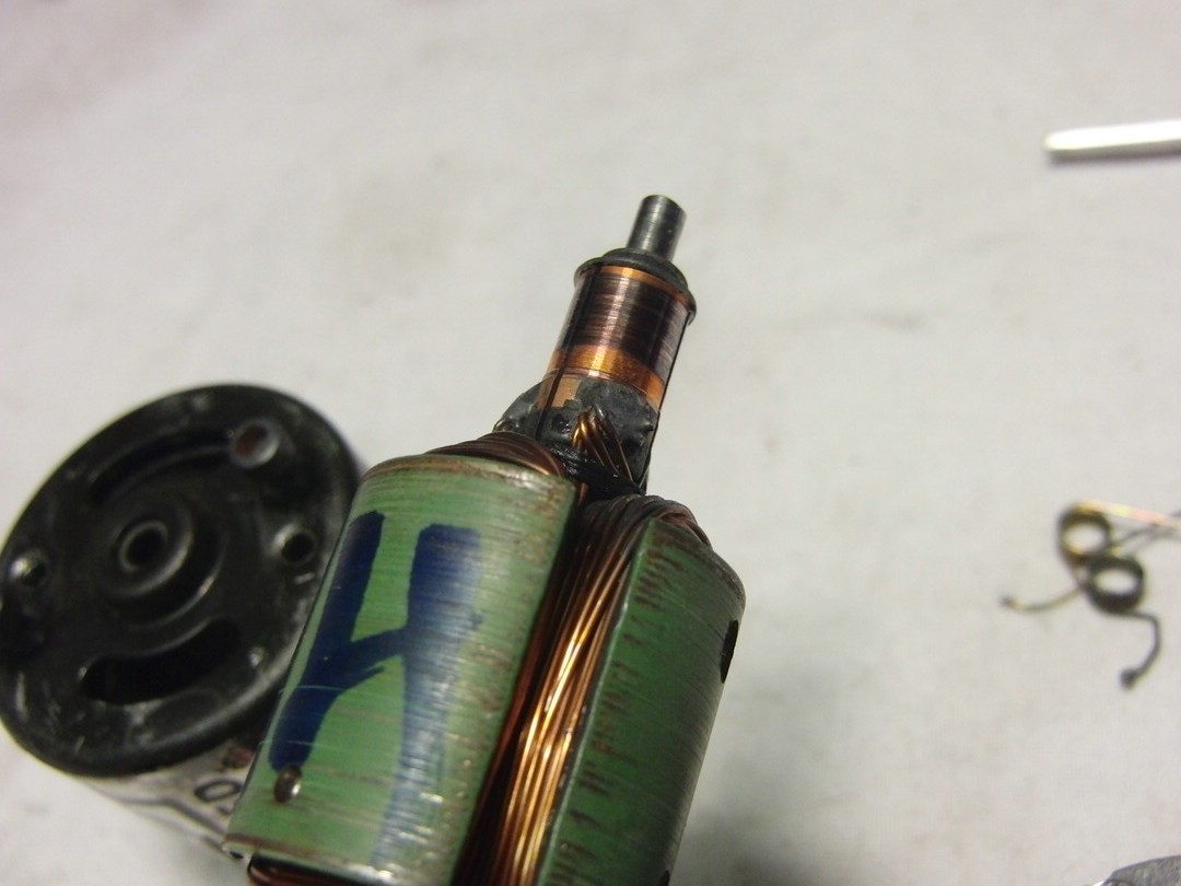

Took the endbell off and this is what I came up with. Looks like an 14x3 to me...
