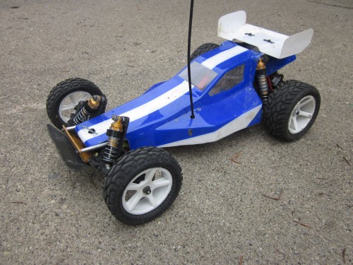

Been reading RC10Talk for over a year - Glad to finally share some information! Saw a recent post on this topic and thought this is the perfect time to start posting.
Like many of the folks on this page, I used to race my RC10 in the 90's and am now back running my cars with my son! My 90's race car was piecemealed up with all the typical hop ups, and I fortunately never threw anything away. Fast forward to 2012, in the intrest of getting a 2nd car going to run with the kids, I found enough parts to get a second runner together. Had most of the parts, and bought a few, but one problem: No rear bulkhead or transmission!
Below is a build of my gold pan with homemade rear bulkhead, and B4/SC10 transmission. The B4 transmsissions are much cheaper and easier to find, and the bulkhead wasn't too bad to fabricate!

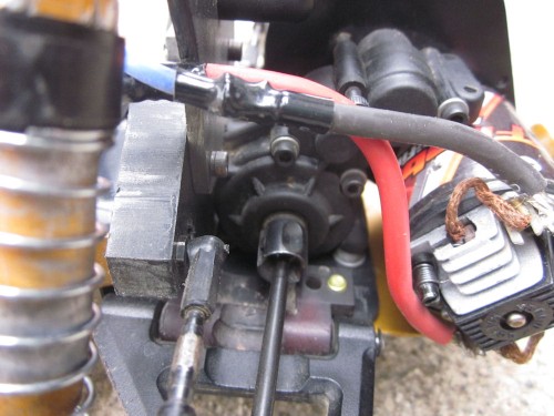

The core of the installation is a carbon plate that the trans is mounted to. I cut out the square hole in the carbon plate, and mounting screw holes for the rear of the trans. Added more holes to clamp the plate between the chassis and rear arm mounts. This also accomodates the slight height difference of the outdrives between the stealth and B4 trans.

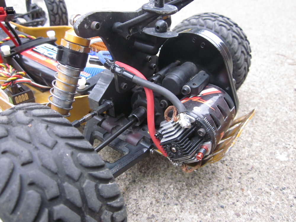

what brand of motor is this? Interesting head...
Paul
Paul
Re: B4 Transmission in Gold Pan
Motor is 17T Double Venom. Available at Tower Hobbies. I think it is one of the few brushed motors they still sell...
Heat sink looks cool, but terrible for alignment and brush fit.

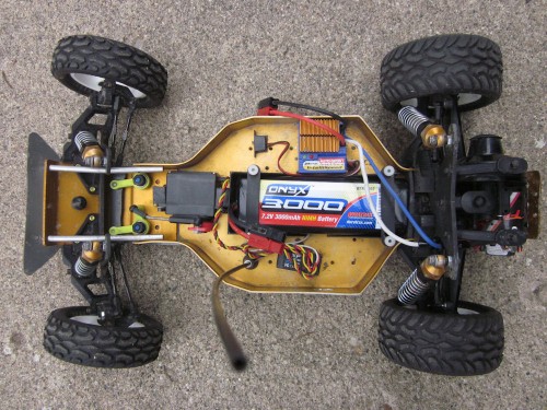

As sc8p mentions, bulkhead is where everthing attaches. It's the black piece with the rough edges The rear bulkhead is significant in this case for two reasons:
1. No longer available from AE or aftermarket
2. A modified/machined stock rear bulkhead probably wouldn't line up with the holes required for the front of the B4 trans.
As mentioned in the original post, the rear bulkhead wasn't too bad to make. I purchased nylon from McMaster-Carr, then cut it out with a wood band saw.
Only catch (you can see it in the pictures - top view), is the 3/8" nylon does not quite reach the chassis screw location. I tried to bridge it with an additional plate, but it didn't work. Next rev will either start with thicker nylon, then mill down. Or, start thinner with thick interface blocks (trans and front chassis screws).

Buggy runs pretty solid. With a 17TD motor and cheapie ESC, it is a dog compared to my other RC10 (graphite/10.5T brushless). Just using it for bashing around the house, and occasional trips to an outdoor 1/8th scale track.
I'm amazed at the difference between the graphite and the gold pan. Graphite is way more responsive, with lot's more turn-in. Seems to make sense as the pan has lots more roll inertia, but the difference seems too big for it to be the complete explanation. Pretty sure both cars are set-up the same, but probably need to dig a little further into shock positions, caster blocks, etc. Bulkhead link positions were directly transferred from the stock bulkhead.
No problems with the trans. B4 is much quieter than classic 2.25 stealth (even with recently replaced geartrain). B4 slipper is much improved.
BTW - Great suggestion from above on the xx4 wing mounts. Parts look like a great fit. With only one screw at each mount, the B4 mounts keep spinning around and loosening.
