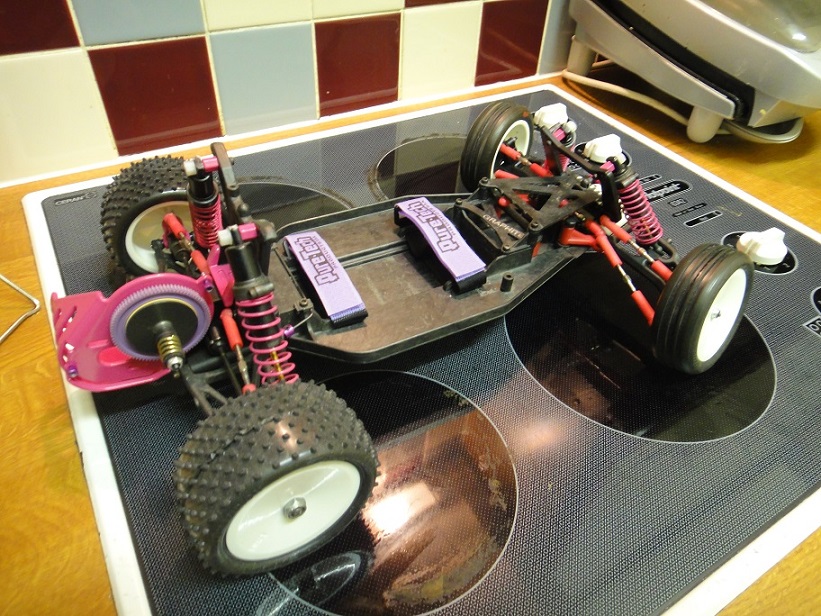

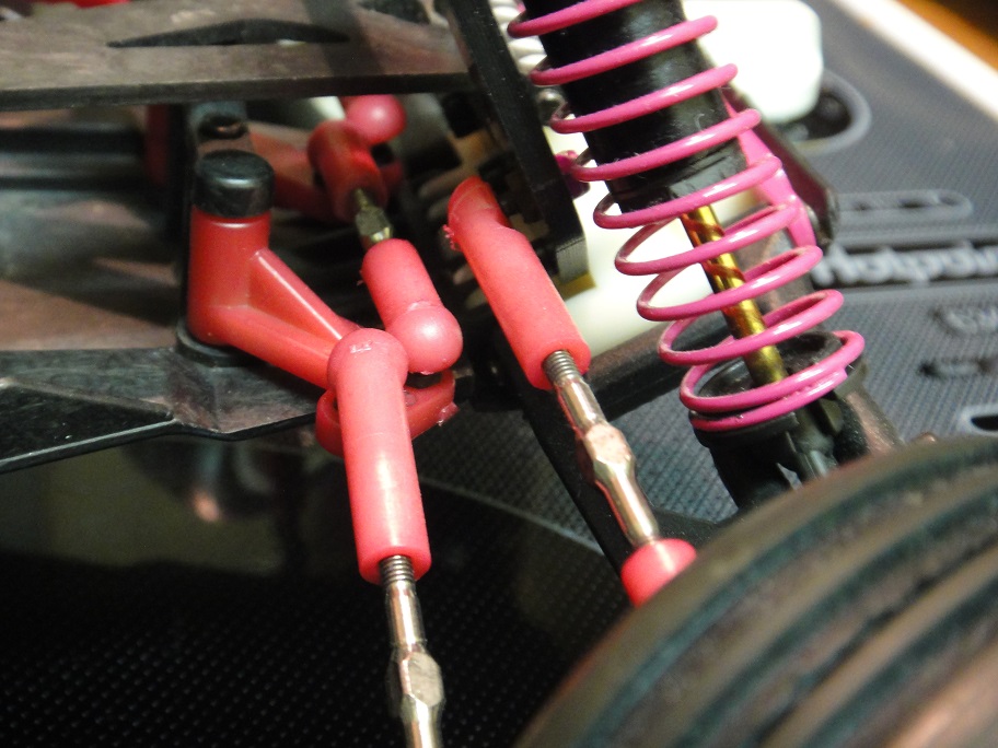

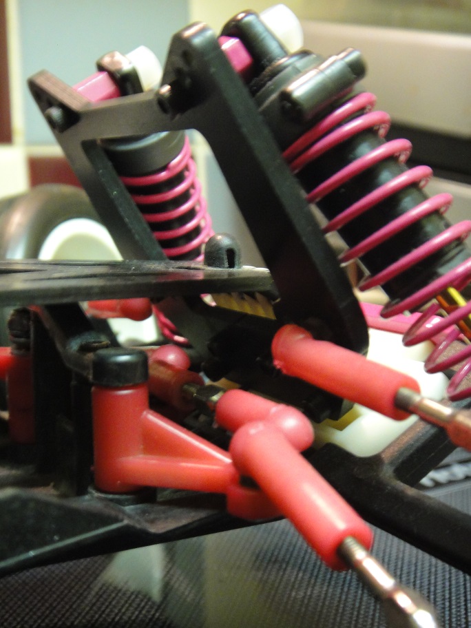

I gave this a shot a few months back. I wanted to dye some white/natural parts pink. I used rit fuschia pink.
Even though i didnt find a pink i really liked it was fun playing around with the dye, messing with the timings etc. I think i read in Derbydans yoke thread that the pink colour can be sharpened with a pinch of rit tangerine? Ive ordered rpm purple rod ends for this particular build. Contrasting purple is easier than dye matching the springs!
The steering assembly seems quite a hard plastic and visibly took longer to 'soak' the dye up in comparison to the other parts i had. Worth noting.
xx
xx
Not bright pink. Was scared to over boil them.
pinkish.....
pinkish.....

urpaldan wrote:I gave this a shot a few months back. I wanted to dye some white/natural parts pink. I used rit fuschia pink.

I didnt use salt from what i remember. The rod ends only need 3-4mins while the steering assembly needed around 10mins. If you keep checking them its easy enough to judge how long to leave them in the dye. I think it would have gone almost red if i had left it much longer.
