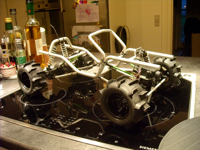

Details please.
EDIT: Also, what's that weird circle thing to the right of the refrigerator that looks a bit like a ship's wheel?
Just curious. And no, I'm not going to go into another string of pirate jokes...

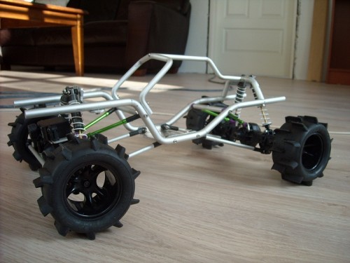

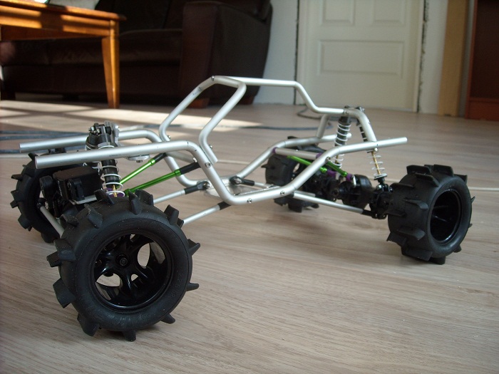

The "steering wheel" is just a railed slip proof serving tray V3.1
FOFF -

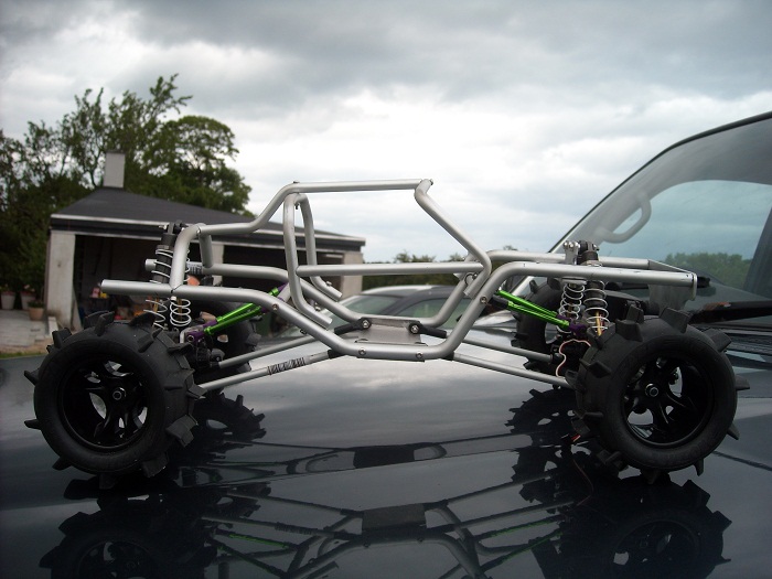

Main rails are 10mm alu rods. The "windshield" and roof is 8mm alu rod.
Axles, good and wide, are HPI wheely King.
Tyres are HPI and the rims are RPM Claw.
At the moment I´m trying to find a decent tranny and a set of long shafts.
I´m hoping for some high wheel rotation so I guess I´ll have to find some quality parts.
FOFF -

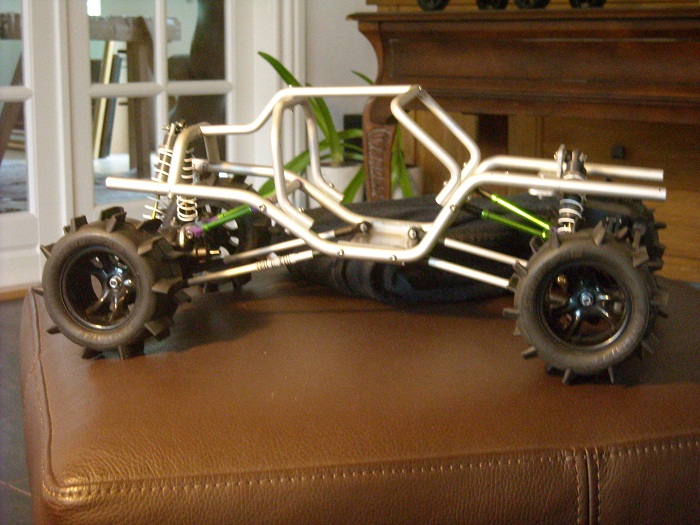

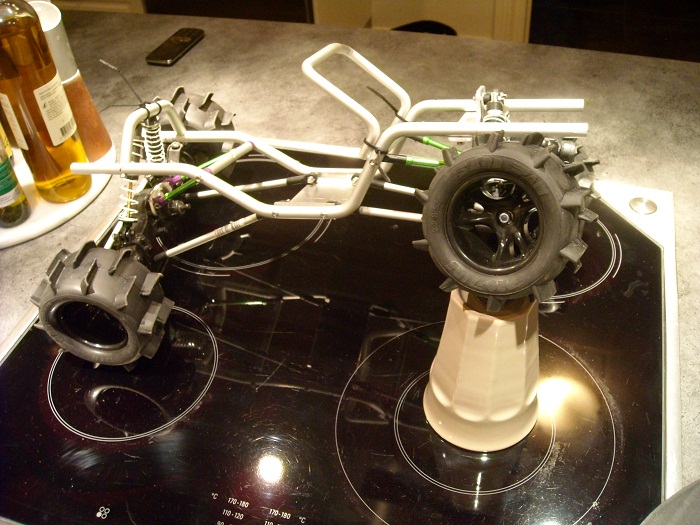

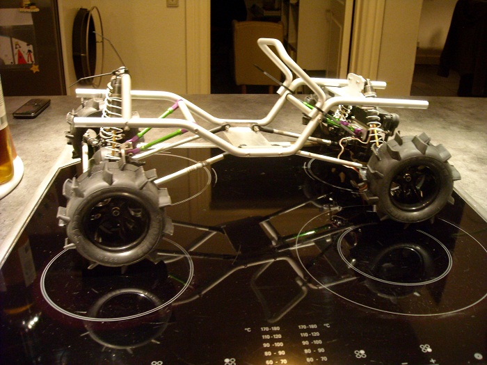

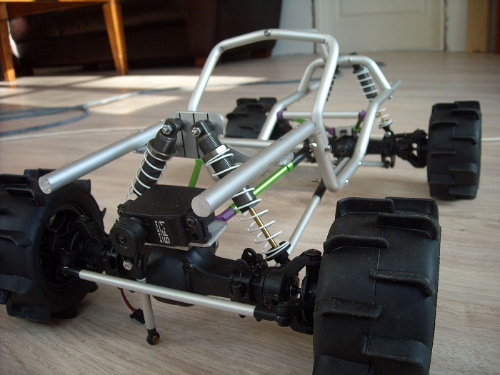

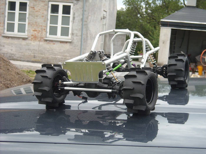

Yes, simple is a good description. It´s simple in a way that makes it hard to find the right shape of the door panels. I´ve done three attempts by now and I can´t seem to match the rest of the cage. So I think I´ll have to mount a crossbar instead.
Regarding the tie wraps (strips) - These can be seen at the three first pictures. A total of four is used - Two to hold the rear dampers and two to hold the "windscreen"
