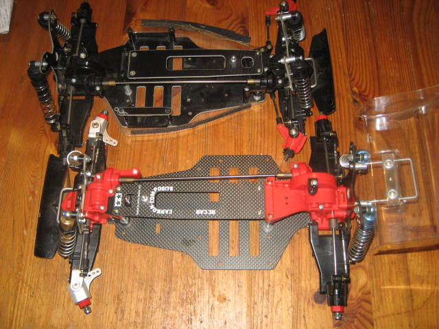

Here is what I have. The one with the red parts are 100% built but never been used. The black one is little used and in superb condition.
I have an NIB body set.
Jerzi
What mods are the best to get if I`m planning to use an 10,5 motor.
Jerzi
