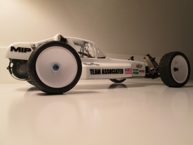

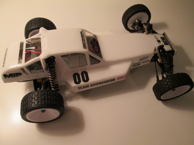

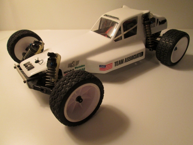

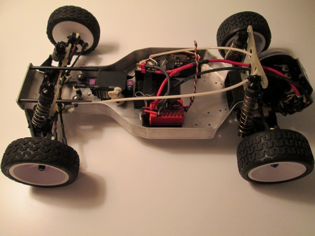

Long time no post... no builds. The real world has kept me busy. Sorry, I don't have any build pics. Imagine a severly beaten but straight black b stamp chassis, gold nose and lots of spare parts. The chassis was sanded and the parts were died black.
I am planning to run this in a local bomber class. The track is a clay banked oval. I still need to pic up a bomber body. I envy all the painters out there... I learned along time ago I can only paint a one color scheme. I plan to use the Devil's Bowl body if it will fit over the rear shock tower.

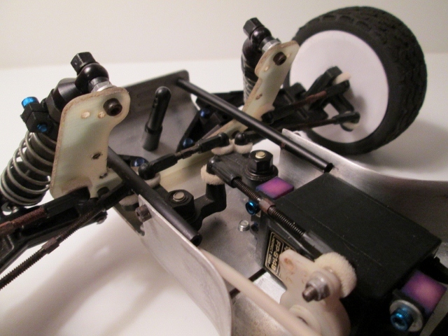

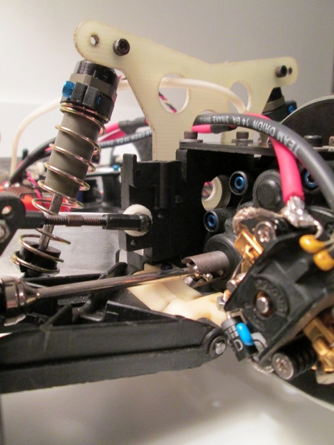

I set up the rear with 1.02 shocks, gold springs and 30 weight oil. I think a silver or green spring may be better. B2 CVDs, 3 degree 10T carriers, Phoenix rears and B4 fronts. Stock front shocks, silver springs and 30 weight oil. The only real hop up is the Houge steering.

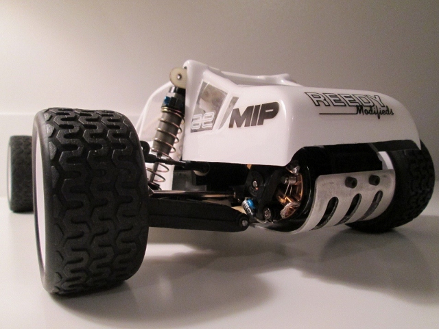

The class runs 13.5 brushless. I plan to pick up a 13.5 as my 5700 is a little too fast. Currently set up with a Cyclone and 12x2 Reedy.
Any set up help from the dirt oval crowd would be greatly appreciated.

You're off to a nice start. I was looking to set up one of mine to run dirt oval, and was debating SC10 front axles and knuckles (mostly for the tire/wheel choices.)

Heh how's the offset of the front with the B4 wheels mounted inside out like that? Would be funny if thats all it took to get the same offset as the old wheels and nobody tried it before.

Thanks Russ. I'm in Tampa and plan to run over at SS Hobbies. I wanted to make it over to the RC Asylum to check things out. I recall a couple of guys on the board running old school on an indoor off road track.
Phin, thanks for the link. The offset is pretty much the same as the stock wide arms and stock rims. I will post a pic, probably later than sooner.

Shorty got low low low low low low low... Nice! Those photos are kinda spooky too.
Or I just have Halloween hysteria...

You got the right tires for hard packed clay, you have the ride height for the cg. So you are good there. Now if you want more than old 30's mod coupe type body Gary at McAllister racing has some nice bodys that will fit the car nicely. Also I would suggest buying a spring kit so that you can work the setup and fine tune it.
Phin is right, the topic he linked to is steller for DO knowledge. Gl to ya and hope to see more from ya.
Last thing. Get some of the liquid mask and some good tape and you will be doing multi colors before you know it.
