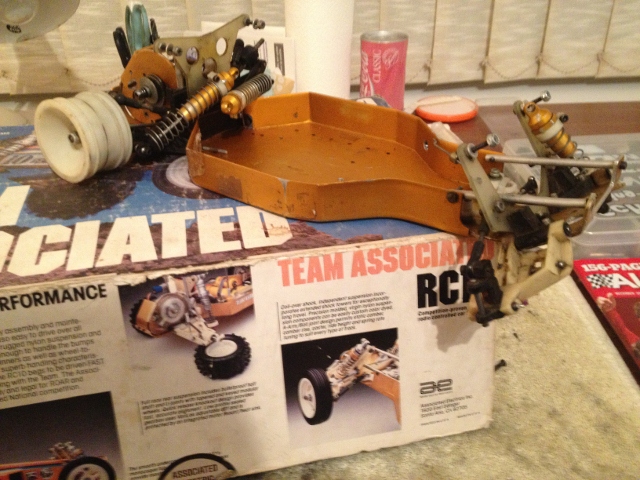

Re: Plastic part colour
Here's a pic of the "current state" Might commence strip down tomorrow.
