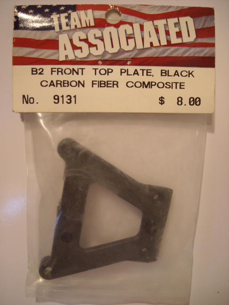

Been working on a B2 I picked up just have a few questions.
Did all the B2's have the skinny rear chassis plate or did late versions come with the extended 9241 plates? I have a Late B2 but it has the 9241 rear chassis plate with the updated 9267 rear arm mounts. Is it possible that it came this way from the factory, or were these pieces added later on in its life?
Also, has anyone seen a graphite B2 front chassis brace without the two sway bar mounting holes? Or did all the graphite braces have the holes?

yup
and to be a B2 it's got to have the narrow rear plate IMO :wink:

None of the B2's had a wide rear plate or sway bar mounting holes on the top plate. Only the B3 had these!

Tough to find the parts because you will find B3 style parts in header cards that read B2.
do your front arms have the sway bar ball mount molded in?
