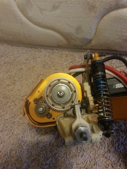

after doing as little digging and finding a lot of confusing information i decided to just try to figure some things out for myself . This is what i came up with on the first day. im not sure if anyone else has already done with , but it cost me less and $25 to do it. ive got a pretty good idea on how to use pieces off a modern AE slipper top shaft in the orginal 6 gear case BUT like all things some ideas don't work out to well , so we shall see with this.. i do have a good feeling though... more to come

just a heads up... that's a diff on the outside of the 6 gear trans, not a slipper.
Re: Pro-Touring/Restomod RC10
That's a spur gear.scr8p wrote:just a heads up... that's a diff on the outside of the 6 gear trans, not a slipper.

i prefer slippers pads instead of the ball diffs. I can either machine a slipper hubs(s) or modify an old topshaft. hope that clears things up for you.

OK now I'm starting to get confused. On the outside of the trans is that not a ball style slipper? the diffs are fixed to the output shafts which ride under the idoler and the input shaft which has a ball diff type mounted on the input shaft inside the case,no?
What I don't like is what I have always referred to as the slipper clutch being ball bearings on the spur. I prefer a pad type set up. My thoughts where to basicly adapt a pad slipper to the trans by turning down part of an SC10 input shaft, trim it then pressing on the correct gear or making a slipper hub with a smaller notch to fit the original shaft dia.

This is where the 6 gear Associated trans is a bit different than a more conventional 3 gear trans. On a 6 gear the differential is the spur gear, there was no slipper. If you hold the spur gear and turn one tire you will see it work. The gearbox is split in half with 3 gears per side which work independently of each other. If you got rid of the balls/rings and used slipper pads you would esentially be removing the diff and locking it.
lil_general_lee wrote:This is where the 6 gear Associated trans is a bit different than a more conventional 3 gear trans. On a 6 gear the differential is the spur gear, there was no slipper. If you hold the spur gear and turn one tire you will see it work. The gearbox is split in half with 3 gears per side which work independently of each other. If you got rid of the balls/rings and used slipper pads you would esentially be removing the diff and locking it.
Now don't I feel stupid! Took me a minute to work it out in my head with out looking at the trans. Now i understand how what i was planning on doing would not have worked out as i had planned. Well damn, downside is I have to rethink this, upside is I won't waste me time making modifications to the top shaft.

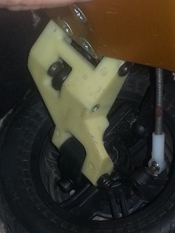

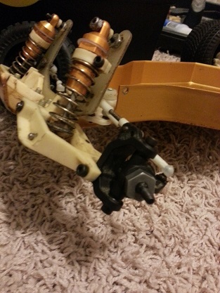

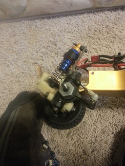

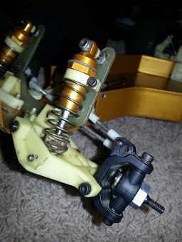

i am now calling this project OverKill ! i finished up my steering and did some clearancing of the front a arms to get to lock to lock and reworked my rear axels for the correct hex seating. originally i was using the stock axels but i found making drilling out the hexs to be a temp fix. now i am using Gen 1 HPI Blitz axels in the stock RC10 rear hubs. i only had to press in the proper bearing to use the axels . I switched over to a VTX8 and tekin 2650 t8 on my SC10 4x4 sooooo i thought what better place to put my Mamba Monster system than in my RC10. I was thinking i was genius when i decided to modify the top shaft of the 6gear trans but soon realized what everyone was trying to tell me about the spur also bing the diff. i soon decided to attempt to use the 6 gear and just make some mods. Again i thought i was a genius when i figured out the output shafts had the same size gear as the plastic idoler gear..... then i remembered i read it on this fourm first! so i cut down some worn out drives and now i have metal idolers. i am also using a steel pinion and spur and i did ditch the ball diff. what i am using now is garolite discs . as they heat up they get "tighter" its a quasi diff but it works very well with this 2650 . i have a few more things to do and test out before i rip it back part and rebuild it with my keeper parts. i have 2 more transmission types to try out before i decide on which one, i am just wait for parts ...... as usualy

i am using 2 2lp packs for the 4c that is required for the 2650 . i will be looking into a thinner 4c pack because i do still want to run a buggy body
