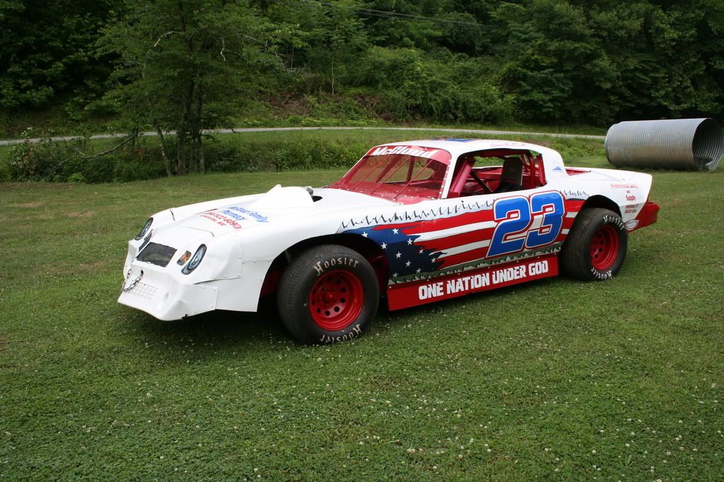

My Apology, By "Sportsman", I was thinking in terns of the car style, (I think.)
This:
Something that looks like the 70s street cars. Not the Wedge style cars or sprint cars.

you need to figure out where you'll be racing, and find out exactly what the rules are. around here it's street stock that runs the camaro/monte carlo bodies (from mcallister), you must run an rtr rc10 b4, and there is only a few mods you can do to it.
it's designed to get people into dirt oval racing, and try to keep the costs down.
