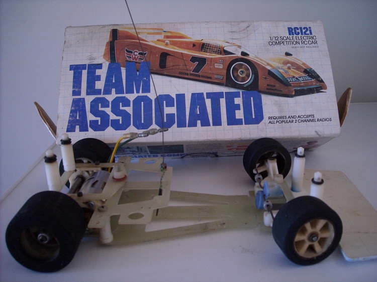

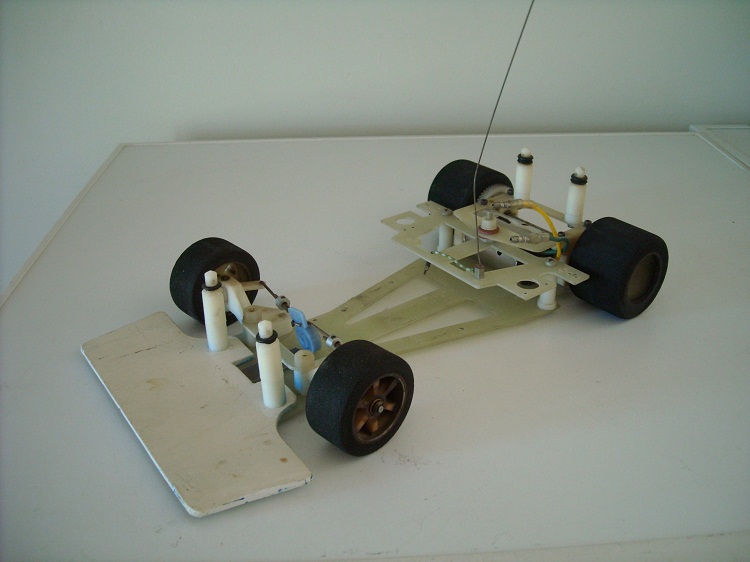

A quick question -
The first 1/12th onroad I drove seems to be an I model. I´ve purchased this one from memory, but I remember the radiodeck to be longer. Did someone cut the radiodeck or did it come in this variant aswell?
A couple of days later I went to pick up a well used PB mini mustang with a boxfull of parts. Oddly - the parts box, was a RC12i box.
The body on mine was a C-group in purple, white, yellow and orange, with a dark silhouette of a city, on the hood, with a flying dragon above. Has anyone seen anything like that?

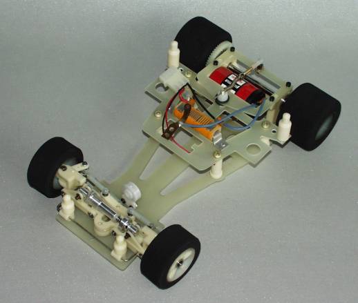

Re: RC12i
Many thanks,
The one in Your picture looks very opmized - is it all ae parts?
Is it still possible to find a topdeck or will I have to mount the battery on the chassis?

Re: RC12i
I believe you have an RC12e bumper which is much bigger than the RC12i bumper and you will need 2 standoffs for the correct top deck and appropriate screws top and bottom. This is what the front end needs to be original.

Re: RC12i
Isnt that an early car? Looks like it has the front end cutouts and no spring front arms. If that's the case, it doesn't need the front standoffs (although they do help for a runner). Not sure on the big bumper, I thought all 12i's had the small one as mentioned above. If you can't find an original, reign79 makes reproductions that look great! My upper decks are all newer gen that use the front standoffs but they seem to be hard to find

Re: RC12i
gomachv -
Mine has the cutouts at the front like Yours on the first picture.
And no spring on the front.
What is the long black stripe for on Your late chassis? Mine seem to have a small piece of that at the front.
Thanks -

Re: RC12i
the early cars had something there, mine just does not show it. The early ones were Kydex, and used as Chassis damper. On the middle and late cars they turned into a carbon fiber piece To make the chassis more rigid and allow the front suspension to work
