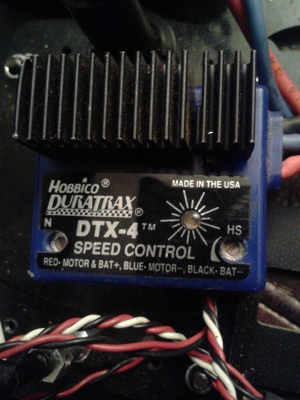

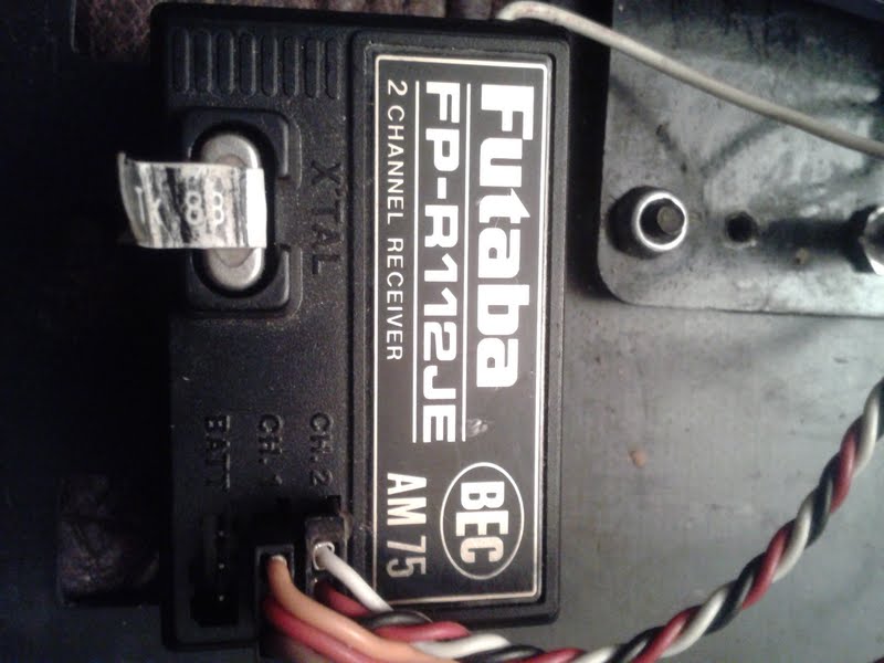

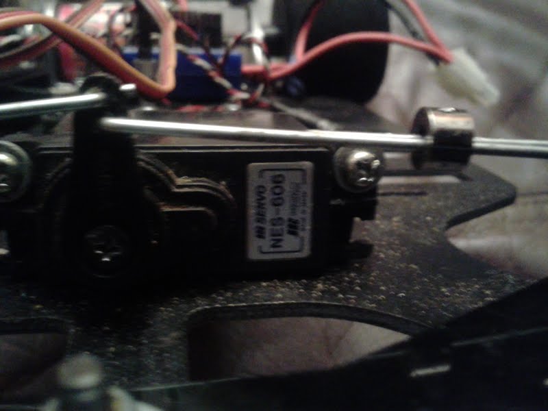

the battery I use is either a six or seven cell old NiCad battery. As for the motor I took it apart and cleaned it and replaced the brushes. The esc servo and receiver are just ones that I had laying around. and when I do hit the throttle the wheels stay straight its just the rear that is flipping around and spinning it out so I don't think it is erratic servo behavior. here are some pictures of the electronics.
