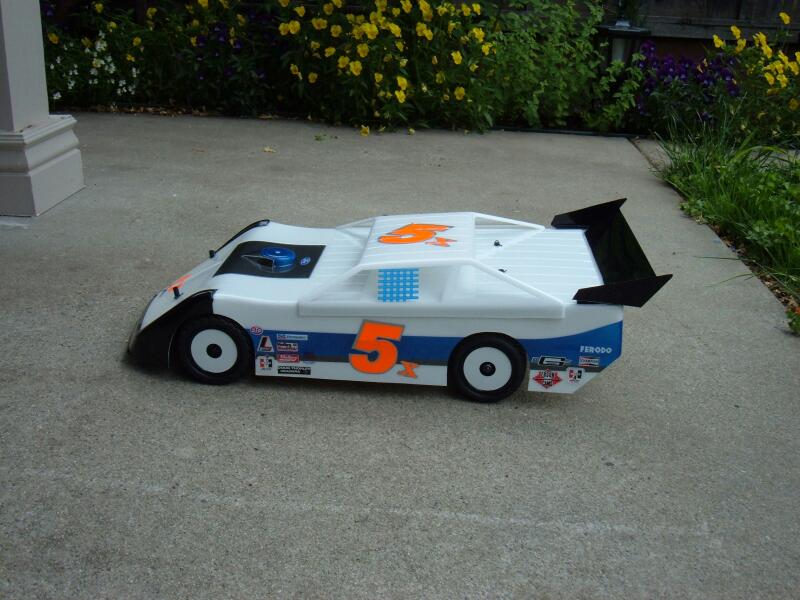

Not exactly an SC10 but a close relative, a B4 converted to oval using speedys parts and a custom works body.
Re: SC10 To Dirt Oval Modified or Late Model
Cool, I also have a FTB4.1 I have sitting on a shelf I built but never ran, what is all involved in this conversion?RC10th wrote:Not exactly an SC10 but a close relative, a B4 converted to oval using speedys parts and a custom works body.
