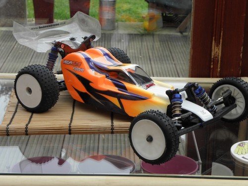

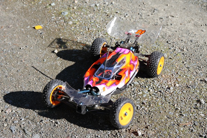

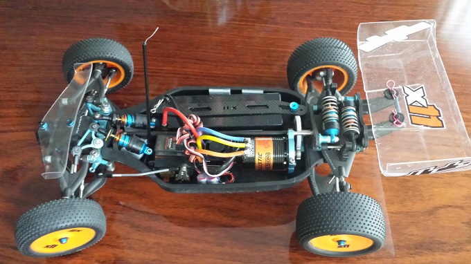

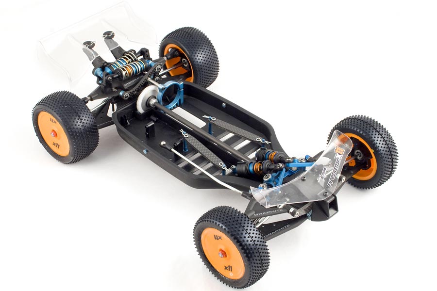

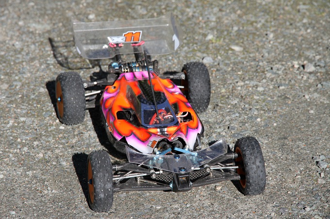

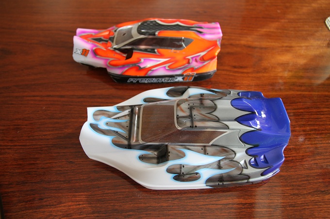

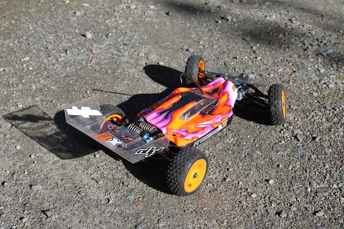

This spring/summer (2013) has been dedicated to my X11! Until this year my runners have all been vintage (well at some stage, over twenty years ago now, I actually drove modern cars). Although I have driven a few of the later rides I never had one myself. The change came this year getting a Predator X11 to use as my "modern" runner in 4 wd despite the B44.2, K1 and XB4 +++...
You may very well think the X11 is outdated. The car is very similar to the original Tenth Technology Predator and I have the feeling the Predator X11 already is history and the last version of this platform. One could say this is more of a what-is-new-is-actually-very-old kind of car. So far it’s still available at £430 :shock: I'm an idiot? Maybe, but despite the price, weaknesses, expensive parts etc, I just love this uk jewel. The basic platform has been around since -93, so going for a "new" X11 I'm sort of having my feet both in the modern and vintage world. The first versions had hand made carbon fibre tubs, with unique serial numbers! Today it's a molded graphite tub. The Predator has been made and sold by Tenth Technology, the later X11 by Team Xtreme – now famous for the Vega kits.
And yes I’m satisfied with the performance – if the jumps are not too high that is… I suppose this is not the place for a detailed set up, so along some course lines it goes like this:
Electrics:
TX: Spektrum DX3R, RX: Spektrum SR3100, Servo: Savox SC-1257TG, ESC: HW V3.1, Motor: Novak 8.5 or Vampire 6.5.
Chassis:
X-5 wing (X Factory)
Optional one way prop shaft.
Custom steering layout.
I have both the saddle pack chassis and the lipo. Currently the saddle pack chassis with LiPo stick pack. The car has a custom carbon strap with the logo engraved, for holding the battery in place. The install of the electrics was is a bit tight and the preference for the HW V3.1 is actually due to space and wire configurations. Next season I’m aiming for a shorty along with the esc on the same side.

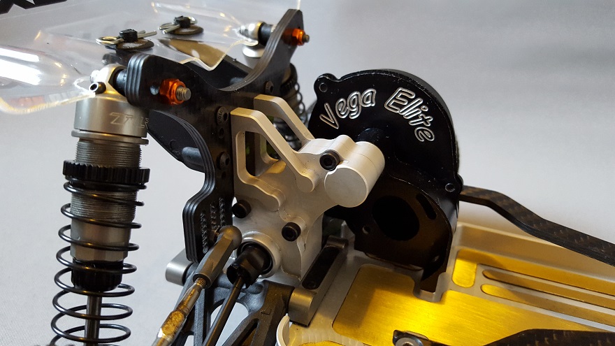

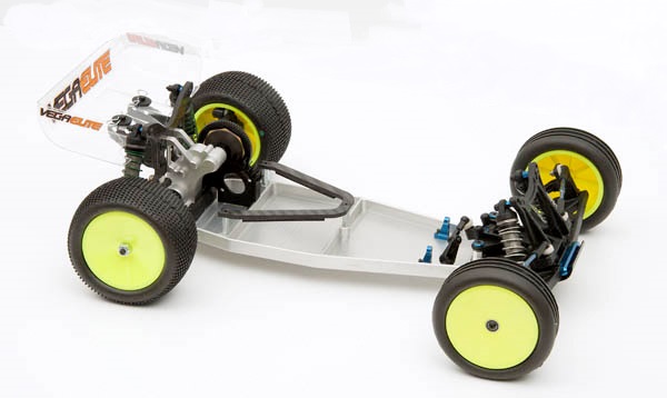

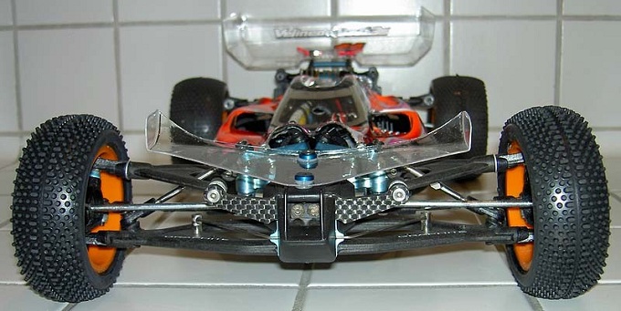

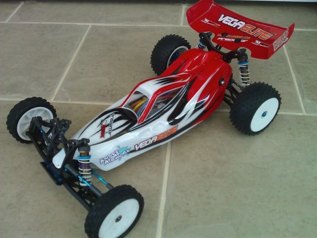

Team Xtremes “Vega Elite” 2WD race conversions were made for several of the top-end race buggies (AE B4.1, Kyosho RB5/6, Tamiya TRF201, TLR 22). Featuring a CNC machined 7075 alloy tub chassis & gearbox, motor plate heat sink, rear shock tower, bodyshell and more. Team Xtreme claimed better cornering, increased in-air control, more level jumping, quicker landings and “a new more positive feel to the car, allowing for a more aggressive driving style”.
GEN 1, introduced Jan/Feb 2011, standard wheelbase. (RB5, B4.1, TRF201)
GEN 1 Body
GEN 1 AE B4.1
GEN 1 Kit (This one for the RB5)
VegaElite GEN1-3-400x296.jpg (23.15 KiB) Viewed 5541 times

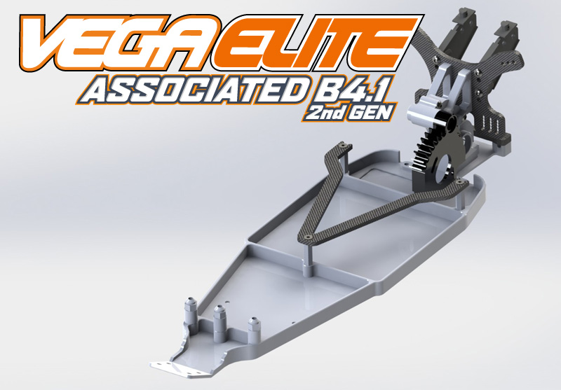

GEN 2, introduced August 2012, got a longer wheelbase, raised gearbox (2mm) and multi cell layout. (RB5, B4.1, TRF201)
GEN 2 Body
GEN 2 AE B4.1
GEN 3, introduced June 2013, gear diff compatible gear box, side flex tub with weight slots for the optional brass weight kit (RB6, B4.1, TRF201, DEX210, TLR22)
GEN 3 Body
GEN 3 Optional weight kit (This one for the TRF201)
For more details on the GEN 3 see next post on my conversion for the TLR 22.

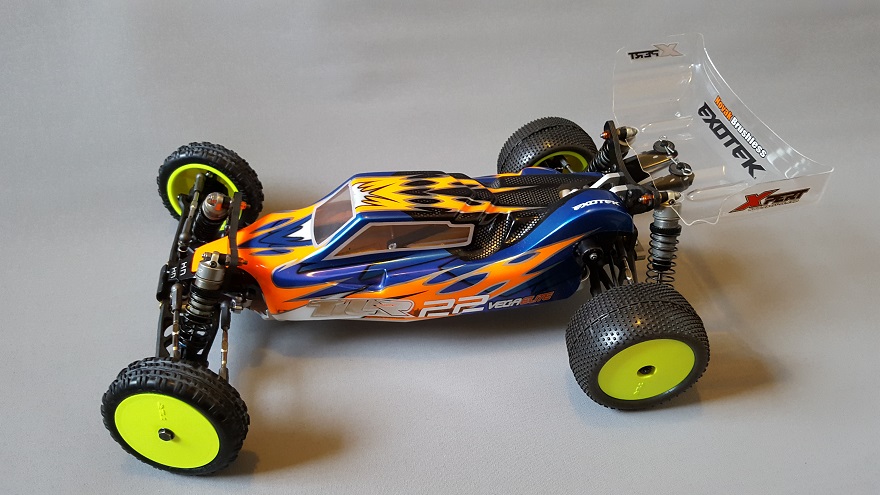

My Vega Elite GEN 3 for TLR 22.
Initially I started out using this as my modern 2WD runner. As things are with Team Xtreme nowadays (no parts available) I've rebuilt it to freeze it as a document of this platform.
I really love this car, the finish and design of these parts are very good! Everything bolts in perfectly - if you've tried out a Vega Elite kit you'll know what I mean.

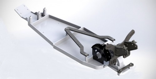

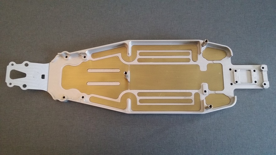

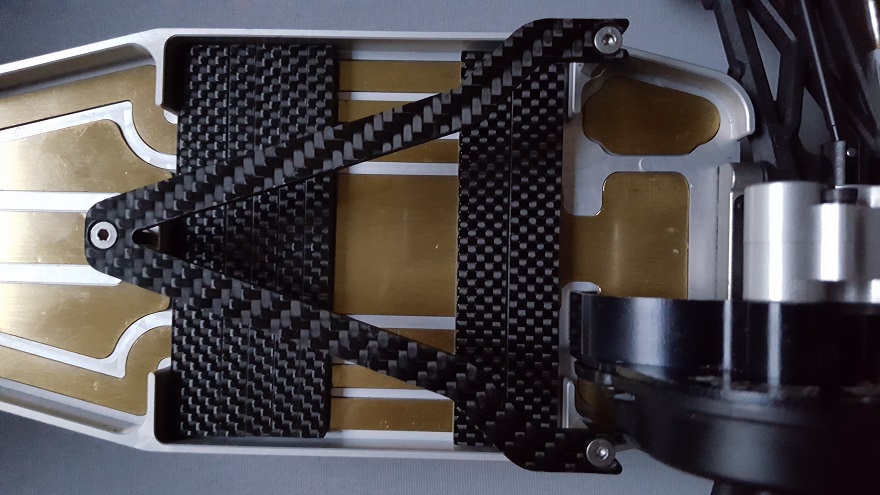

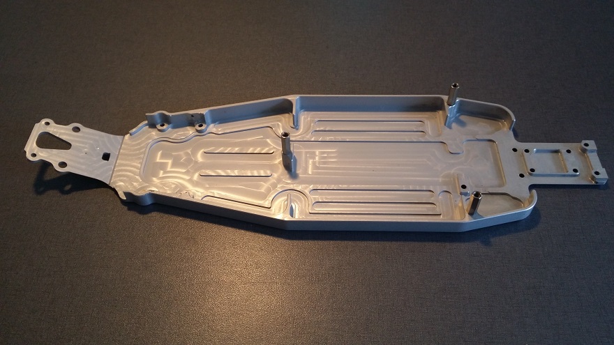

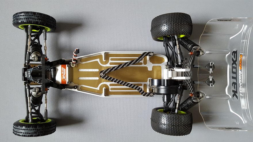

The start - Vega GEN 3 chassis
Chassis with optional weight kit. This I think is a piece of art :-)

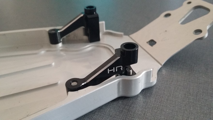

Hot Racing alu servo Mounts

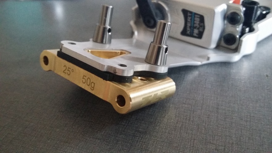

Team Losi Racing 25° front brass pivot (50g)

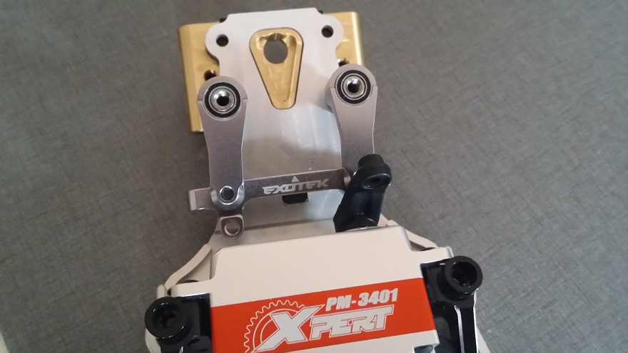

Exotek steering VER.2

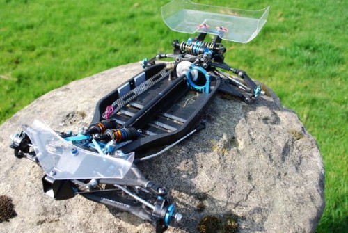

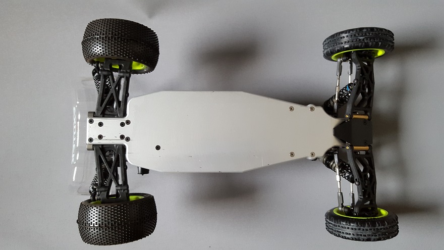

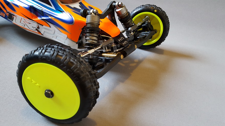

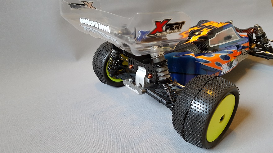

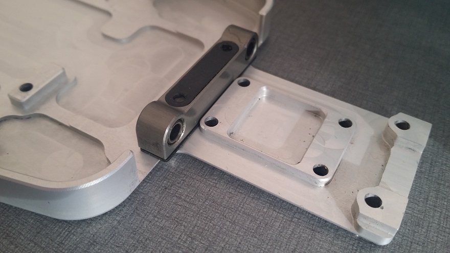

Rear end. For this mid motor conversion you need to use the plastic insert from the rear motor layout to bolt the front hanger and anti squat shim to the chassis, as the block is not sandwiched between the gearbox and chassis plate as usual on the standard mid motor 22

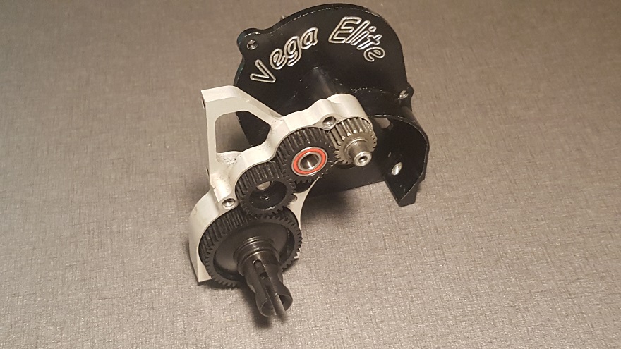

When driving this car I used gear diffs, both AE and the losi one, not being happy with any of them. For the shelf now rebuilt with ball diff - at least I know it's in there...;-). Gear box built to standard specs with HDS slipper clutch and grooved slipper plates
Vega Elite machined gear box. As you can see the motor to axle position is tighter than standard so that the diff sits far back in the wishbone.

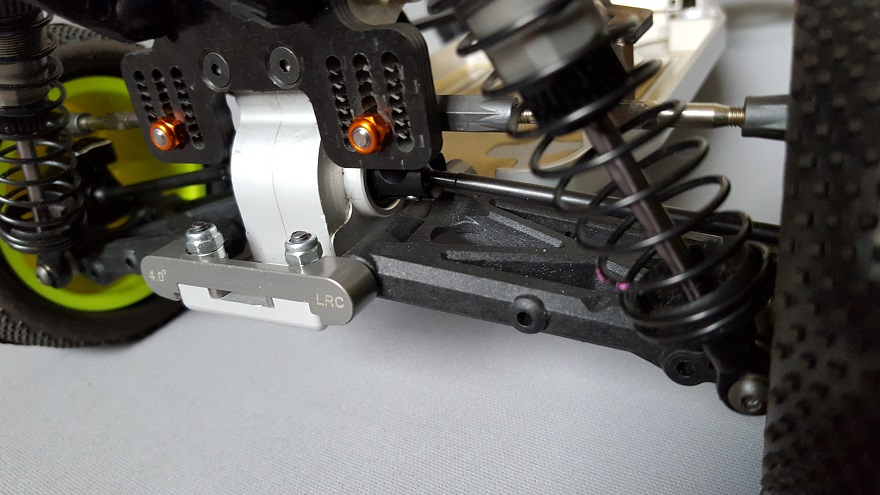

To get the motor back and maintain a sensible amount of driveshaft sweep the rear wishbones need to be flipped (left to right/right to left) to make room for the motor further back. Both the washers/spacers are put at the front of the wishbone so they are spaced back as far as posssible. The ball stud on the hub should be placed in rear row to achive a straight line. Also fitted with 4⁰ low roll center toe plate, Hot Racing aluminum rear hub carrier and aluminum wheel hex +0.75

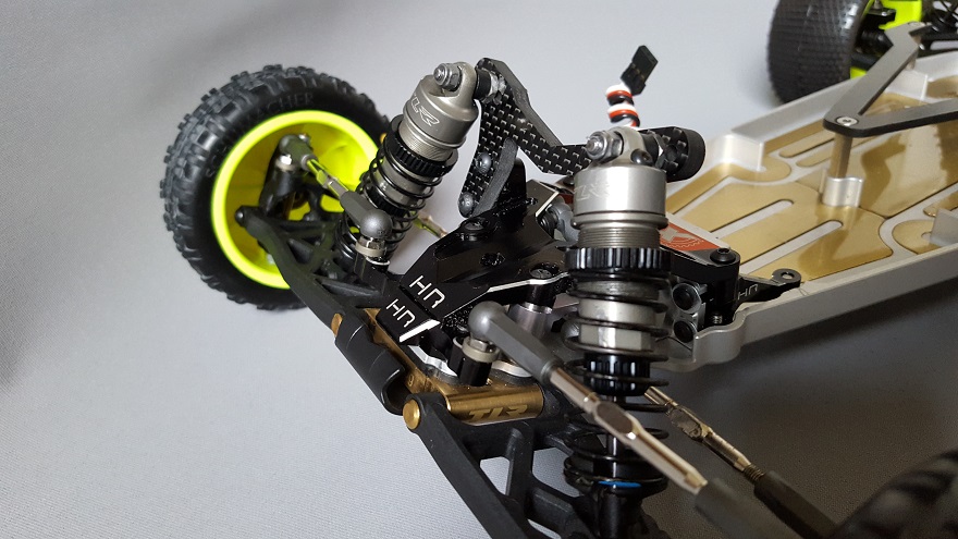

Front end with Hot Racing aluminum front bulkhead and camber block. Exotek 5mm carbon front tower. Trail = 4mm offset, Caster angle = 5⁰, Kick angle 25⁰

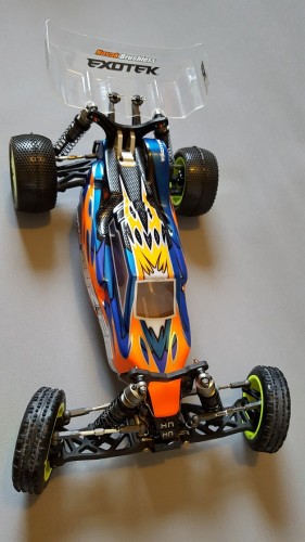

My Vega Elite GEN 3 for Losi 22 continued...
Got FIBRE-LYTE to make some battery spacers for different configurations with saddle and Shorty.
Finished car without electronics - ready for shelf life (a bit sad, but I really want to keep this one as is)
