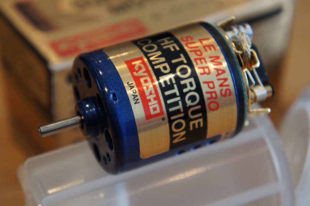

The Le mans Super Pro motors were released in 1993 and might be what your looking for. There were three of them. This is the HF Torque motor which is a 13 quad.
The other two were Speed motors. But if you're going to shelve it and only drive it occasionally I reckon one of the earlier motors would be better as they have less grunt and also look a lot prettier with the cool anodizing.Chris.
