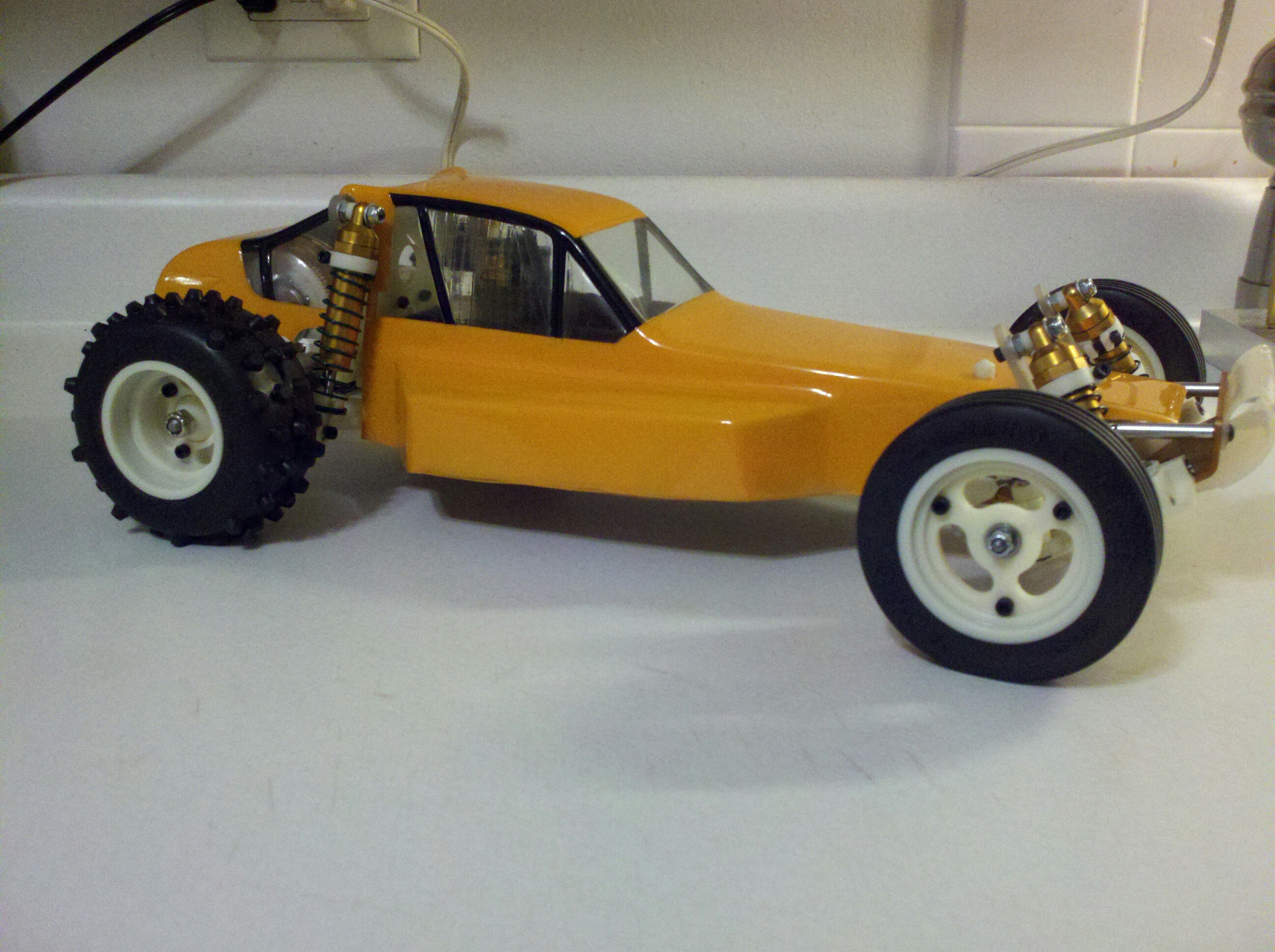

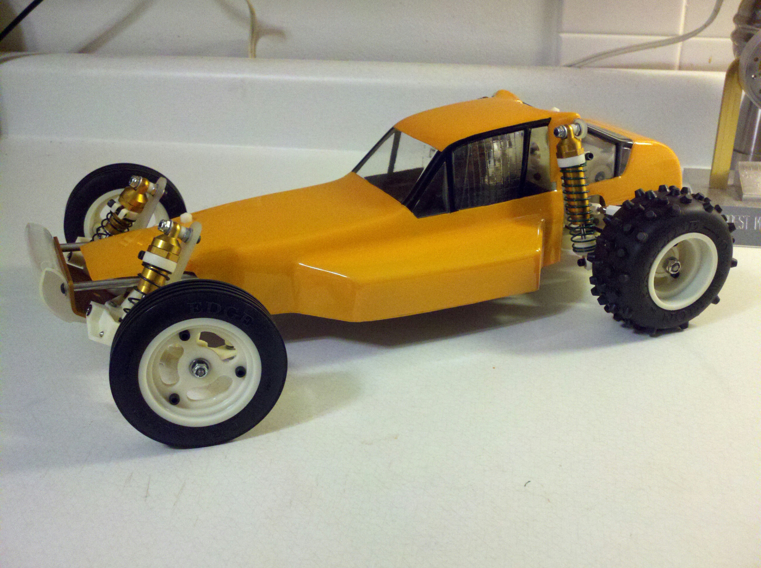

here it was after i got it put together the first time. i made typical mistakes such as not re-drilling the front shock tower and only putting the 2 spacers per manual in the rear shocks.

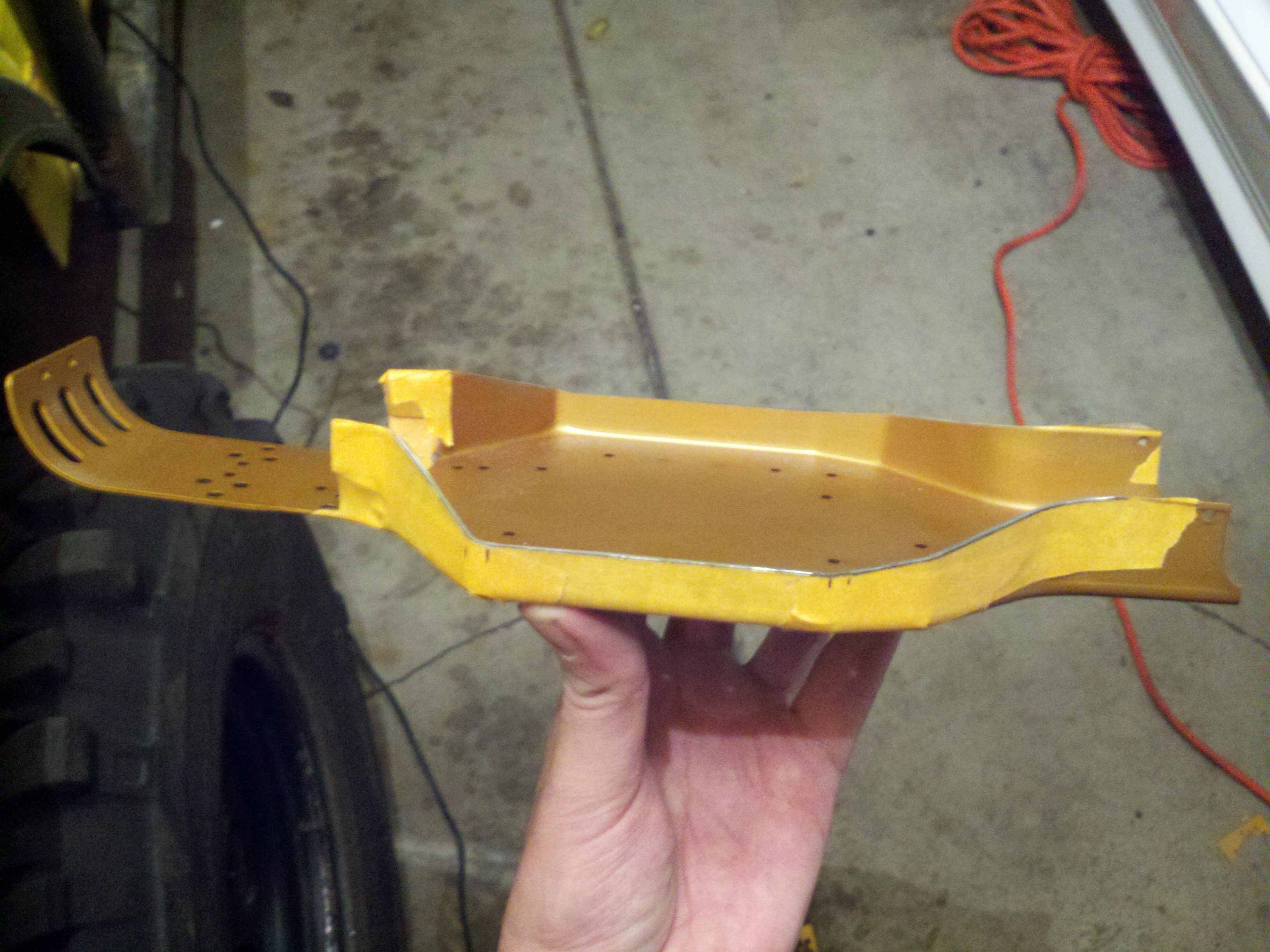

a little siebenslamming. cut out half an inch on the tub.
nicely done if i say so myself... level, even, didnt slip with the dremel and mess up the annodizing.

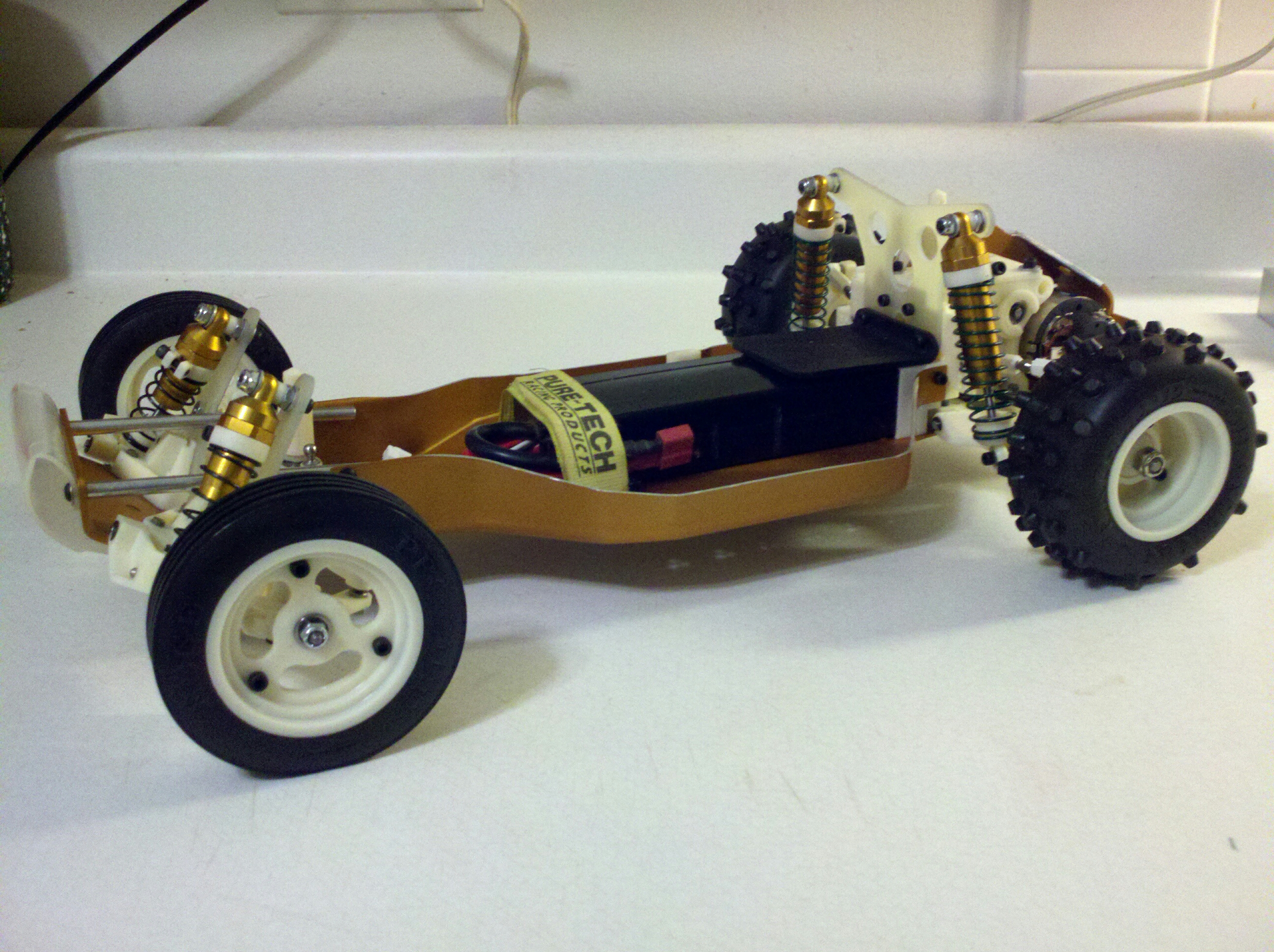

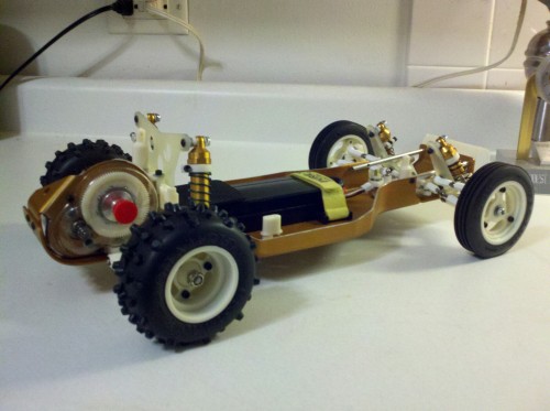

like other things, a little trim really improves the look. cut sides of the chassis really let the body fit a whole lot better too.
need to order up the elecs and get it running. i think ill do the funco lid with a boxart theme. ;)

That does look pretty sweet cut down, and your right. It does make the body fitting look better, Low and fast! :D
I wish I had the patience to cut the chassis like you did. :(

its pretty easy to cut the tub. i just used a dremel with some cutoff wheels, then cleaned it up with a file. i didnt cut through on the first pass, i just went along my marked lines and cut a little deeper each pass.
after i had measured and marked my cuts, it maybe took 30-45 minutes with the dremel.
and while its relatively easy, its pretty damn intimidating doing it while trying not to mess up. ;)
