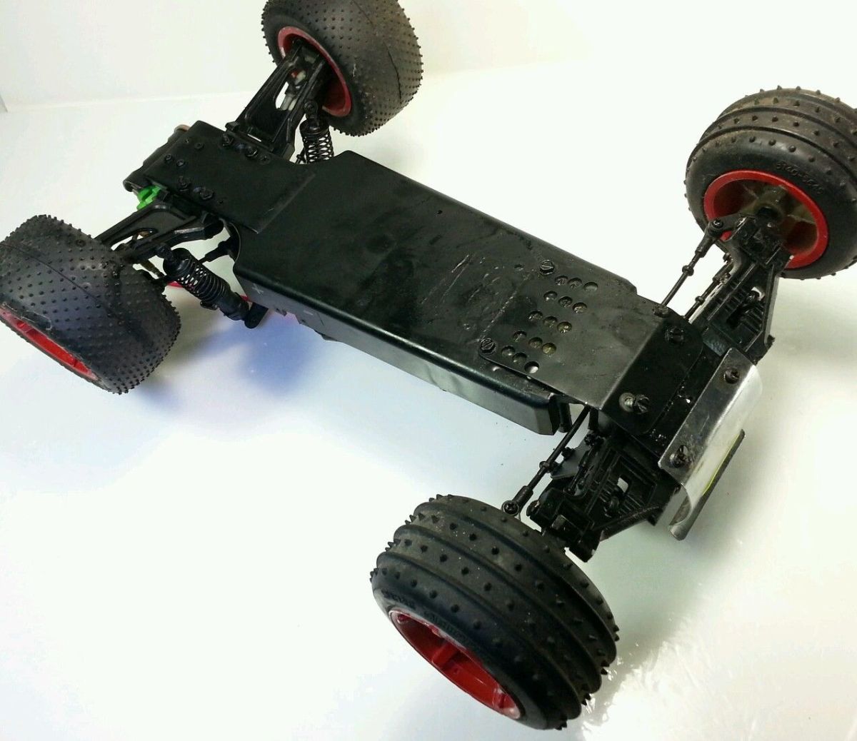

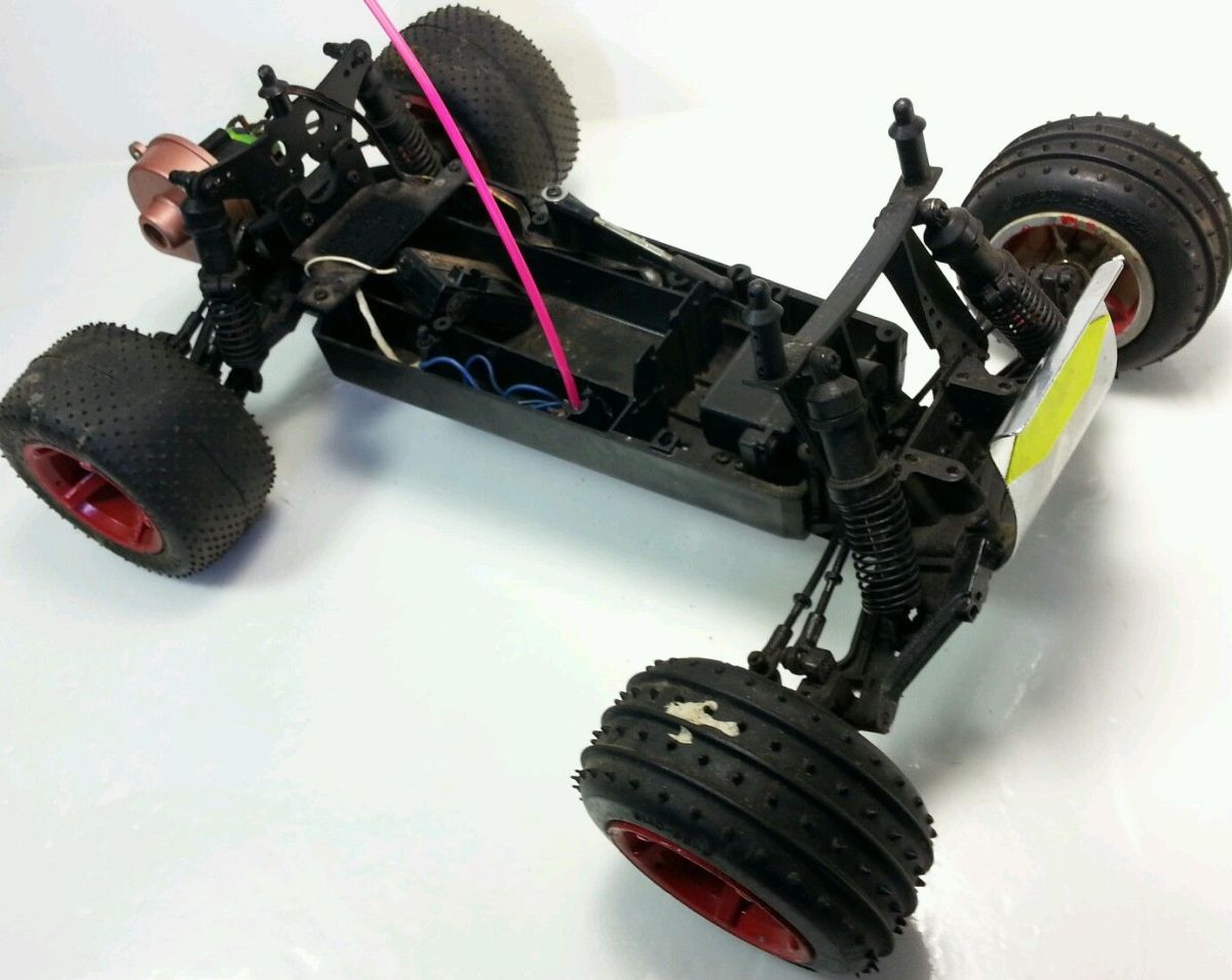

It occurred to me that I can post the ebay pictures.
The pictures speak for themselves, but I have a few questions.

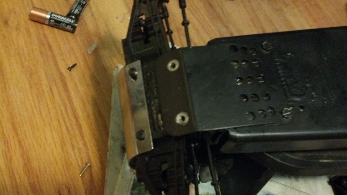

I noticed that it's missing the fiberglass brace from the bulkhead to the chassis, and it's also missing the battery hold down. Could I make those parts from fiberglass?
Obviously the home-brew aluminum front bumper needs to go. I'm thinking my extra RPM one for the Rustler should fit.
The seller said that the whole car is covered in black paint. Maybe there's still white plastic under that paint?
I've heard that the plastic gets brittle with age and I'm planning to use the car as a light runner, possibly a resto mod. I'll probably boil the plastic to bring back some flexibility.
Is it just me or do the early Traxxas models all have Rc10 caster and steering blocks?

Judging by the missing top brace and that home made bumper/skid plate, I'm gonna take a wild guess that the chassis is broken right where the kick-up is. Typical for those trucks. Hopefully that's not the case, but it's very common.
I had and may still have the top chassis brace. Also have a good used original front bumper if you're interested.

The chassis is still available as well, under $12 at tower and comes with the braces

I saw the chassis, but it's out of stock on Tower and almost everywhere else. I'm not sure if it's actually coming back.
There's one left on Amazon, I might snag that one.
Alternatively, could I clean up the spot where it's broken and attach a Rustler/Stampede/Slash/etc. bulkhead?
Thanks for the offer on the bumper. I might take you up on it if the Rustler bumper doesn't fit.

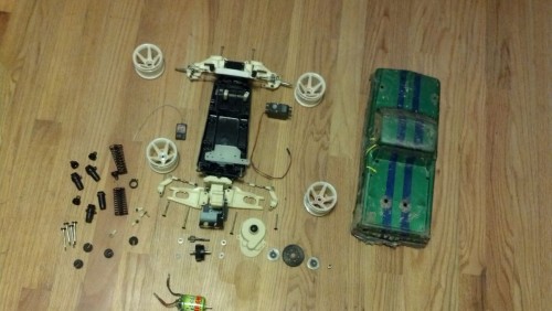

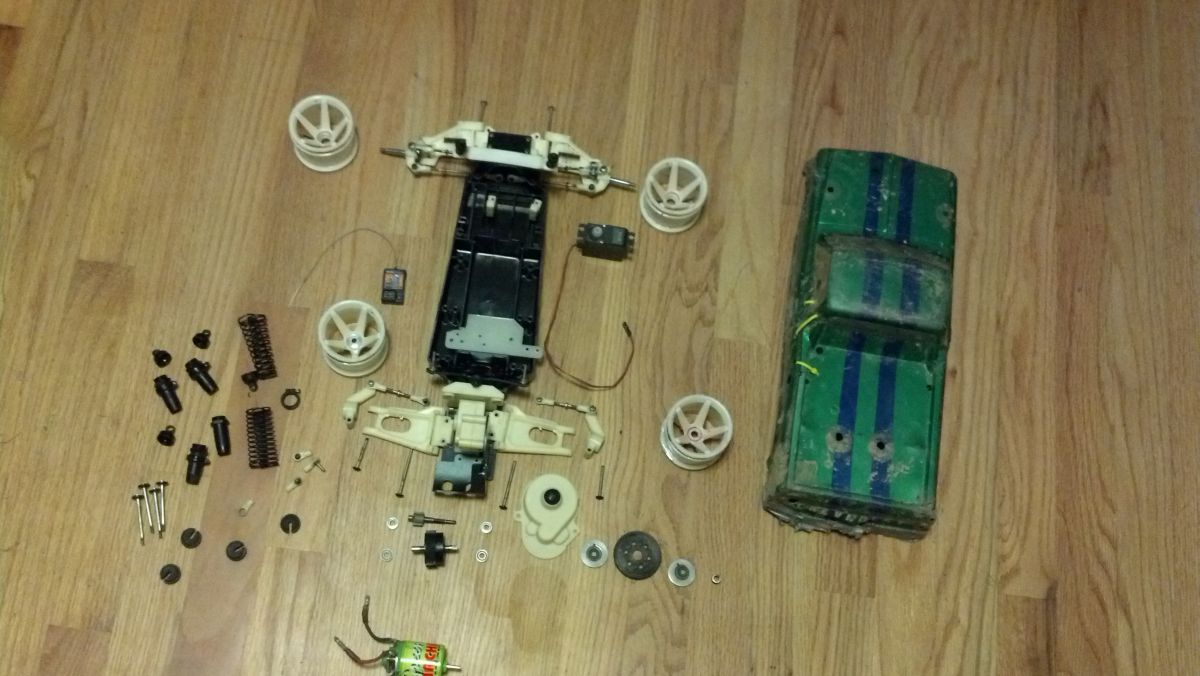

I got the car this Sunday! USPS didn't hold the mail.
I'll post pictures soon, I've been busy with it.
There's nothing wrong with it that wasn't apparent from the pictures.
It came with a Trinity Green Machine motor. I need to decide if I want to run it or sell it.
It has a Hitec Hs-311 servo. I might use it, it looks adequate on paper. Or, I might put in my Solar D771 instead.
I opened up the transmission, everything looks good. The gears have zero wear, the two topshaft bearings seem new, and even the oillite bushings on the diff and idler seem new. I find the transmission's pristine condition bizarre considering it came out of a 1992 car with a broken chassis, several important parts missing, paint all over everything, and badly done home repairs.
I've stripped the chrome and red paint off the included HPI wheels. I'm going to dye them black and reuse them, probably with ribbed tires up front and Calibers in the back.
The chassis seems discontinued, it's out of stock virtually everywhere. I snagged the last one off Amazon.
Now I just need a front bumper and I'll be able to get it put together.

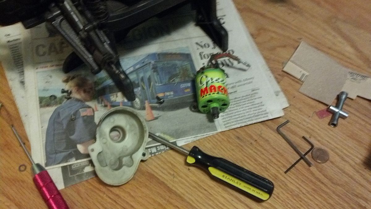

At this point, the parts are almost stripped of paint. I've been using acetone degreaser with good success. I'll post pics of the parts soon. I still need to decide if I'm doing the peroxide treatment before I boil them.
Any input or advice is appreciated.

I thoroughly cleaned the motor, lubed the bushings, replaced its brushes, sanded the contact points on the springs, broke it in, used an eraser on the comm, and cleaned it again. It should run well. There's something I like about tinkering on a brushed motor, even though brushless took over before I even got into the hobby.

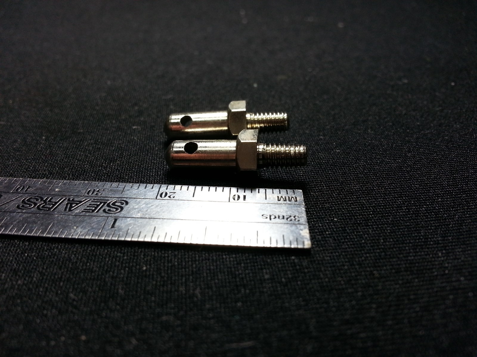

Another problem I've run into is that I can't find battery posts that fit the chassis. It uses m4 screw holes for the battery posts.
I see you have battery posts. Do you know of any currently available battery posts that will fit?
I'm planning to keep the original shocks for now. I found my seals and I hope to get by Hobbytown today to buy new bladders.

Yes, I saw the ones on ebay. I'm looking for ones that don't cost $12. Thanks though.
