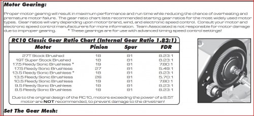

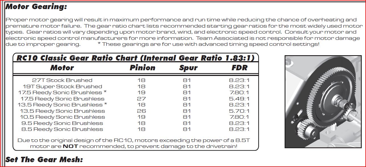

For my 6 gear Lars, I have a non-boosted (blinky) 17.5 geared 87/23, and the timing turned up just a couple tics (half way to "hot"). The FDR is 1.87 x 3.78 = 6.9.
I just noticed the Classic manual page 20:
The call the internal ratio at 1.83 (I thought it was 1.87
). They also say you can run 5.49 at the rear wheels with an unadvanced speed control and a 17.5.
So it's whatever works I guess...like Coel said.

Thanks Brian, just the answer I was looking for! Recommended 7.80:1 and you are down to 6.90:1, this will be good starting point for my Turbo Scorpion at the Nordic Indoor Vintage Challenge

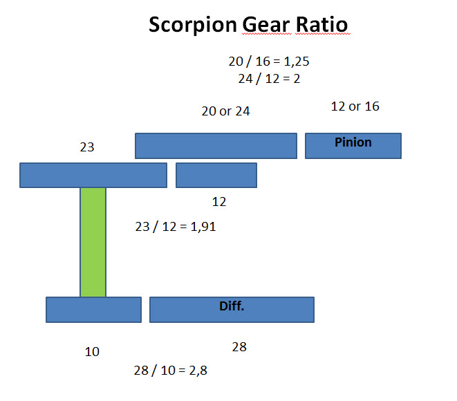

That's good...do you know the Turbo Scorpion's internal (transmission) gear ratio? I could research it but if you know, it would save me time. Note; the RC10's numbers aren't going to be the same as the Turbo Scorpion and therefore ideal gearing recommendations would be different.Hcp22 wrote:I will run slick tire that are 83mm in diameter, a standard indoor tire in Sweden on my Turbo ScorpionCoelacanth wrote:That would depend on other variables you haven't mentioned; at the very least, what car you're racing, as that determines what your internal gear ratio is. Another factor like tire diameter can also play a role in calculating a suitable final gear ratio & rollout ratio.
Lars, is that an exerpt from my gear ratio calculator spreadsheet?

That is actually my own, but you help me with the internal gear ratio and I did it more visible.Coelacanth wrote:That's good...do you know the Turbo Scorpion's internal (transmission) gear ratio? I could research it but if you know, it would save me time. Note; the RC10's numbers aren't going to be the same as the Turbo Scorpion and therefore ideal gearing recommendations would be different.Hcp22 wrote:I will run slick tire that are 83mm in diameter, a standard indoor tire in Sweden on my Turbo ScorpionCoelacanth wrote:That would depend on other variables you haven't mentioned; at the very least, what car you're racing, as that determines what your internal gear ratio is. Another factor like tire diameter can also play a role in calculating a suitable final gear ratio & rollout ratio.
Lars, is that an exerpt from my gear ratio calculator spreadsheet?Glad it's getting put to good use!
