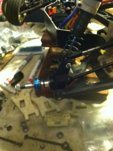

So after all the various ways to run 2.2 wheels on the rc10 have been hashed out and AE now has 2.2 wheels with the correct offset available, i have one more tedious wheel mod to add to the list so you can run b4 wheels with the correct suspension parts. The reason i did this is because all my cars run b4 wheels and i wasn't happy with how the team car ran, the camber gain seemed wonky, and drilled out hubs developed to much wobble. so here is my recipe:
losi 22t mip axle
b3/b3 cvd bone
avid 3/16 x 3/8 flanged bearings
b4 crush tube,
customworks wheel spacers,
the losi axle has to be reduced from 5mm to 3/16 i used a drill press and sand paper. Then you have to redrill the pin hole. Pain in ass yes, practical now? no. Fun tinker on the car YES! it's a hobby, i like to play with this stuff
Another b4 wheel mod.
