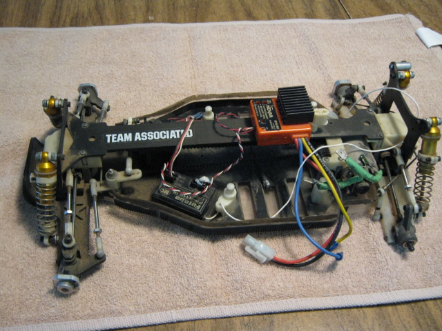

This will be my 1st Yokomo restoration. Can anyone help identify what model/year this car is. Also it looks pretty complete but I am thinking it requires some battery hold down pieces, am I correct?

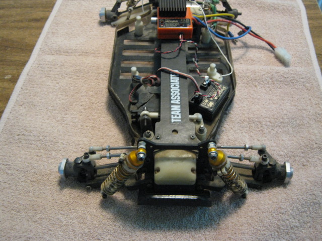

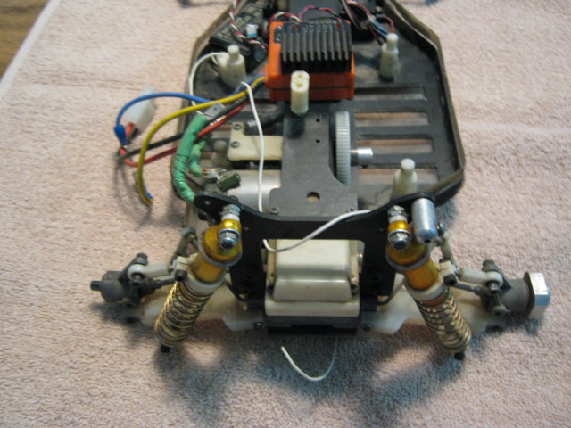

it's a 870c from 1988 with some hopup parts: Jammin top deck, unknown (for me) white rear arms, titanuim Lunsford or RCPS links (they looks the same), AE shocks, one way spur adapter & a good spur gear and finally "correctly" mounted rear wing mounts. It surely has been a race car with some "better than average" racer with those mods and electronoics that is has. You really have a nice car there!

But if u look at the 870 manual the wing mounts are actually mounted the wrong way around. On the Early 870 you mount them on the inside if the shock tower and the wing wire curls around to the rear then u mount the wing. This setup changed in later models but really its no biggy, only if you want to replicate the original.

I do meant that the wing mounts are installed behind rear shock tower not front of it so that wing wires do not have to turn about 179 degrees.

Oh and before i forget and to save you ALOT of time...try using a dremel with a soft disc wire brush to get the grime off your magnesium parts...i do it and they come up like new...! Very shiny and without the hard work...bit dusty so i'd wear a face mask.
I think they are are RC10 gold shocks? I could be mistaken?

Hey Jirka, yeah true i was just highlighting if it was to be a rebuild like the original was all. I only have one of my YZ's like the original wing mount setup as your right coming out the rear looks better especially with newer wings.

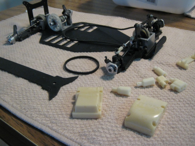

Thank you to all. That is some great information and that's what I like most about this forum. I have started taking the car apart and I think it will clean up real nice. I will post progress pics in a couple of days.

I have made some progress on this restoration. Does anyone know if the peroxide/UV works on Yokomo parts?

Certainly does! I will put a before and after shot when i get on my lappy. In the sun in a clear glass jar works the best..some bits seem to work better then others although yours look ok already?
Re: My first Yokomo restoration
The peroxide works great.. I put multiple parts in a glass jar and set it in the sun for two days.. I was a bit worried to leave the part in the jar over night so i pulled them out at night and rinsed them them stuck them back in the jar when I got up.. the parts were fine and a nice clean white color..

Those rear arms look like they might be delrin. The only place/company I know of that has done delrin arms is Dynotech Racing, although I was never aware of them making arms for the 870c. They did arms for the Works YZ10 and the '94 for sure, though...
Your missing battery straps are part number ZC119. They are extremely hard to find, and I myself have been looking for an original set for my '91 Works restoration. I have so far managed to find some JG Racing lightweight battery straps (link: http://www.johnshobbiesandcrafts.com/index.php?route=product/product&product_id=1561). There are still a few in stock if you would like to go that route. Or you can cut your own from a carbon fiber or G10 plate, which is what I did for my 870 runner.
A word of caution about the rear shock tower. I have my shocks mounted on the outermost hole, which leaves the inner holes empty. This is a structural weak spot on these towers and I ended up breaking one on a bad landing. You can of course order as many repro spares as you want from Fibre-Lyte, but regardless, if you know for sure which hole you want to use and do not intend on changing that, and if you intend on running this one, then I'd recommend filling the other two holes with epoxy to strengthen the tower. Not aesthetically pleasing, but it gets the job done.
Indeed you do seem to have a very nice example here. Well done! If you're looking for some pointers, I made a posting with a list of my 870c youtube videos --> http://www.rc10talk.com/viewtopic.php?f=29&t=33915

I replaced the rear arms with correct Yokomo arms but yes the white ones appear to be delron and I have not seen them before either. Thank you for the heads up on the shock towers, I had not decided how to run the shock placement so I appreciate your comments. I have another 870 that I plan on restoring just as a shelf queen.
Yokomo did make white arms for the 870C (ZC-407C). I have a set on my original 870. They are molded and look just like the black arms. There is a set on Ebay now, i have heard that they were developed for cold weather and less prone to breakage than the black arms (there was a thread on this site with that info). The arms that are made by Dynotech are made of nylon, the only delrin arms I have ever seen were the ones for the dukemo, but there are alot of one off pieces out there.
