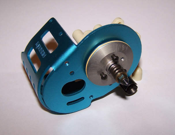

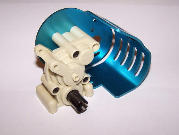

When I first saw the transmission at the hobby show, it looked like a step backwards. It's basically a bad version of the LRM losi trans. The losi units were great if built correctly...especially when using a slipper.
The SST used bad materials and I think the pitch was too small for off road racing. The plastic diffs were easily melted if not built correctly. The sport versions used softer aluminum in the lower gears which deteriorated over time. They should have use a hardened top gear...instead of a soft steel.
The design of the car was really nice, but the trans looks better on the shelf rather than on the track:

BTW, the gear ratio on the truck was different and it used larger diff rings.

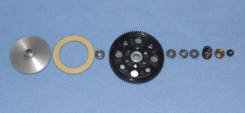

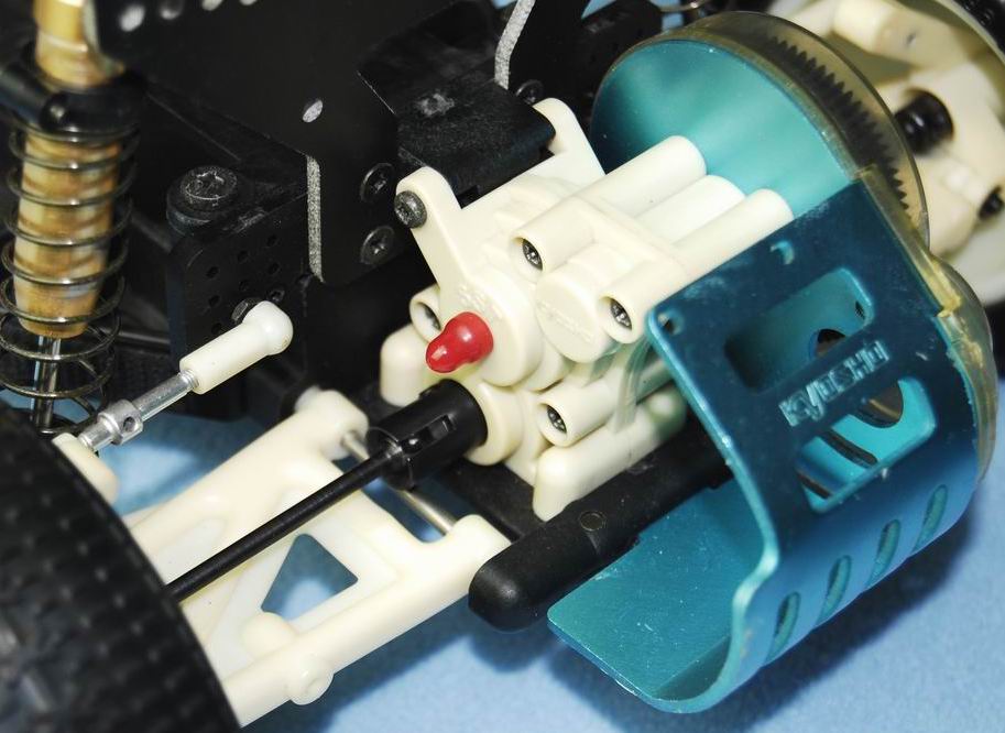

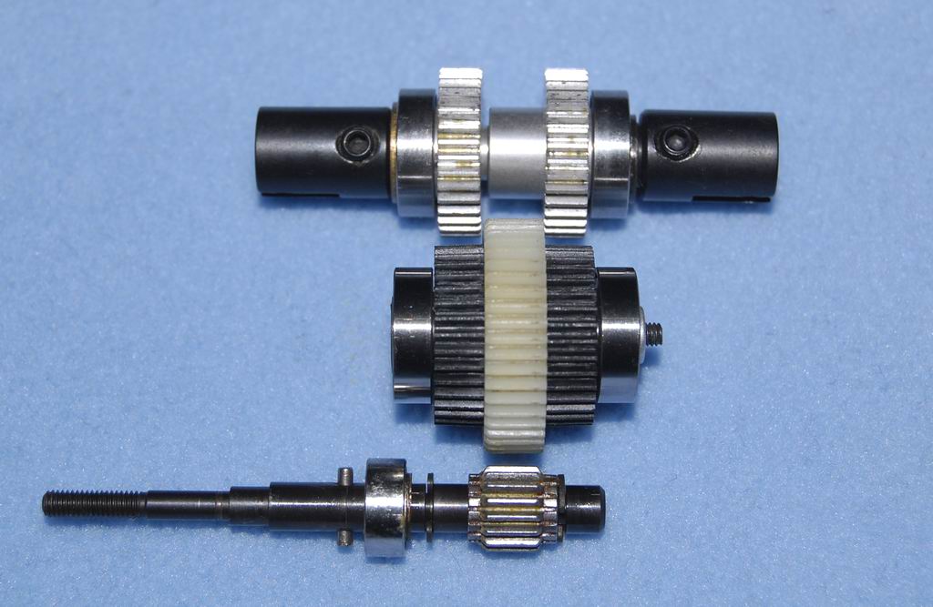

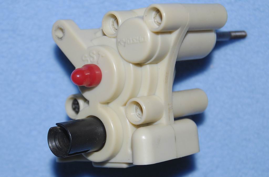

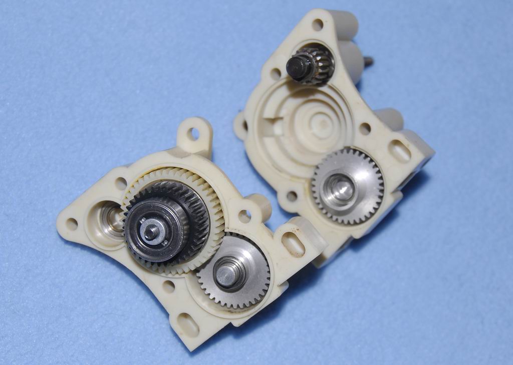

I always love the trans, it look awesome not the performance. I ever take some pictures for restore the trans

I remember at the 1993 worlds standing with a very famous company owner discussing the Kyosho car (it was relatively new at the time). We chuckled as he commented that they (not Kyosho) had learned that a tranny layout like that one wasn't any good years ago. He couldn't believe that Kyosho was releasing the car with that tranny (also implying that their (not Kyosho) design was being copied.)
