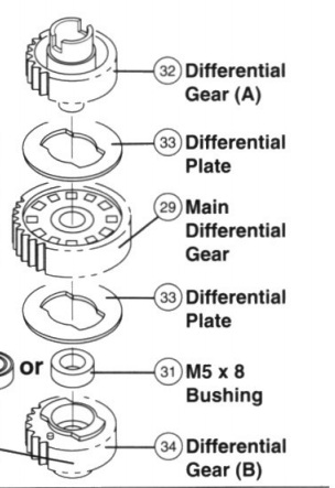

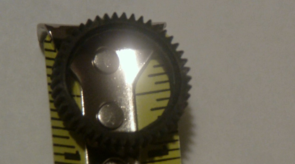

Hello, I am new to this forum. Currently I am trying to fix my kyosho pro-xrt I noticed the main differential gear of the stealth styled transmission has overheated to the point where the inner plastic of the gear melted no longer allowing the truck to drive. For those familiar with this tranny it is the middle gear sandwhiched between two other differential gears. My question is this, is there a gear on another model rc that I can use to replace this damaged gear? Or is there another stealth transmission from a different model vehicle that I can mount to the chasis say some sort of rc10gt tranny?

Yes tooth count is 45, diameter just under 1'' as shown in picture. I have attatched actual photo and manual photo(part#29)

Associated Stealth (2.25) is a 45t also, maybe one can be modded to fit with that metric Kyosho stuff. It'll depend on the size of that middle bearing I think...

kyosho usually uses metric .4 mod gears, not 48pitch, they fit close, but not exact, if it doesnt mesh perfect, it will strip

Joe, I've got parts for that same transmission, it's called the Super Sprint Transmission, or SST for short. The kyosho part numbers all start with sst and then a 2 digit number. Check out Ebay and search for "kyosho sst" and you'll find what you're looking for, there's a whack of parts on there. I'd just send you the parts myself but I'm in Germany, it'll take a while for them to get there. If you strike out with Ebay, I'll be glad to help out though, just let me know.

"H" denotes hard, basically saying that it is a harder plastic than stock. I just checked my stock of gears Joe, I've got what you need in case you don't find it state-side. Just let me know.

SST-005 is the diff gears for the XRT

Those are the gears for the Rampage Pro Nitro stadium truck, it had a different internal ratio.
