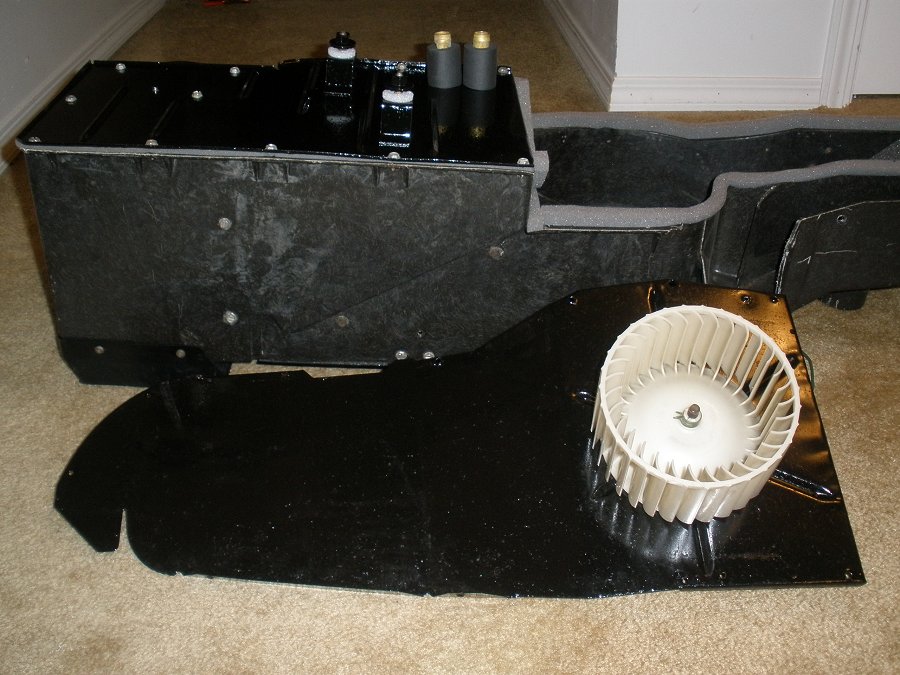

That's definitely tacky stuff, I used it when restoring my Charger's heater box, you use it to glue all the foams & gaskets to the metal (painted steel in this case). It really works well for spongy, foamy stuff, but not sure how it would work for vinyl stickers, but it might be worth a try.retrorobot wrote:I heard there is 3M spray adhesive that some people have used to make stickers sticky again.
