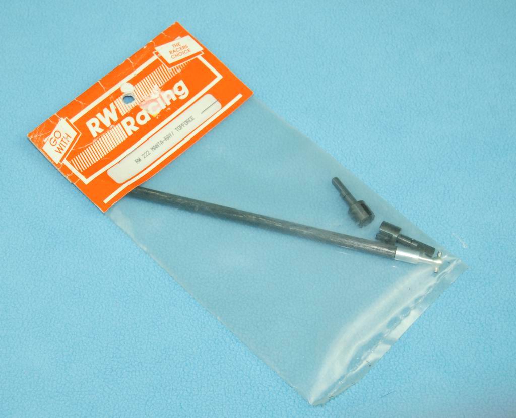

Re: How many types of tamiya TA02 FF01 chassis
RW racing in UK made a ta01 frp chassis set. I think it would work for ta02ff as well.
Nope, unless you want a different wheelbase. You'd have to change the rear arms too.rccars4sal wrote:RW racing in UK made a ta01 frp chassis set. I think it would work for ta02ff as well.

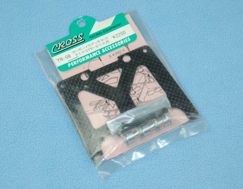

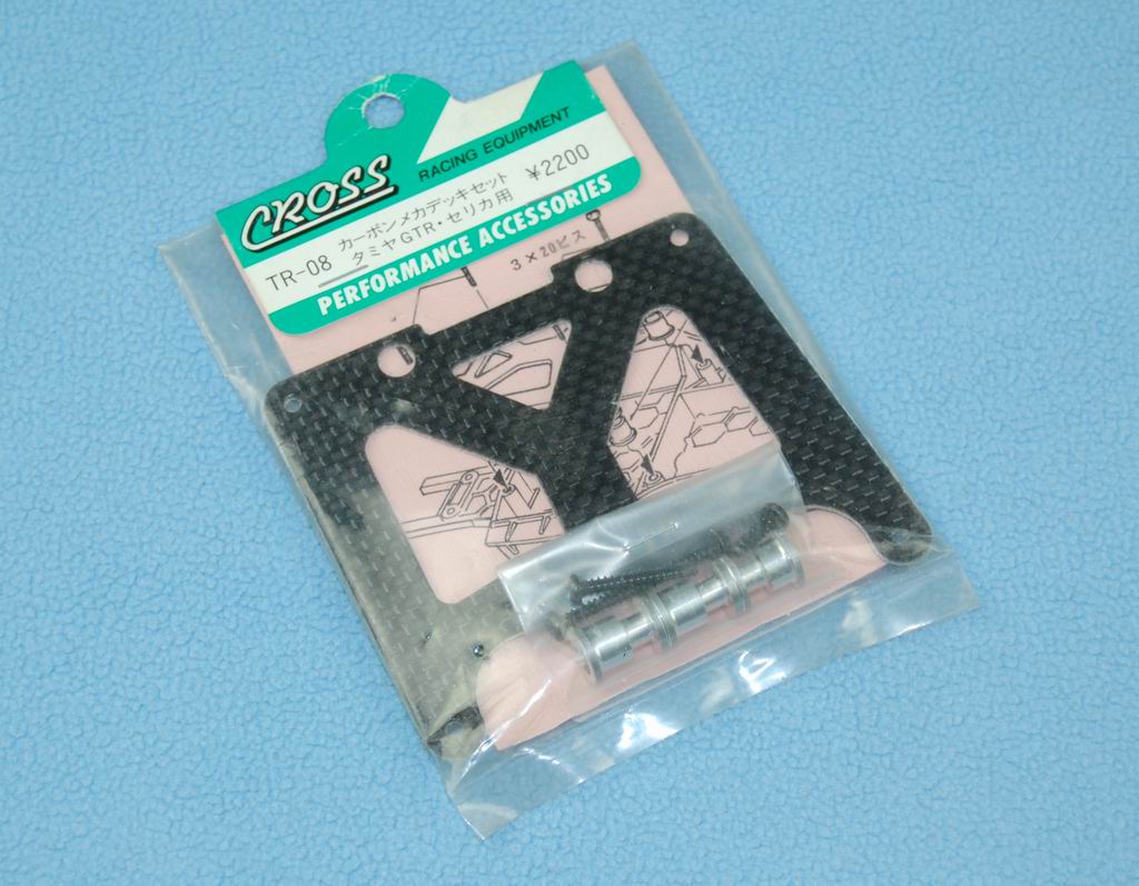

Cross:
- Carbon top deck for original tub (TA01/TA02/FF01)
- Carbon top deck for original tub (FF01, also has quick release battery mount)

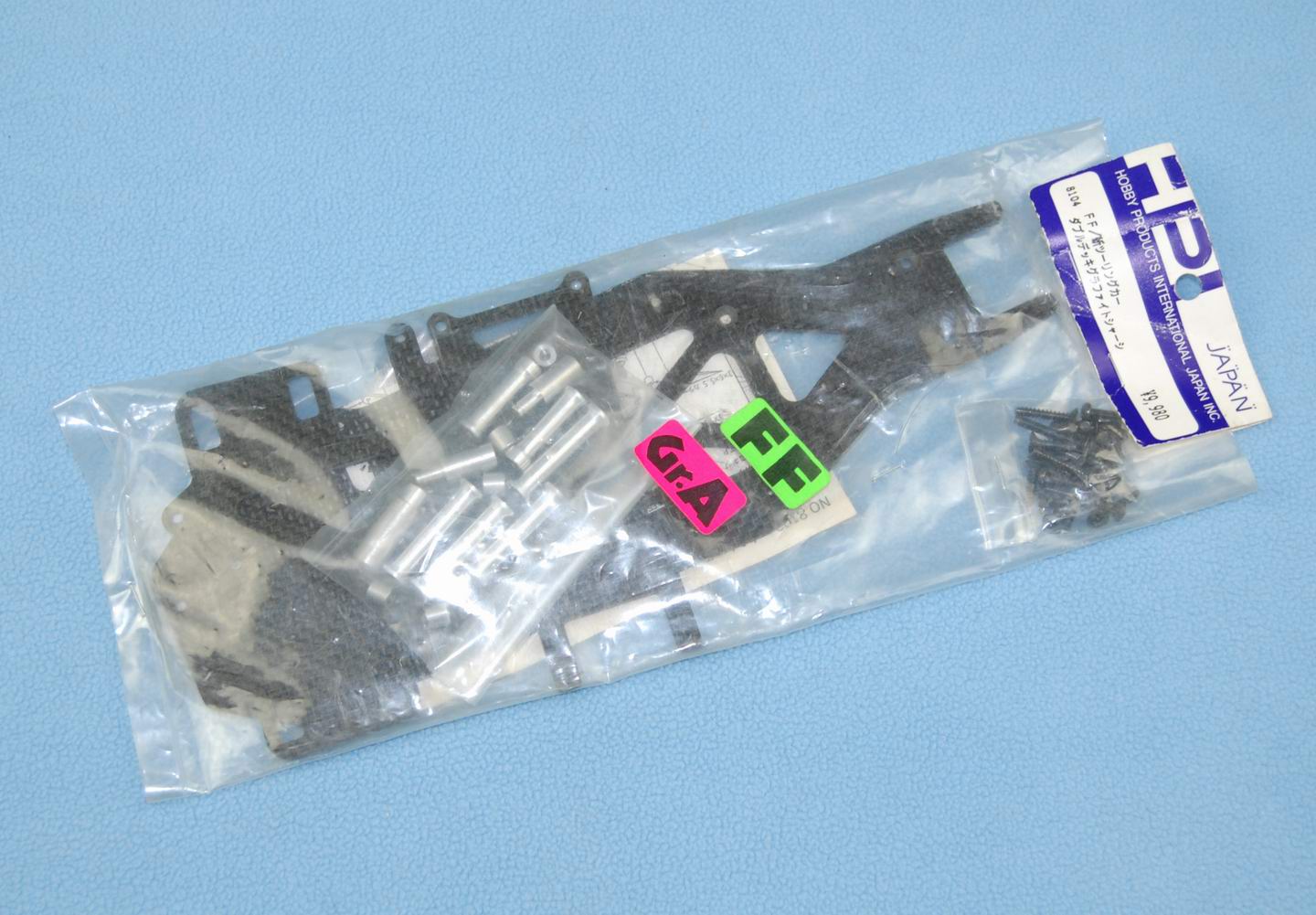

HPI:
- FRP chassis set (TA02)
- Carbon chassis set (TA02)
- Molded composite chassis (lengthwise battery, TA02)
True, but any ta01 chassis will bolt up to ta02 even if it changes length,, so perhaps not intended to be specific for that car, the rw racing chassis should be a direct bolt on.

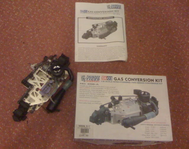

Thunder Tiger gas conversion kit chassis also fits in.

Cross:
HPI:

I have 53166 FRP chassis,it is very nice. and the HPI produtions are in very high quality,the molded chassis is best balance of the weight for racing

I like that hpi molded chassis. Would be perfect for a rally build.
You'll need to change the drive shaft. TA02 is too short for TA-01 chassis.rccars4sal wrote:True, but any ta01 chassis will bolt up to ta02 even if it changes length,, so perhaps not intended to be specific for that car, the rw racing chassis should be a direct bolt on.

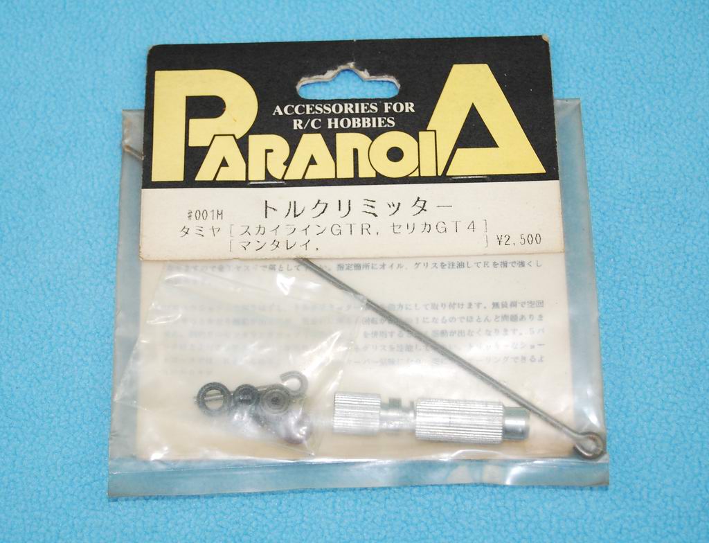

Ta01 ta02 df01 is very fun and interesting chassis. So many options and aftermarket parts for it. Like the propeller drive shaft. I found not less than 10 types of them. Tamiya stock shaft is weak, stainless hard drive shaft is better. Many others like carbon propeller, torque clutch, they are very special. Tamiya still released the ta01 02 stock plastic parts for like 20 years, very popular and will affect us for a long time.

Tamiya just released the steel propellar shaft for the ta01 02(short type), but many some after market special produtions are better designs,my collections just for ta01 LWB.

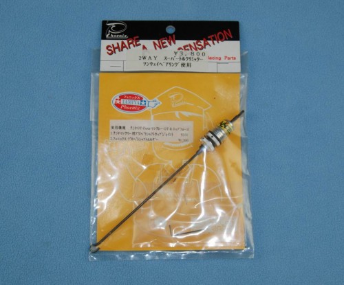

I like that phoenix top shaft. Is it a clutch or 1 way?
- Posts: 361
- Joined: Wed Nov 12, 2008 9:03 pm
- Location: China
It is a clutch set, also have the Hotshot center drive clutch released.rccars4sal wrote:I like that phoenix top shaft. Is it a clutch or 1 way?
