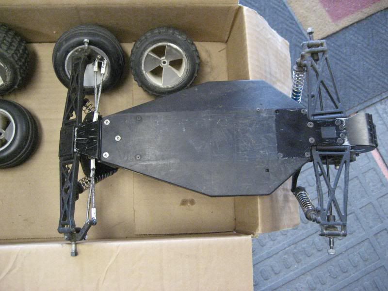

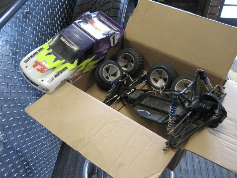

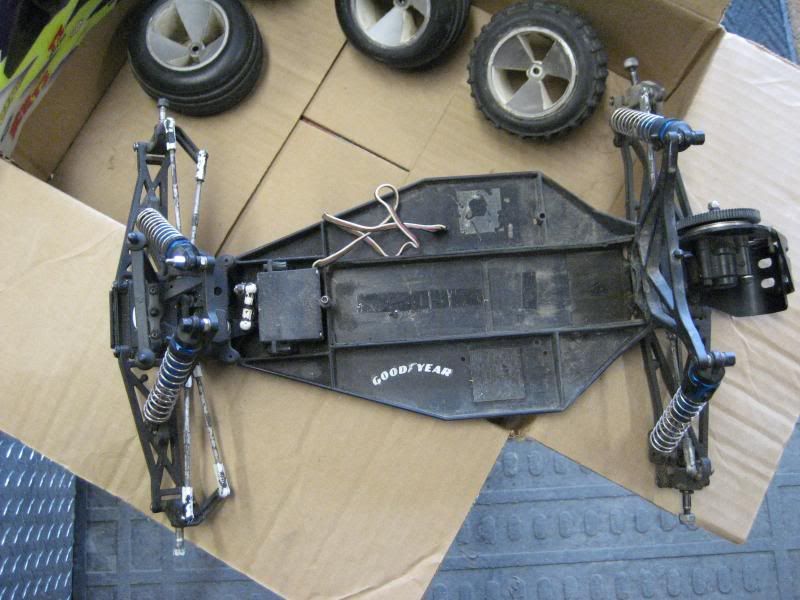

just picked up a rc10t3 roller off Kijiji for 60 shipped and am looking into puting it on the track
any thing i should watch out for or any upgrades that it might need

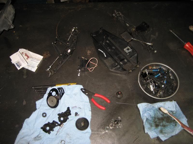

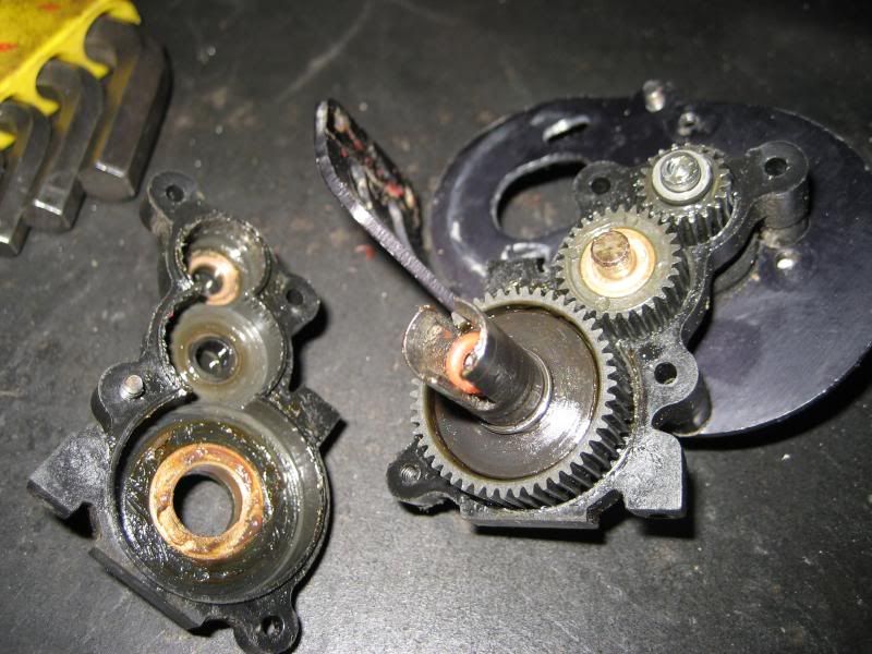

i tore it down today and found the front upper brace cracked, rear axel bearings blown and bushings in the tranty but all in all good shape so i stoped at the hobby store and picked up all the bearings it needed and ordered the upper plate
going to rebuild the shocks and the upper plate should be in fri .. if i can ill have it ready for sundays race

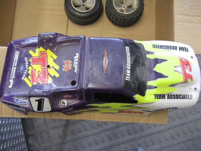

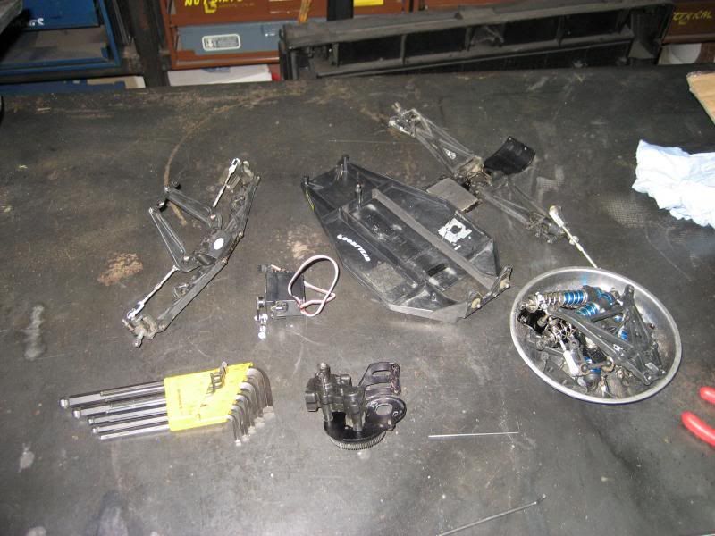

so here is some more picts i took last night

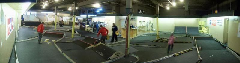

and this is the track i want to take it too .. they just added a wall ride
https://www.facebook.com/photo.php?v=10153941008650529&set=o.101246906660471&type=2&theater

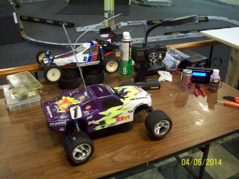

had a good time on the weekend with the rc10t3 .. quaified 2nd and finished 3rd .. not bad for a 14 year old truck with a brushed system racing short course trucks with brushless
the track is realy tight so they couldnt use their power

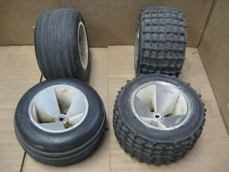

Striker tires are AWESOME on carpet, it's a shame proline discontinued them.
We used to use Paragon FXII. Sometimes I would sauce them the night before, wrap them in glad wrap and store them in a plastic bag untill race time. I also siped them like a dirt oval tire for more forward drive.
