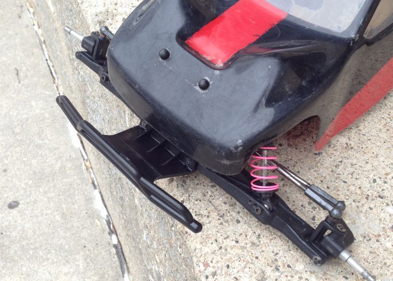

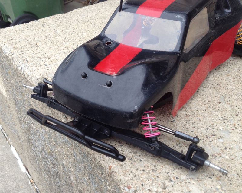

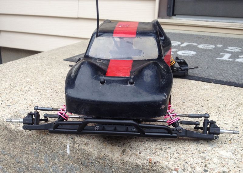

Using some of the company money, I decided to test another type of Evader bumper (DTXC6867) on an XXT.
It is more of a Short Course style bumper.

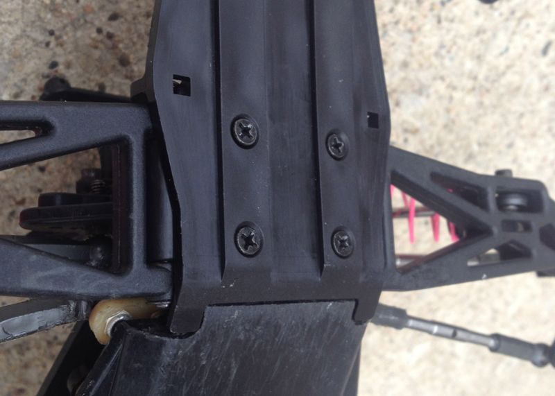

It fits pretty painlessly, goes on like a combination of bumper and front brace. So that means you need the longer CR length front hinge pins. (A2007)
So if you are looking for an odd bumper to add a different look to the XXT, there you go. I might put these in the store at some point, but I would mod them so they fit a little better first. I think the DTXC6879 would work the same if you liked that look better.
The screws are little hard to tell, but they went in at kind of an angle. The bumper needs to probably have a little material removed right next to the spot that meets the nose of the bulkhead. This would give a better fit. Wouldn't take much.
See the pictures below.
