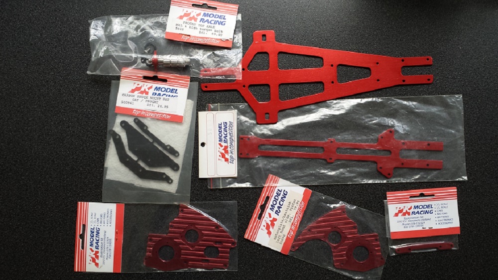

Also posting a picture of some PK parts. Chassis plates are XL/XLS and the motorplates are Procat with the lower hole.
SWB and XL: only upper hole
XLS: both holes
Procat: only lower hole
That makes one hole difference between the different models. In my world your machined option plate above is XLS, not Procat.

Now that's a stash of very nice parts you have there. So I'm now to the thinking that i have acquired a home made copy of some sort but would it be useable to build a xls hybrid ?
