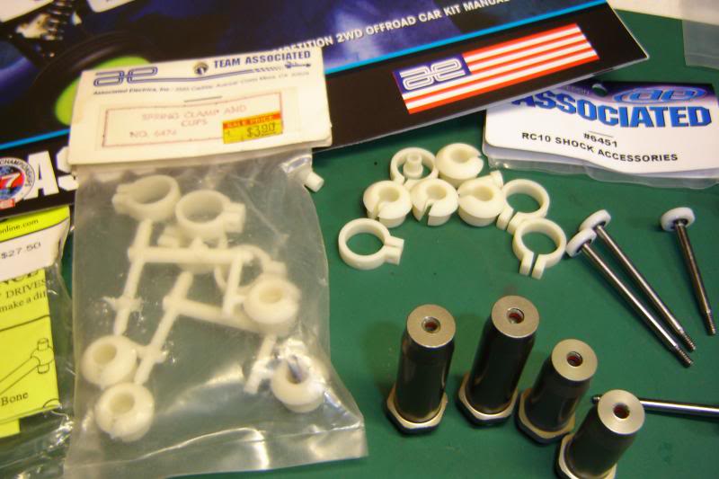

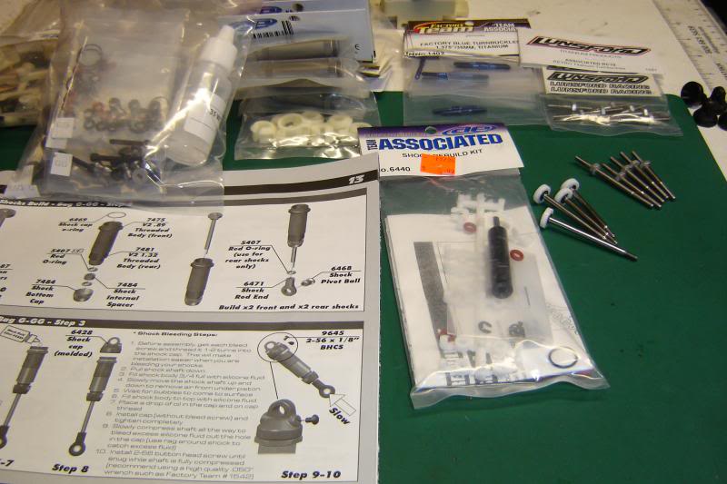

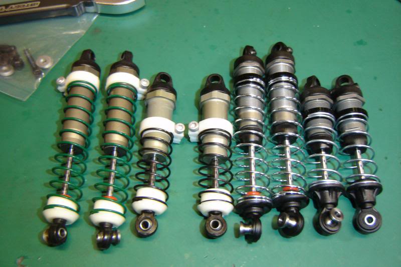

First off the shocks. I had the correct rear bodies but wrong longer front B2/B3 bodies. I hope to find correct .71 bodies soon but will build anyway!

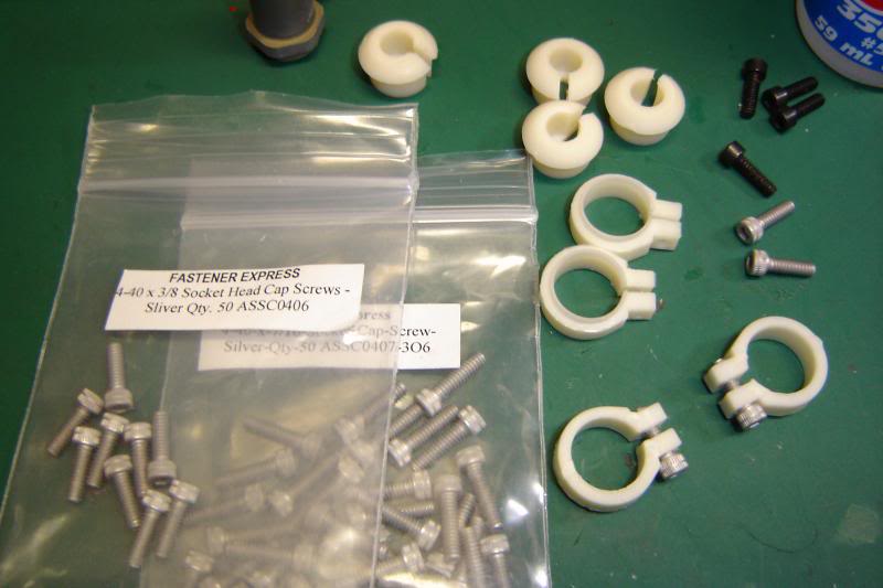

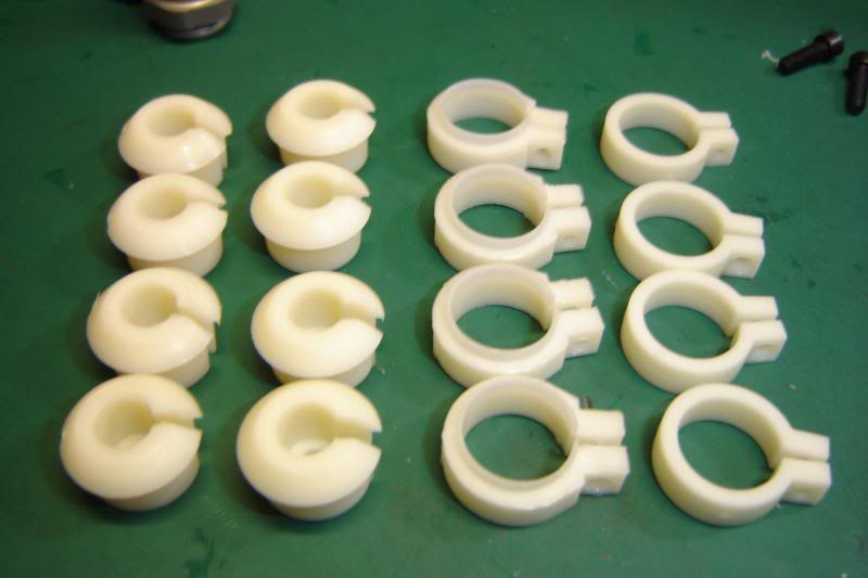

Was going to use RC10 Classic white shock parts but they did not look correct, so I used some originals! Of course I had to use silver aluminium screws!

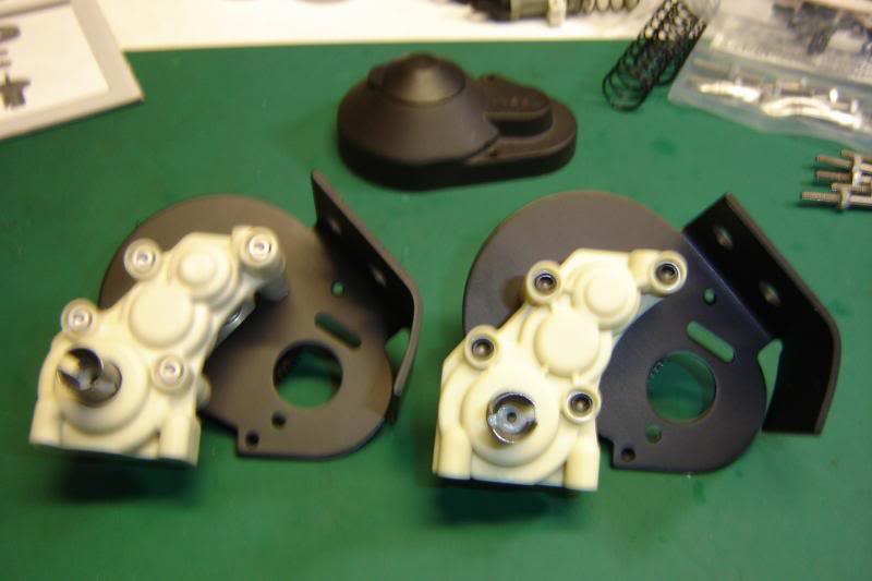

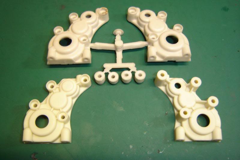

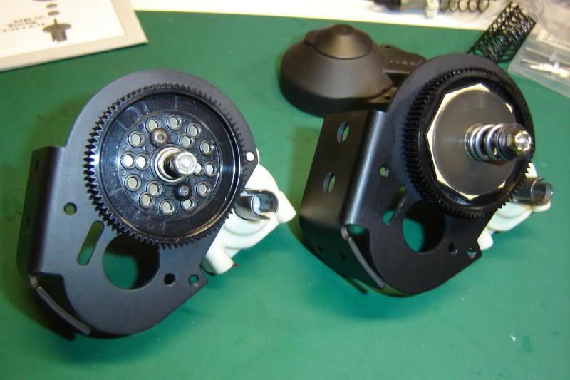

By now every one knows about the US and China Stealth transmissions, but I will post up some pictures anyway! US top, China bottom, seems fitting! Although I'm sure the US one is contaminated!
Sadly, the US cases are far from perfect!

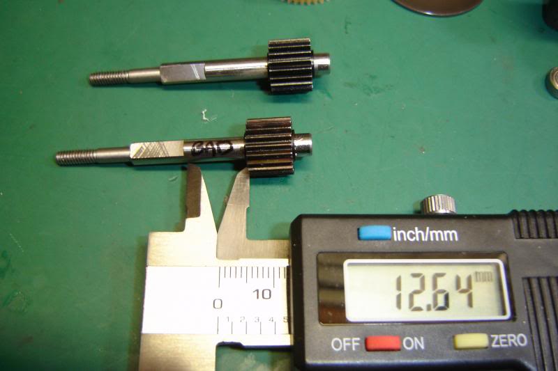

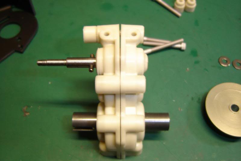

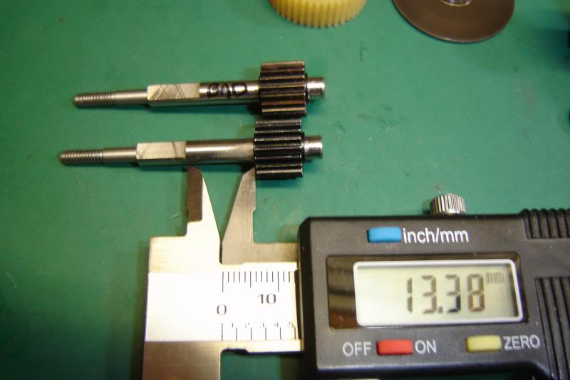

We all now know about the short poor fitting top shaft in the China Stealth. Well here are more pictures. Just use an old B4 top shaft and your China Stealth will be ok!

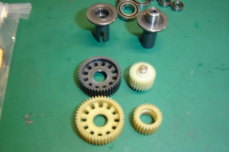

Changed over to the old slipper.

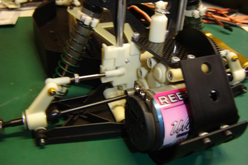

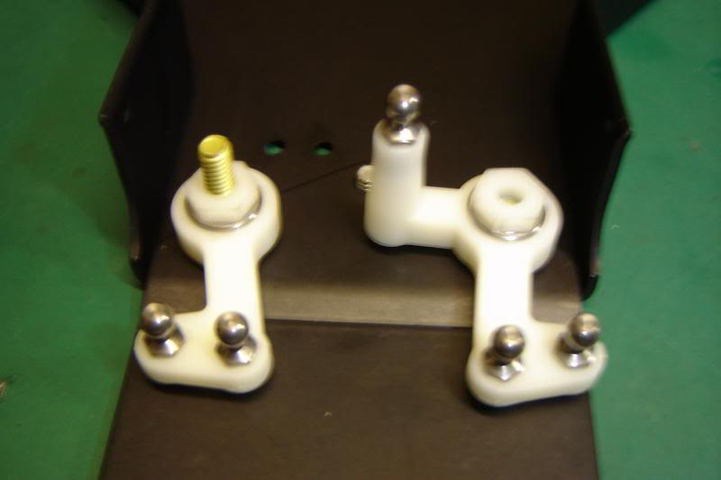

I added bearings to the steering. Silky smooth now, this is a must for a racer!

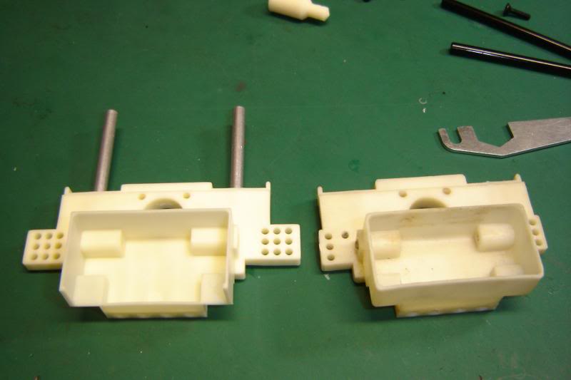

The bulk heads are very different, I need to have the short ears but I want my lipo's to fit! So I will shave the new ears off!

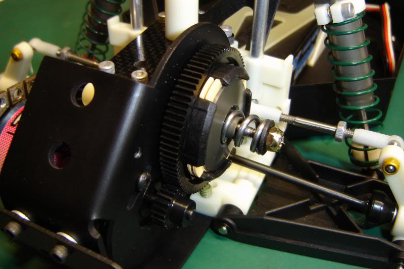

I had a rethink mid build! I'm racing this and want to be some what competitive! The shocks are no change in performance, but the slipper for sure! I would also like to run modern rubber and lipo batteries! So I decided to keep the new rear bulkhead (with mods) and the front and rear axle, and rear upright with CVA's! I used vintage titanium RCPS/Lunsford turn buckles that I had kicking around but was short one 2 inch on the front steering!
Oh well!

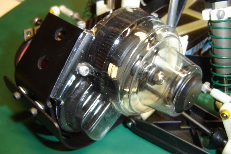

Switched to the VTS slipper but the "NEW" slipper cover was not designed with this in mind!
What were you thinking AE? You make a totally new gear cover not to fit your VTS! ???
So I fixed it with a vintage Losi product!

+1! Looks great!marlo wrote:Looking great, I like the shocks better with the "vintage" clamps, and green/black spring set up. The "out of the box way", just looks to cheap!

Love the thinking behind this.. I agree on the shocks looking cheaper than the old shocks.. like the easy adjustability of the new ones though.. I too switched in bearings for my steering as my only upgrade so far.. best upgrade to the car and a must have IMO.. the bushings were way too tight out of the box..
