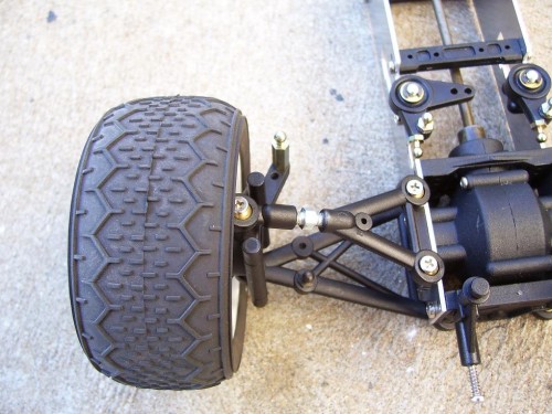

Re: SG Coyote wheel options
Here you go Wazza. Use Associated wheels 6805w or 6805y. The hole in the wheel is 3/16" (4.7625mm).
Ream the hole to 5mm. The axle setup is almost stock. Take a small amount of material off the ends of the 2mm crosspin.
Use a 5mm ID washer on the outside of the wheel as a small portion of axle is visible without it.
There's also plenty of clearance for the steering balljoint. I tried B4 wheels but they don't have enough offset for steering clearance.
Using these on the front might give you too much steering though if you're running it as a 2WD.
Chris.
Thanks Chris, that is excellent!
I will cut the inside bead off the front wheels and then fit 4WD fronts so they are a little narrower. I used to do that to make 22mm rims out of 26mm touring car rims years ago and provided you glued the tyre on well it worked great.
Cheers,
Warren
Cheers,
Warren
