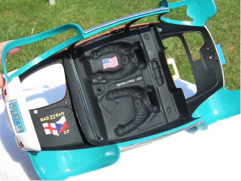

That's the body from the TamiyaClub community scorcher, the interior is a special made by Scollins (who happens to also be a member here) check out the links I posted above for the story.dsmith wrote:the driver/ passenger is from a Toyota celica grb. Tamiya..pretty sure...

I can concur with Synergy, that is a scollins interior. I bought one way back in '07 and of course it's just sitting in a box for the right time to do up a scorcher body.

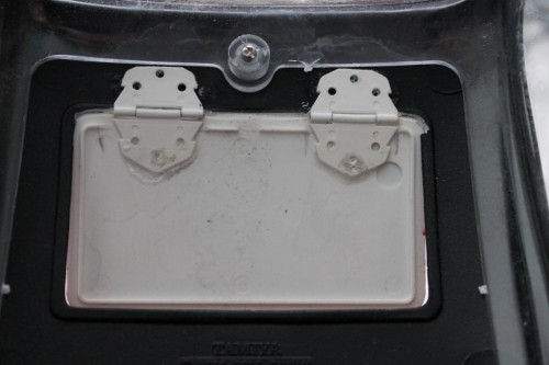

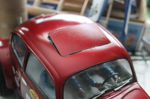

I used model airplane hinge's on my sun roof, so it opens and closes when ever I want.
